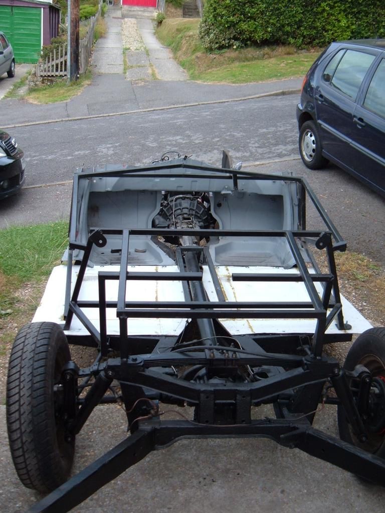

Rebuild of the carbs completed. Fuel tank fully bolted in and manifolds and carbs fitted. Hope to have a running engine by late spring.
Had a trial fit of body shell (at last).
Purchased a few goodies in Rimmers winter sale. Wood rimmed steering wheel and a pair of wing mirrors ...I know it's early days but .....I'll get there eventually. Meanwhile ... a couple of pictures.

Slarti - Engine looks good.
Maybe it is the angle of this photo, but is the floor pan pushing out the bottom of the body shell?
Either way, the whole point of test fitting things is to see what needs to be done.
So good luck, Paul.

As you say Paul, a trim back on the floorpans should do the trick; and MrT ... looking to get a running "moon-rover" by end of spring. This summer is a bit optimistic to be on the road ....but perhaps next spring/summer.
