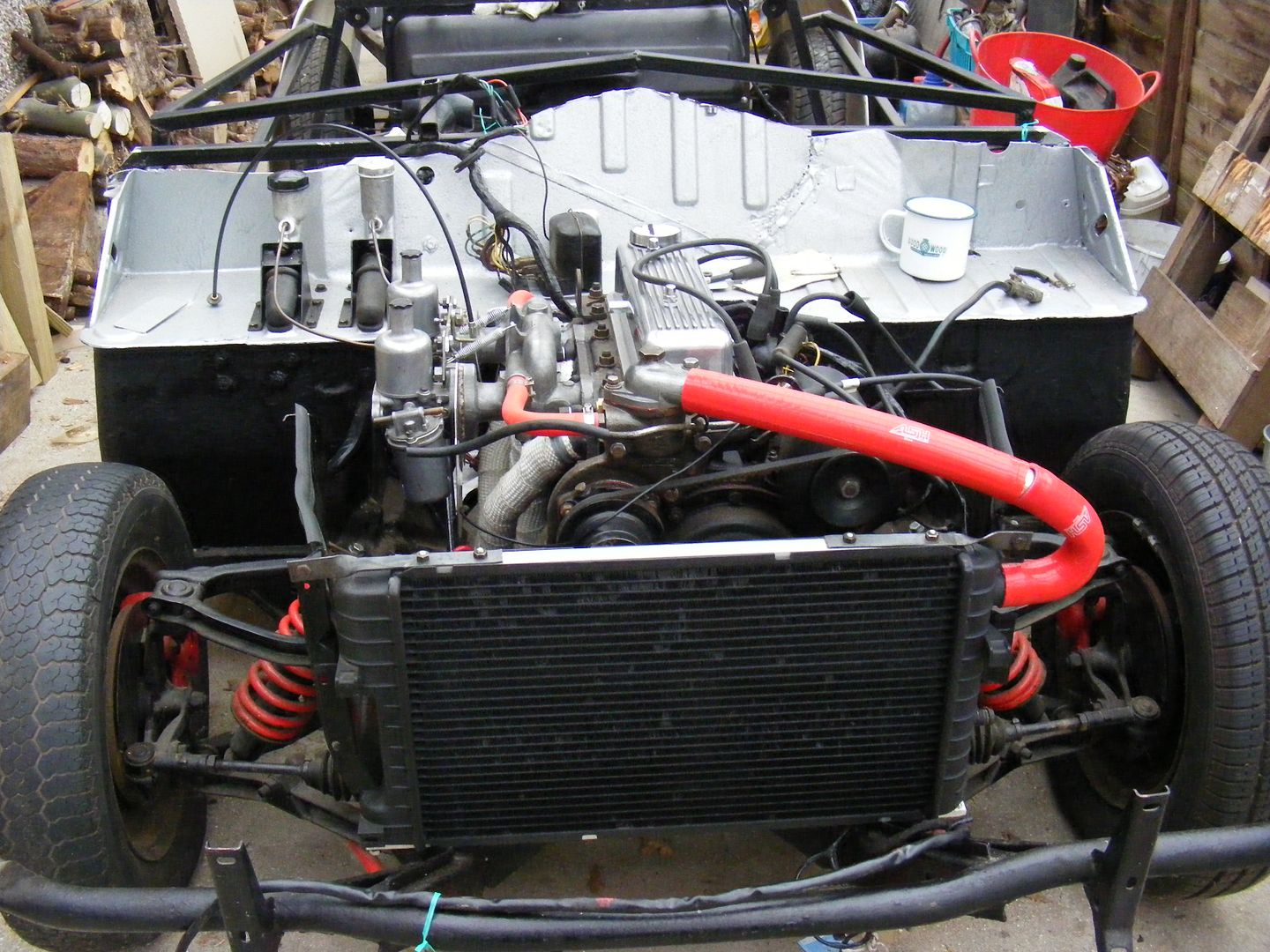

It's been a long time .....too long. So many other things that "her indoors" has wanted done. Anyhow....the rad is now installed & throttle cable connected. I've laid some of the wiring back in and hope to be able to at least start the engine (or attempt to !!) within the next few weeks. ....Where have we heard that before.

I can't believe that my last post was back in September !!! Then I was saying that it was only a matter of weeks before I had the engine started! Well now I have finally retired and more time to get on with the job of sorting out the Sammio. Today ...after a bit of tooth sucking I got the engine started and it runs very smoothly. Now I can seriously think about mounting the body and sorting out the steering and dash. Photos to follow ....I promise.

I'm now doing a bit of a trial fit of the body shell before bonding it to frame. Am I right in thinking that nothing actually lines up perfectly? I'm trying to get a true center line to work from but I'm finding that the cills don't line up too well with the chassis. Is it matter of getting as close as possible and then working round it to line up the bonnet. Any advice great fully received. Perhaps someone can direct me to the relevant part in a build.
On a positive note, the clutch and brake circuits seem to be working ok and I've checked some of the lighting circuits which again seem ok.

It's a hard one to explain on here , standing next to the car is the best way to run through it ...but , in summary , yes ...they aren't great in the lining up dept....
I usually start by centreing the rear wheels in the arches and setting the cill and bulkhead height as best you can ...use scissor jacks , stands , blocks or wood , whatever to get the height adjusted and lots of eyeing up as the tape measure will only frighten you ..so do it all by eye initially ...
The bulkhead has a handy lip on the bottom which makes it tricky to get that wrong ..so ..basically , set body at height in the bulkhead area ..centre the rear wheels ..one centre's better than the other ...when you have the first one centred , fix the bulkhead that side with a tech screw or similar ..then pull or adjust the other side to centre it and fix that side down on the bulkhead too ..this temporary fix will get you started .....
The bonnet can have many variables ...again wheel arch alignment is tricky ..but when you are happy with the body position and its fixed nicely ...then the easiest way is to fit the bonnet on the bulkhead line with a few tech screws again and raise and lower the front on a trolley jack until you are happy-ish .....One arch will fit nicely ..the other not so nice ...many people have left it alone , but its a fairly straightforward adjustment , if it bothers you ...
You will need to practice the art of ''some compromise'' and acceptance of symmetrical unimportance !!
Lots of people have done no adjustment ...some a bit ..others a lot .... great looking cars have come from all 3 camps ...

Thanks for that. It all makes sense and VERY helpful. Awaiting stud converters at the moment before fitting the wheels. Pictures to follow .....thanks again for your help & advice
