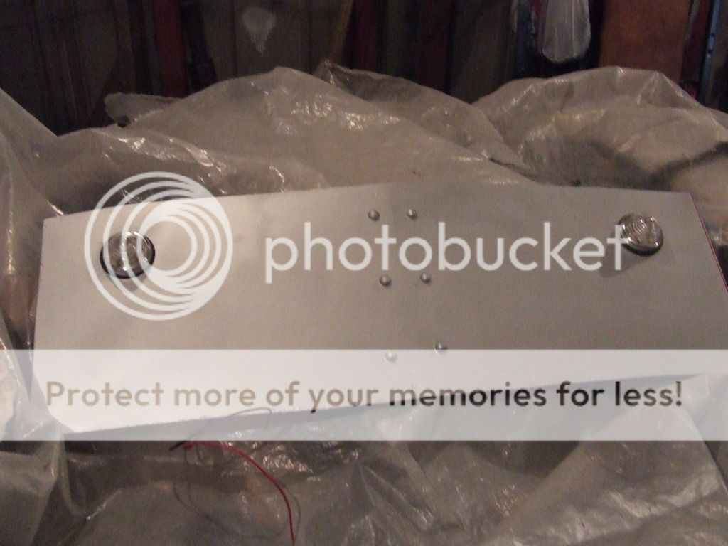

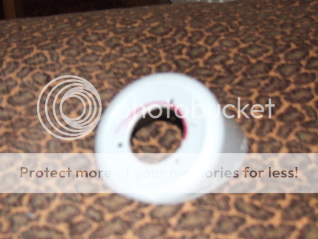

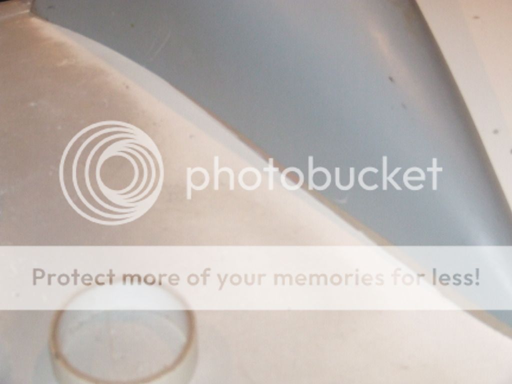

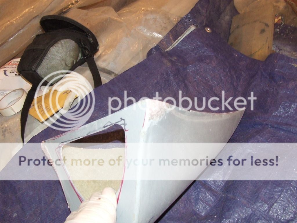

I have trimmed the indicator pods and drilled them out.
[IMG] [/IMG]
[IMG] [/IMG]
I then positioned them and taped them in place with masking tape and used glass fibre past to fix them in place sorry about the rubbish photos

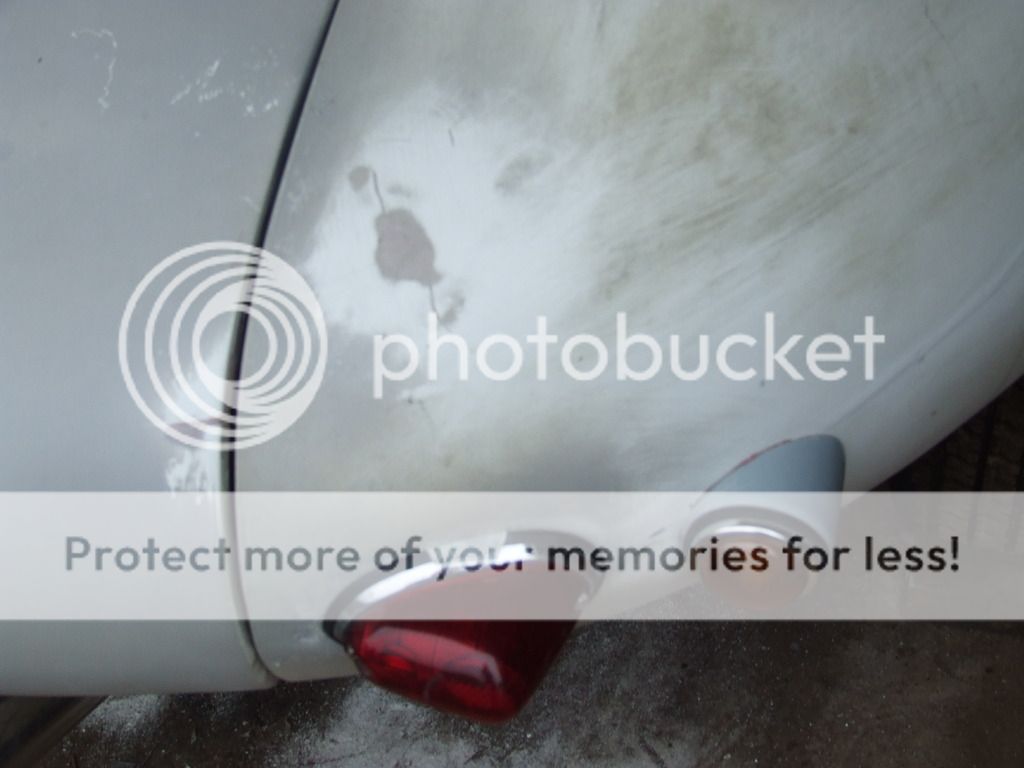

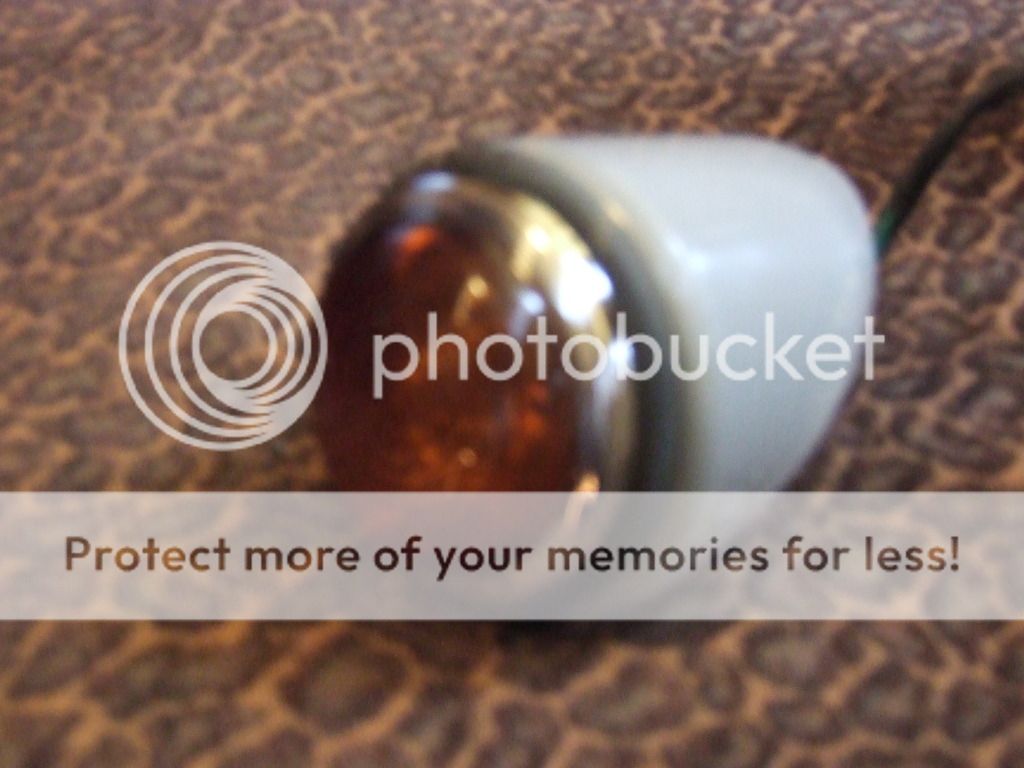

and they now look like this.

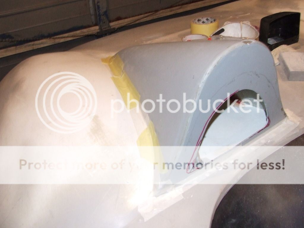

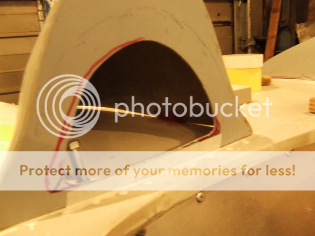

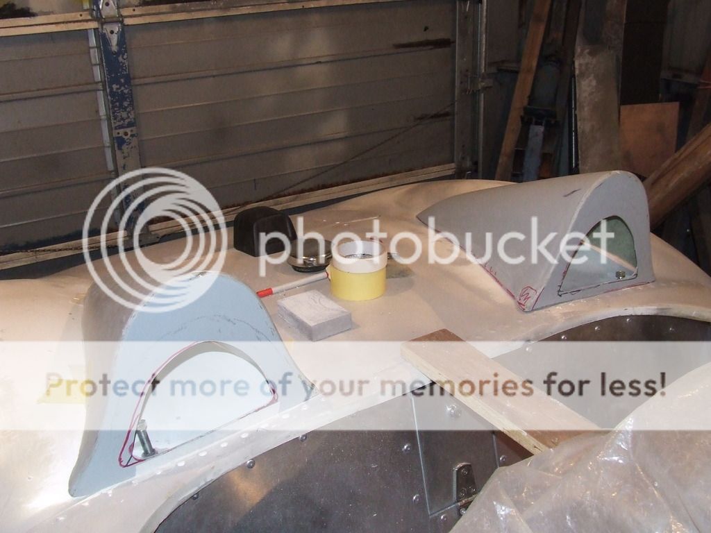

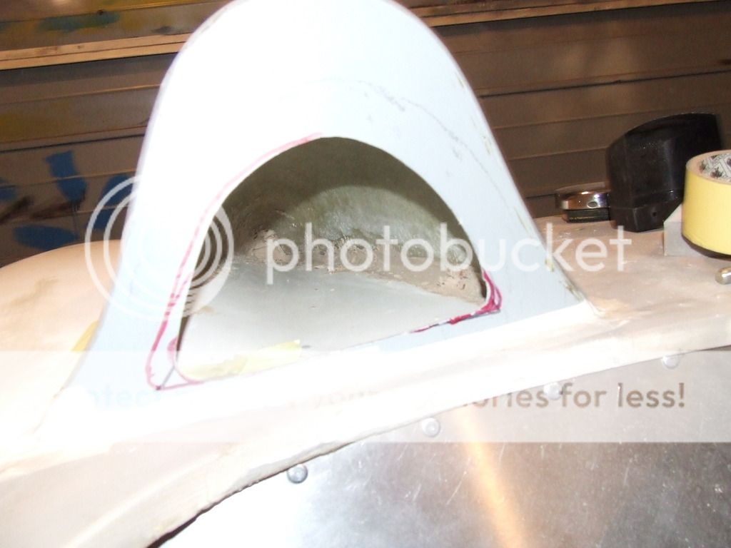

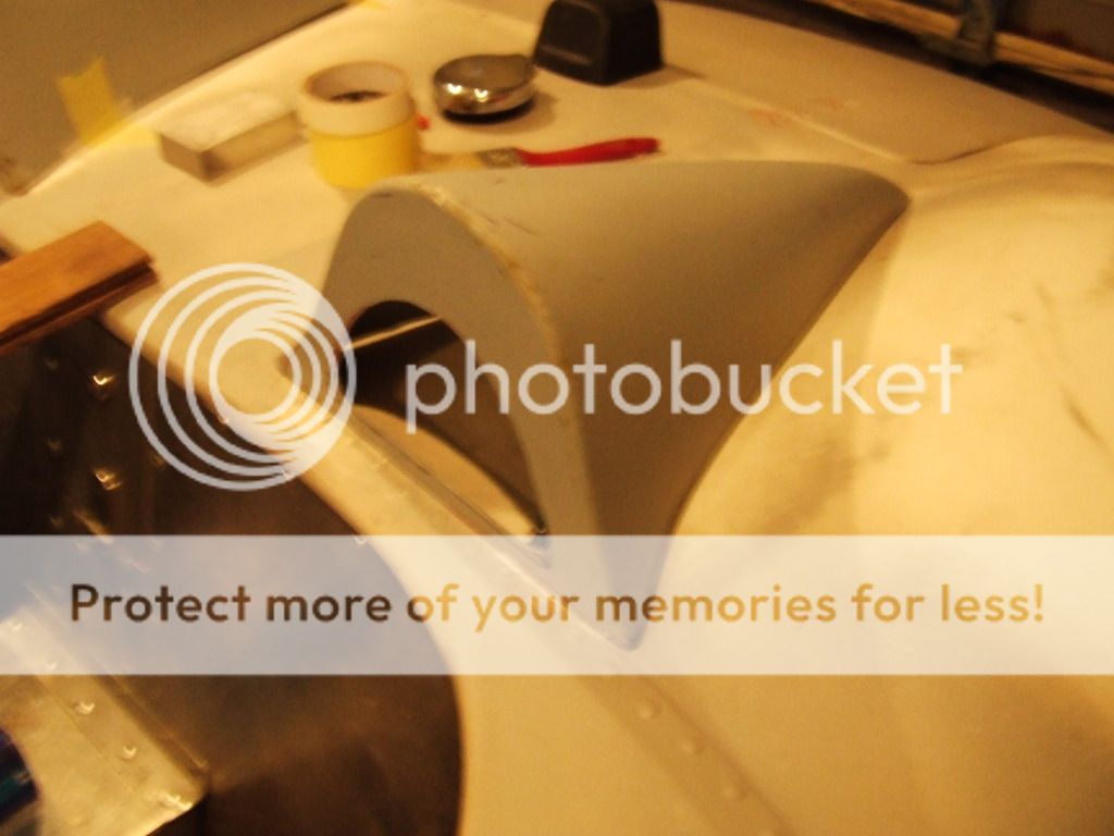

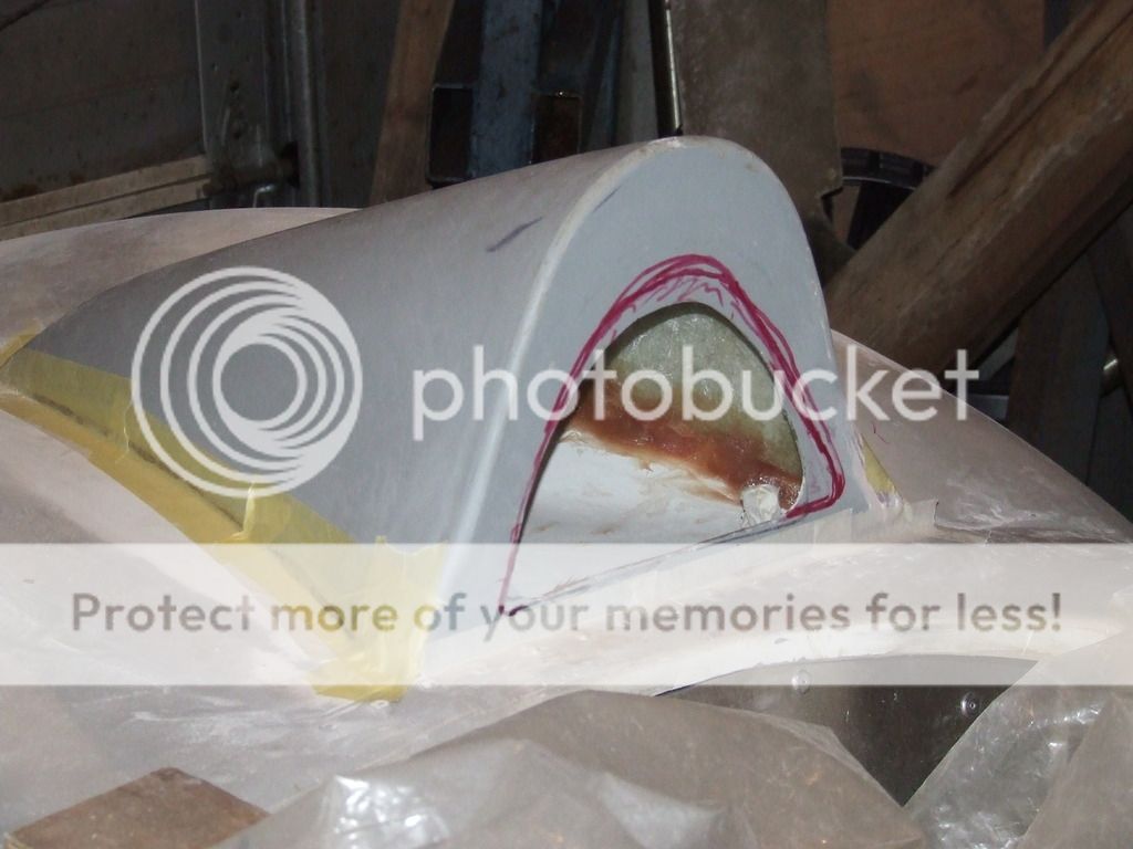

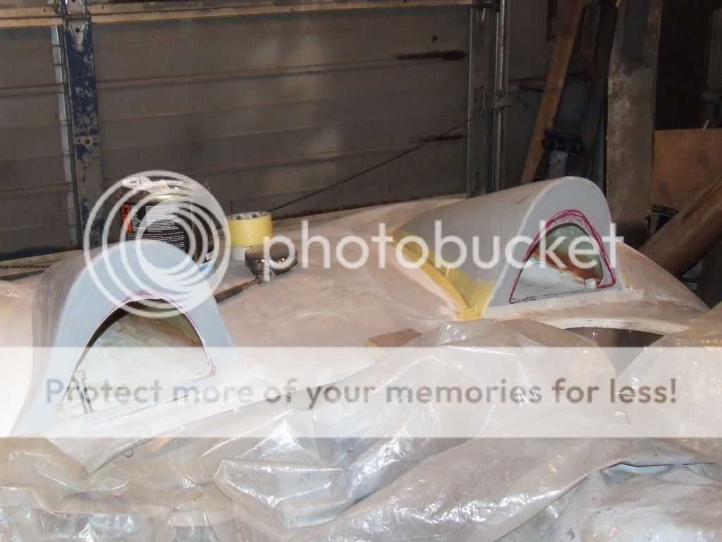

I started on the head fairings (ump's) today the drivers side should not be too difficult I have used small amounts of glass fibre paste to fix it too the body in the three places where it actually troche's the plan is then to fill it from the outside then glass fibre tape the inside, I didn't want the glass fibre pushing to the outside too difficult to sand too shape the ump's will also be used as storage space so I'll need a good finish on the inside.
[IMG] [/IMG]
[IMG] [/IMG]
[IMG] [/IMG]
the passenger side one is actually a drivers side one modified to fit ish and as you can see from the photos doesn't sit properly and slopes to the wrong side and will need major surgery (watch this space)
[IMG] [/IMG]
[IMG] [/IMG]
[IMG] [/IMG]
the bolts inside the ump's are for thee point harnesses and are in the right place believe it or not!

I taped over the join on the outside then filled from the inside this leaves a nice clean join with just a mall amount of filling and sanding
{IMG] [/IMG]
{IMG] [/IMG]
{IMG] [/IMG]
{IMG] [/IMG]
then I will sand the inside reinforce with woven glass fibre tape which it just so happens I have run out of so I sent for some today.
As Paul says the passenger side will be a little more difficult

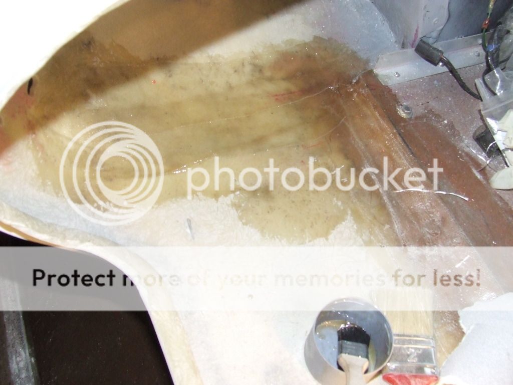

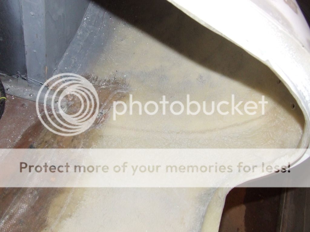

I have used woven glass fibre tape to reinforce the inside vaer messy as I couldn't see what I was doing doh!
[IMG] [/IMG]
[IMG] [/IMG]
The n/s hump needs a lot more work 1/2 chopped of this corner
[IMG] [/IMG]
and this one extended by about 3/4 and filled and shaped.
[IMG] [/IMG]
[IMG] [/IMG]
I also had too cut off about 1/2" off one side but not looking too bad now
[IMG] [/IMG]

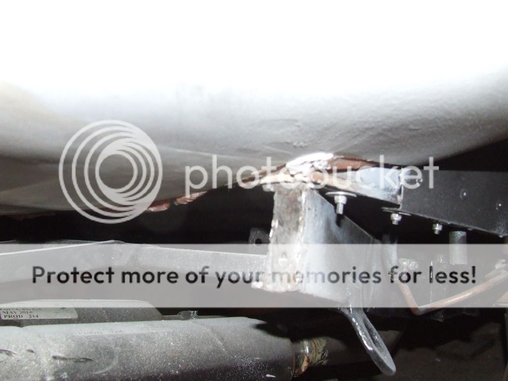

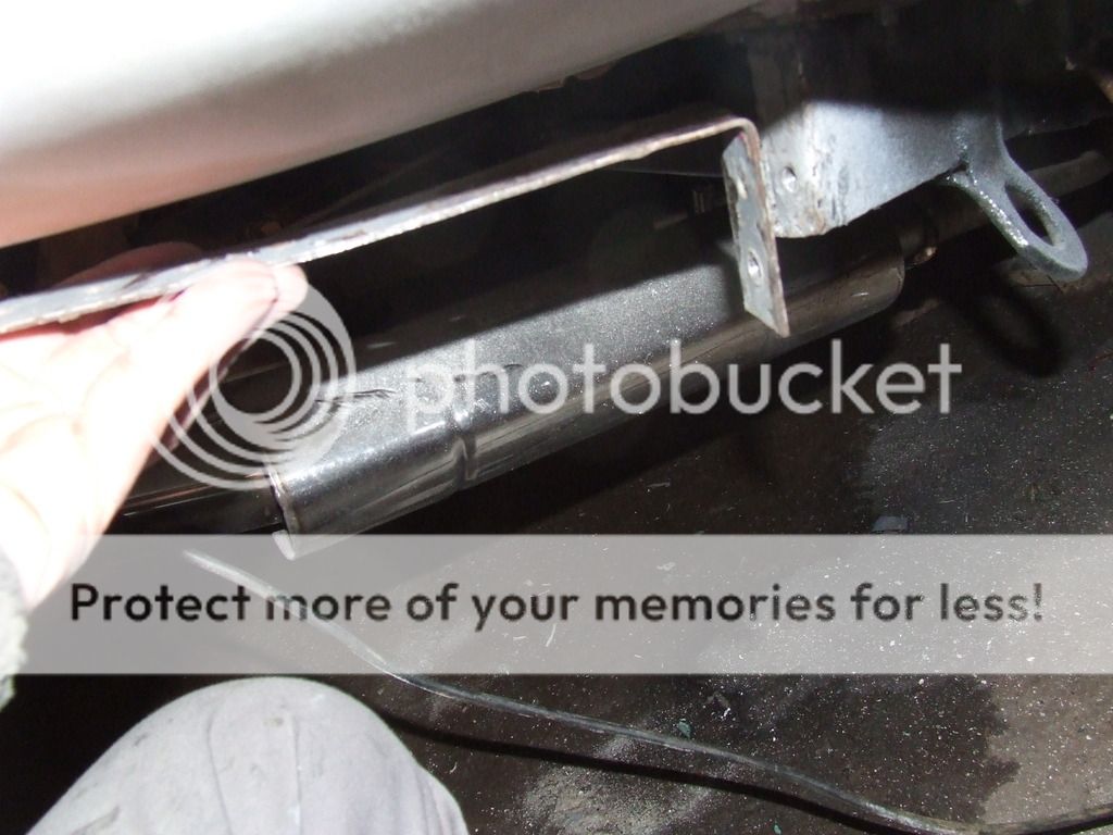

Whist the rear of the car is up on jacks (waiting for the brakes to be bled) I decided to start the mock up on the boot supports,
[IMG] [/IMG]
[IMG] [/IMG]
I noticed that the join line in the boot looked a little thin {probably just me )
so I decided too reinforce it with some glass tape.
[IMG] [/IMG]
[IMG] [/IMG]
[IMG] [/IMG]
[IMG] [/IMG]
looks a bit stronger now I'll carry on with the boot supports ASAp
