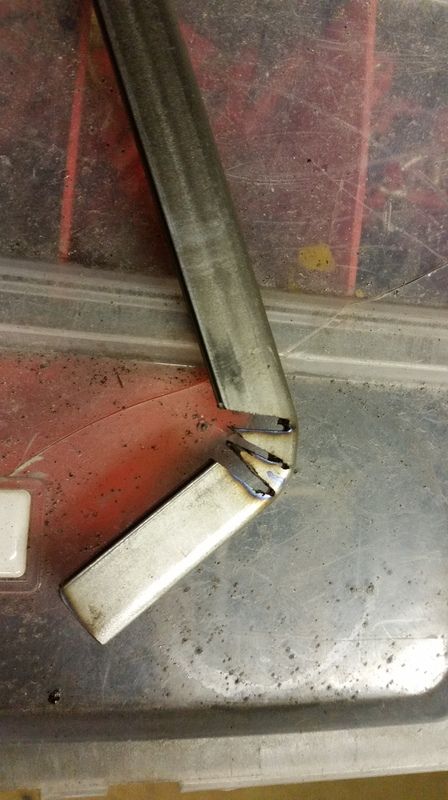

Starting with a length of thin U channel steel from my local metal works, I measured the length I needed and cut. I then made 3 V-shaped cuts where the bends needed to be. The angle grinder disc I used was too thick in hindsight, a junior hacksaw or thinner blade would have given a better bend.

The finished photo. Once it’s been through rain and road dirt it will look better...not so shiny. I learnt two things from this to improve the next one. 1. Make thinner cuts 2. Perhaps not cut out the grille hole and actually use the bolts to go through the fibreglass (as the vent is more for show than function). I would try and follow the curves of the bonnet more on the next one..it's a learning curve (forgive the pun).
