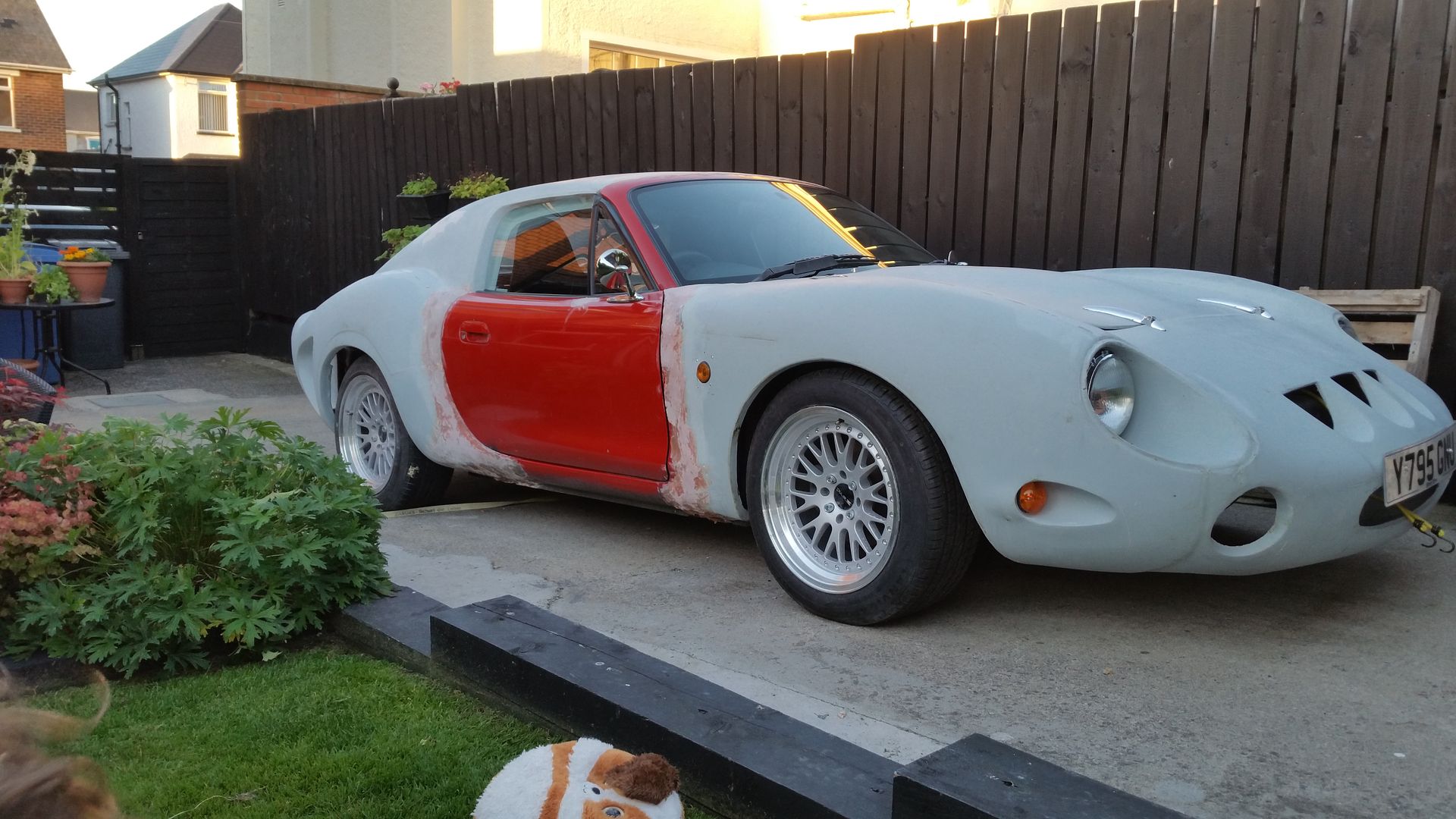

Hi guys, I have had a good couple of days on the car and things are progressing quite nicely. Front end came back off, all electrics for the front lights extended, then set about front end off, on, off, on for trimming to get the height right. Got that to where I am happy and then got the front bonded, bolted and riveted on:
I will wait for tomorrow to take the screws out, give the glue time to go off. Then will get my first skim of chopped strand on there.
In the mean time I got all the front lights wired in and mounted. Had a drama with the left hand indicators - every time I indicated left it didn't work and the wipers came on! Took me over an hour to trace the problem. I took all the heat shrink off my splicings, re-did them, still the same! Turned out to be a bad earth and the indicator was trying to find an earth through the wiper motor???? Anyway all sorted and in.
Tomorrow the forecast is good, so hoping to get a skim of filler on, the other 2 vents cut out on the front and then start shaping an filling ready for the bonnet hinges. All good!!!!

Hi folks. I haven't been on here for 6 weeks or so for one reason and another:
1. We had family visiting from Cape Town so she who must be obeyed had a long list of stuff that needed doing - decorating the downstairs toilette, the dining room, cleaning all windows inside and out,
2. Then we had the 10 day visit of family (my family so I shouldn't complain).
3. The weather in Belfast has been awful - after a fantastic spring the weather in the last month has been s***e, barely a day without rain at some stage or another.
Having said all that I have still managed to do a bit and have the all the front lights in and vents cut:
I have some very nice windscreen washer jets in (and working):
All 3 front vents cut and a test fit of the chrome surround:
The bonnet hinges fitted (needs some filling and smoothing to fit correctly):
Really hoping it will be on the road in the next 2 weeks so I can visit some paint shops and get quotes for paint!

Hi guys, need a bit of advice on wheel spacers. Due to being on a budget I opted for a second hand set of 16x8's. Front end are spot on (see pics), however the rears are lost in the rear arches (even with 25mm spacers). I am contemplating upping the tyre width from 195 (on the wheels when bought) for 225, but am also thinking I should go for wider spacers. Is there a max width you can go to over 25mm (safely)? And does anyone know of a stockist? Cheers.

Posts: 549
50mm seems to be what several people have done, including me.
I got a pair from freaky parts, about £70
  #136
Old 21st July 2016, 22:29
306craig 306craig is offline
Join Date: Feb 2016
Posts: 272
306craig is on a distinguished road
Excellent!!!! Thanks mate, appreciated. Off to look at 'freaky parts'.
  #137
Old 21st July 2016, 23:02
Join Date: Feb 2016
Posts: 272
Ordered, 90 quid (including postage). Result!!!!!!!!!!!!! Thanks Landmann. Pictures will be up as soon as they arrive and are fitted.
  #138
Old 22nd July 2016, 09:53
Posts: 549
Took about 3 weeks to come for me, but included a free Freaky Parts sticker!
  #139
Old 22nd July 2016, 11:02
Join Date: Feb 2016
Posts: 272
Result - you cant knock a free sticker!!!!!!!!!
  #140
Old 25th July 2016, 22:43
Join Date: Feb 2016
Posts: 272
Well the last week or so has been quite busy (in between LOTS of rain showers).
50mm rear spacers for the rear ordered (thanks for the pointer landmannn), however the engineer is on leave so 4 weeks to delivery.
Been working on getting the car legal ready for hitting the Ulster Kit Car Show on the 06 August as I have got friendly with a guy who is a member and is building one himself. He is nowhere near finished his and has asked me to take mine to the show:
So bonnet pins fitted, boot locking mechanism 'sorted' (more about that later).
Started thinking about getting the car water tight (although that will be difficult as Chris still owes me a rear window), so need to source some rubber sheeting to manufacture arch liners from. Started waterproofing the 'boot extension'.
Side repeaters fitted.
Changed the drivers door window (chipped it due to door shut needing shaping I forgot and had the window all the way up and swung the door shut).
Wing mirrors fitted.
Battery charged.
Confident that (weather permitting) we will be legal and water tight by the end of this weekend (less the rear window - clear sheeting and duck tape here we come).
