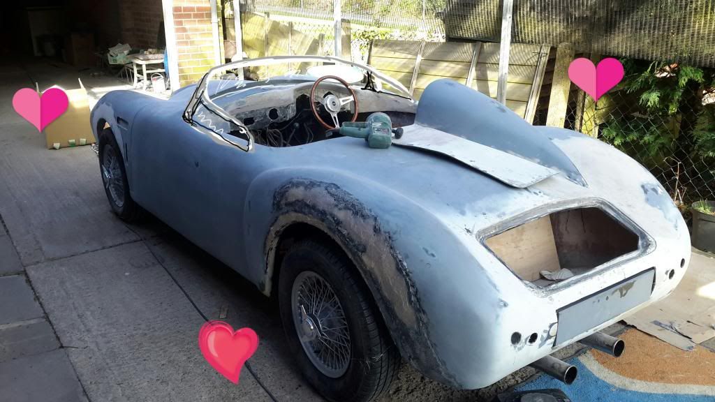

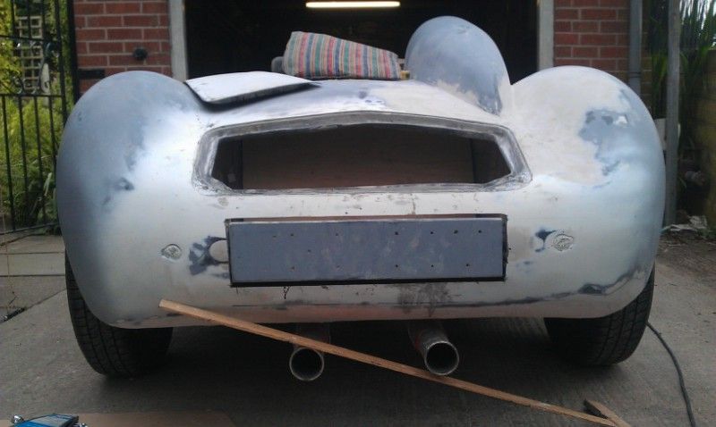

Next the dash. school report said always has head in the clouds. Im one of those people who can picture what i want in my mind now im old enough to be able to produce it. Filled and sprayed [/IMG]

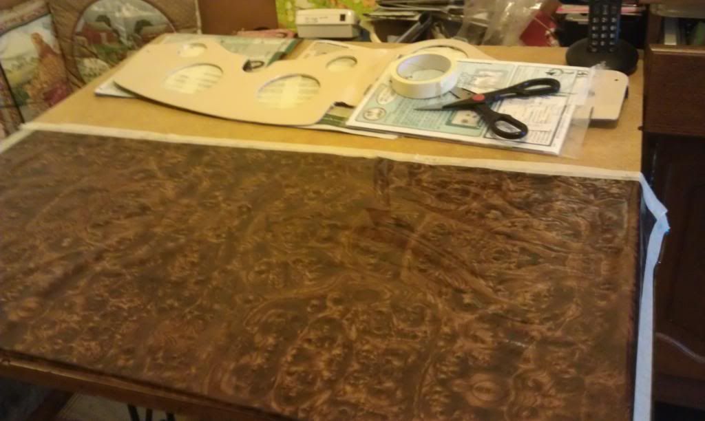

I wanted a Walnut dash i can paint but found this and wanted to have ago at hydrographic transfering. a print on a pva background [IMG][/IMG]

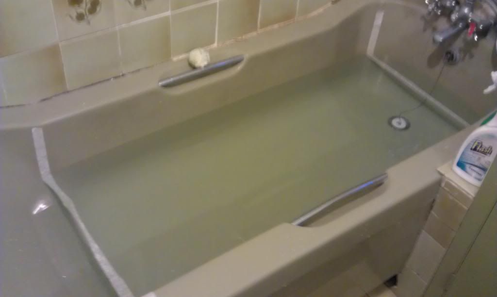

Step two fill container with 75 degree water. my mums bath seemed ideal and as shes on hols no questions as to what i[IMG][/IMG]m doing

Tape edges of film lay on water for 60 seconds then spray activator wait 20 seconds until film dissolves then lower item at an angle until submerged shake under water then lift and spray with water until residue pva is removed. Not Bad for a first attempt [IMG][/IMG]
