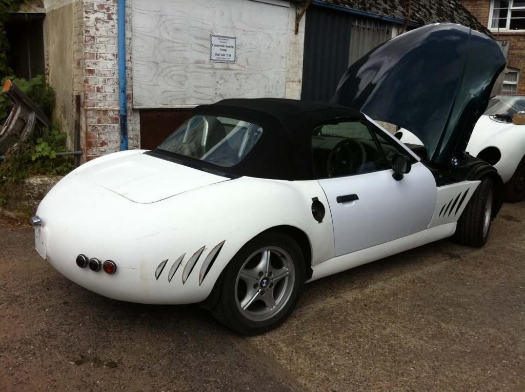

Ian came down to collect his Z300S today, he was really pleased with the stage the car was at. We were asked to build to a driving condition that Ian can detail and paint in his own time.
I am guessing he enjoyed his drive home to Oxford, via WCA's house:
Too right, Chris. many thanks for a great job. Everything works- it's a practical everyday car already. I'll be back next week to collect the remains.

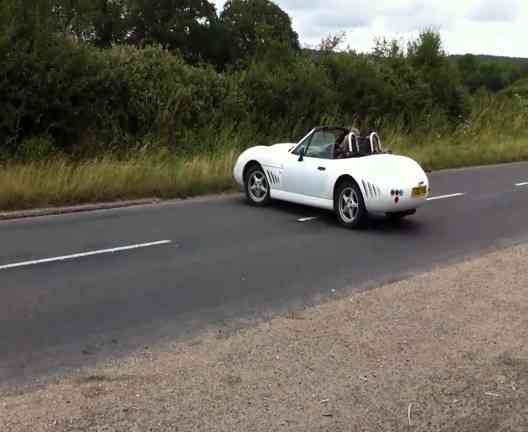

Just driven 230 miles in my Jago- the last 120 miles like this

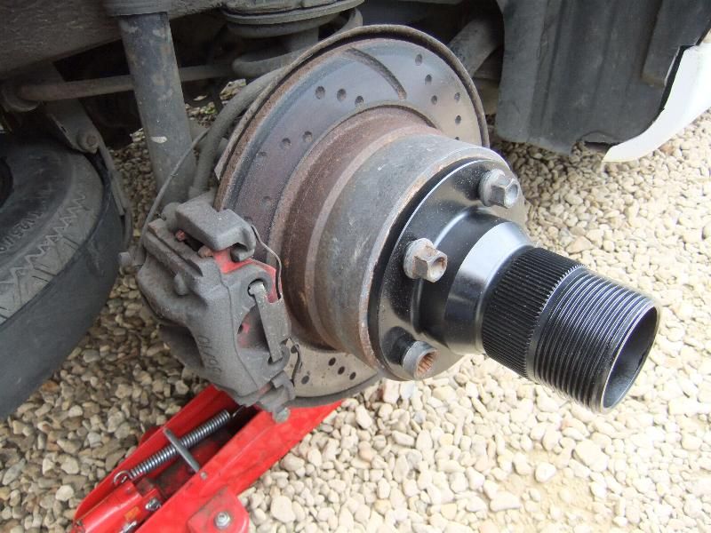

Default In all its wire-wheeled glory
Dry fit and exhibition revs only.
I fitted the MWS Jaguar wire wheel adapters today and here it is:
The adapters fitted perfectly in terms of bolt PCD and diameter. There was <1mm play against the hub centre as well- result.
My only reservation is that the holes in the adapters are 45deg countersunk whereas the bolts have a 60deg bevel. The standard bolts clear the curly hubs. I did try my cone washers but that would need the bolt heads to be trimmed slightly. I'm not convinced that the washers are the best solution anyway- anyone know of 45deg chamfered wheel bolts? M12x40mmx1.5mm pitch?
