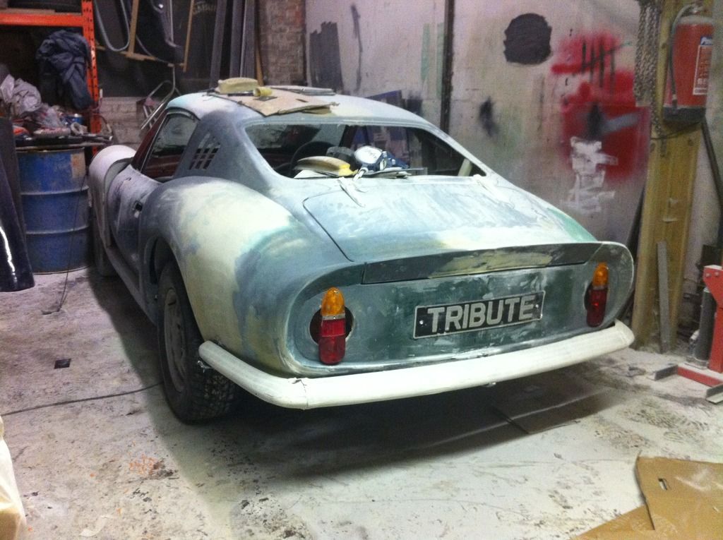

More progress on the buck for Kidge's car. I realised that the top of the SWB rear wings were much flatter than the 275's, so the they were reprofiled using a strip of alloy as a guide followed by lashings of filler.
Once the ends of the spoiler had been reprofiled the centre section on the boot lid could be formed.
B pillar vents starting to be formed.
Rear wheel arch lips removed
Rear end shape nearly there, just boot opening shape to be finalised before everything is smoothed out for moulding.
Rear bumper hung on temporary brackets to check fit against body, some work still to do. These obviously aren't the rear lights that Kidge will be using, I was just having a ponder........
