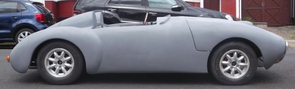

The fact the driver's side photo was taken 'looking down' means that you can see more of the scuttle area.
Which, in turn, makes the body shell extension look both smaller than it is, and smaller by comparison.
For a further comparison, here are two completed Sammio Cordite MkIs without the body shell / bonnet modification.
13" wheels
15" wheels
So the real improvement in my car is the fact I've kept my donor's 13" wheels but reduced the arch gap to the equivalent of fitting 15" wheels.
( Whilst retaining the full 'flip up' bonnet that the silver demonstrator didn't have. )
But the key thing for me now is to stop worrying about the wheel arches and get the car ready for an MOT.
Because, as I've said before, does it look like Vanessa's front arch profile is stopping Andy enjoying his car?

However, I will leave you with these photos of the car parked in the middle of the road this morning, when the sun was shining.
Got to say I'm lovin' the way this looks and am seriously looking forward to my first drive to the MOT station (whenever that may be).
Until next time, take care, Paul.
