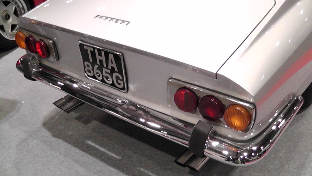

Struggling to decide which way to go on rear lights. I quite like the GTO / land rover /lucas rear lights. But with added fog, reversing lights and reflectors, I think it looks a little busy.
I quite like the Daytona rear lights, but can't really find anything similar for sale that would fit flush-ish on the rear of the kit.
Any ideas /good web seller links?

Check out Opel manta "a" series rear lights

Nissan skyline lights on mine, but a tight fit and a pain in the arse

Google images "BMW 2002 rear lights"
Similar to the black 275GTB. brake/tail, indicator and reversing light all in one, I was going to use one of the reversing lights with a red LED bright bulb for the fog light. Meant to be separate but my MOT tester said it would be ok.
I bought mine on Ebay.DE, don't come up much on UK Ebay.

Thanks chaps. Neither Manta or BMW 2002 is doing it for me though. Need to make my mind up soon though!

Now those Opel GT lights do look nice. Looks like the main lights just cover indicator, stop and tail light though. You'd still need separate fog, reverse and reflectors?
http://www.ebay.de/itm/Opel-GT-Blink...YAAOSwcL5XMLnq

I think the only way you would get an "all in one unit" is if you got those modern kit car LED units, but they don't look period and scream kitcar.
Take a look at older Nissan skyline various models of ferrariesqe rear lights. And can be had very cheap, think mine cost £10 off ebat.

Don't know if this helps but Fiat 850 lights are very close to the 275GTB design.

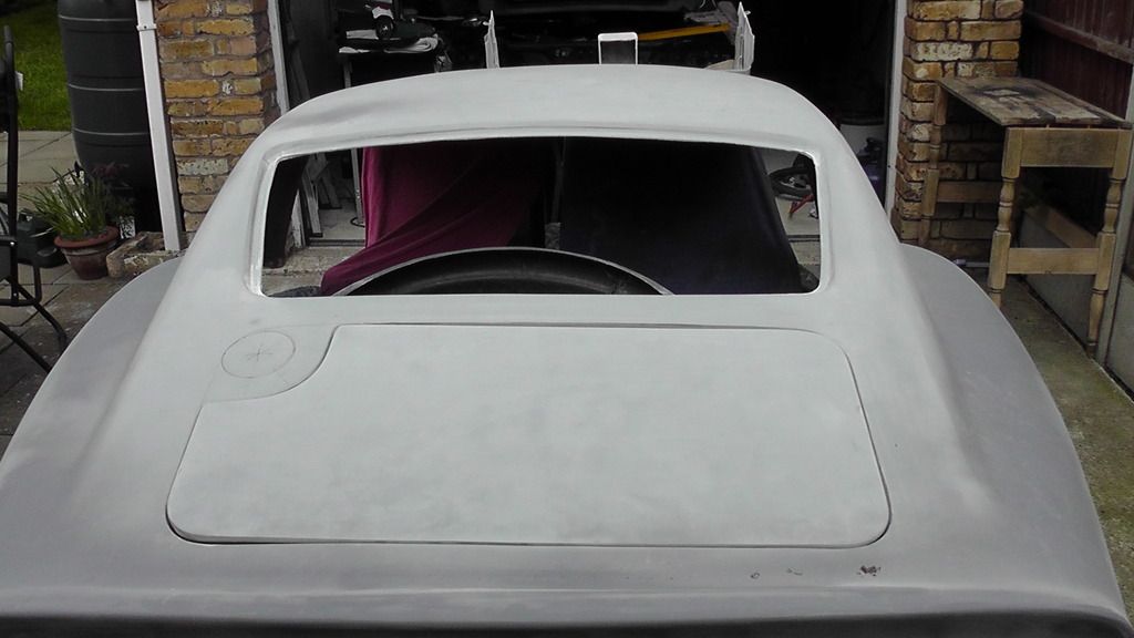

Default Boot Lid
Struggling to get the lid to sit on the rubbers straight. It is high on the lower left corner and low in the middle of the top edge.
Any hints / tips on how to get the lid to sit flush with the body?

Its hard to say from the photo but a few things to consider.
Is it the boot lid that needs adjusting or the surrounding areas that it sits in.
Does it sit better with the rubbers removed. Bear in mind that they will compress a little one time.
Can the lip be trimmed to allow the boot corner to be lowered.
With my bonnet, I put some slices into the strengtheners underneath, curved the bonnet and glassed it back up. You could do the same, screw the boot lid to the car to get it flat and then glass it up from underneath. Screw holes are easily filled afterwards.
With the ariel, I bought a sharks fin ariel from Ebay for about £10, it has some kind of circuit board inside and a lead with an eyelet on the end. The eyelet screws to the old ariel base and the sharks fin sits under the fibreglass shell with double sided tape. It actually has better reception than the original ariel, this was on the Z3, the fitting may be different on he MX5.

Posts: 549
You are sitting the shell on a big bucket, this is distorting the frame.
Fit the shell to the car first. It will require some fettling to fit.

Thanks guys - good advice. I'll try it again fitted on the car first and then see if I need to do anything more major afterwards.

Yep, I did build up the shell a bit to meet the lid, I guess a couple of mm out.
