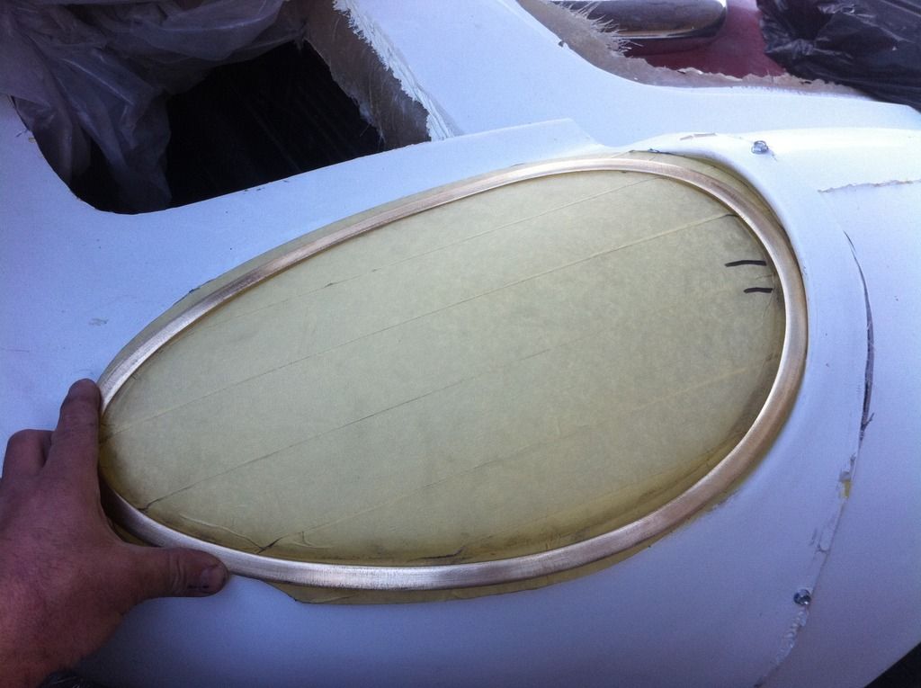

I think I need to state a few things about this project before we get to far ahead of ourselves here.
Our customer (Kidge) approached us about 2 years ago with a view to having an MX250 built, but on driving an MX5 decided he needed a little more car around him. At that time we had started on WCA's Z300S project and Kidge liked the idea of the Z3 base car. He asked about the possibility of producing a 275 'style' body conversion. Now we have finally made a start on the project the brief is to take one of our existing SWB kits and change the nose, tail and some other details such as side windows to make a good looking car, not a replica as such.
We are treating this as a one-off for Kidge and currently have no plans to produce moulds and kits, we have spent way too much time and money on the SWB project over the last year.
Back to the car, Kidge is planning to use TVR light covers along with some very nicely made brass trims that will later be chromed:
  #27

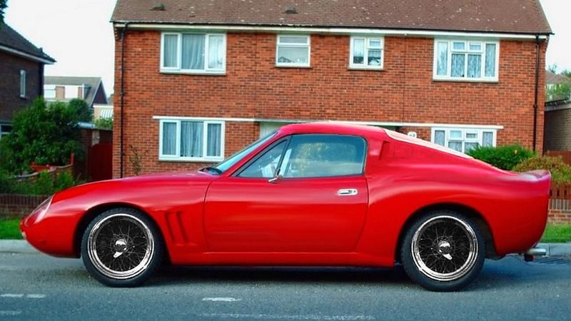

Old 31st August 2015, 22:55
  #32
Old 31st August 2015, 23:13
Originally Posted by DSG4ME View Post
What about a 275 Nart Spider kit ?
It would be easier to build than a GTB.
Some say the 275 Sypder is the most desirable Ferrari of all as only 10 were ever built. You can imagine how difficult it is to see one on the road.
Maybe.....
  #33
Old 1st September 2015, 00:35
Location: Birmingham, UK
Posts: 529
That's looking very cool!!
  #34
Old 1st September 2015, 08:15
Join Date: May 2015
Posts: 161
That's got an awful lot of potential!
  #35
Old 1st September 2015, 08:19
Roadster's Avatar
Roadster Roadster is offline
Posts: 934
That's looking great
When I saw it in the flesh I was aware just how long the front overhang. But the rear is in proportion and it works.
Its always great to see all the separate elements when they blend into the final shape
