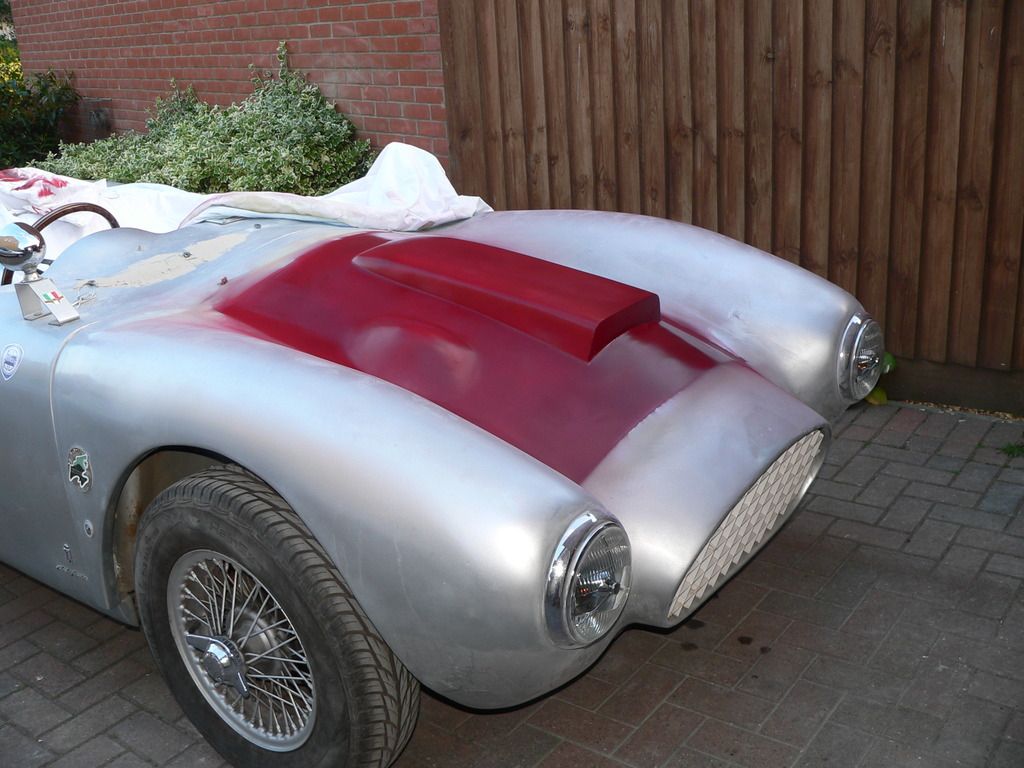

I have managed to spend the last few days working on the bonnet though, getting through five kilos of filler getting the curves right, which has also resulted in a slightly lower profile scoop -
Before
After
Before
And after
And from a few more angles
Nearly ready to take a mould from then laminate the actual new centre section, as this one's all chicken wire and filler under the surface.

Thanks for the positive comments guys, much appreciated.
Gary, I was never 100% happy with my original wide scoop either.
Paul, well spotted - I've removed the vents as they were no longer symmetrical to the new scoop. If you recall they started life as an aluminium double row louvred vent intended for a cupboard door that cost me about three quid from ebay, so I had no qualms about ripping them out. I won't be replacing them as the paint tended to flake off the louvre edges.
I'm not sure quite what you're asking about the holes for the bonnet pins, as they're just, well, holes. If it helps, these are the bonnet pins I used -
http://www.ebay.co.uk/itm/Universal-...EAAOSwPYZU5M3s -
I've fixed the pins to brackets on the bulkhead and the 'keyhole' escutcheons are screwed down over suitable sized holes directly above the pins. They're adjusted by just screwing the pins in or out as required and locking them off with the nuts provided in the kit. Couldn't be simpler and prevents the back edge of the bonnet from lifting at speed.
Jag - I'll be putting some sort of grille or mesh into the opening of the scoop as it's now very close to the water pump housing which isn't particularly pretty, but haven't fully decided what yet.
Right, back to the grindstone...

Mr T - I hope the taking a mould process goes well.
I'm sure your car would look good in red too.
12th May 2017, 06:46
Posts: 839
Is that a test for lancia red Mr T.
12th May 2017, 07:56
Kind of. I needed some rattle-can paint to seal the bonnet buck prior to a dozen coats of release wax so chose Rover Damask Red just to see what a very dark red would have looked like.
Result is that it looks good but shows flaws in the prep that silver doesn't, so silver it shall remain.
I'd recommend metallic silver to any first-time amateur sprayer as it's very forgiving and really sparkles when the sun shines.
