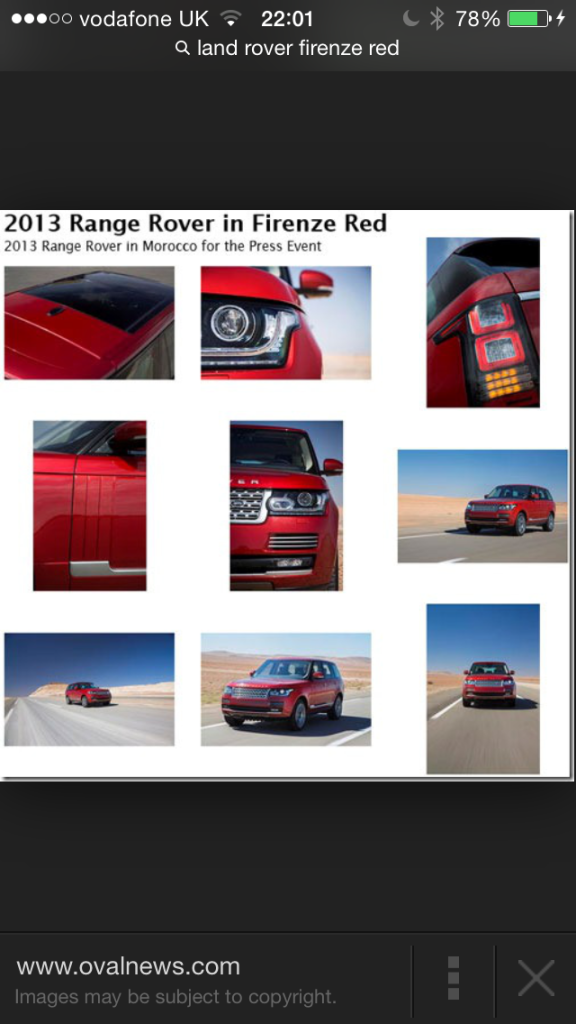

Actual got some work done, chassis completely welded, schultzed then paint in Land Rover Limestone enamel paint.
This where the real work now starts.
Thought about the colour and I think I am going to go for a colour called
Land Rover Firenza Red
26th September 2014, 06:28
Nice colour for chassis and body, keep posting...

Nice work on the chassis.
Good choice on the paint too, as the red Speedster that MikeMiglia build looked great.
