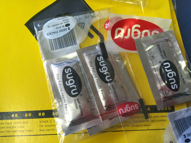

Just thought I would share.
Am trying to use period light fittings wherever possible and found some lovely new Lucas L534 number plate lamps in the workshop clearance I did last year. Only problem is that the lamp has a flat base and the location it needs to go on is curved, considered trying to hand carve a rubber gasket but then came across this stuff:
Its a pliable silicone putty that when left for 24 hours air cures into solid silicon. Have played with it a bit and it does indeed exactly what it says on the tin!
Its not exactly cheap but for the ease of use on a small but time consuming job like this worth every penny. Just used 4 packs (3 in each pack you buy) and moulded it roughly under the lamp base them fixed the lamp in place letting the excess squash out. Cleaned it up using a couple of scraps of plastic just gently scraped around the edge then finished it by running a clean finger around. Very happy with the result and took about 10 minutes whereas carving or casting a custom gasket / plinth would have taken hours.
The end result:
Also just about to final fit the rear plate and as you will be able to see the back of it gave it a couple of coats of gloss black. The plates are the original ones off the donor and I quite look the used look they add to the car.
If anyone wants to find Sugru you can order online or just go to B&Q like I did, its available in a range of colours.

Nice tip on the sugru Mac i may try it out on the rear number plate light fitting i have that's is made to mount onto a flat surface.
Cheers Matey.

Swifty: I can report it sets good and hard but still pliable and the finish is good as long as you take the time to smooth it out a lot during application.
