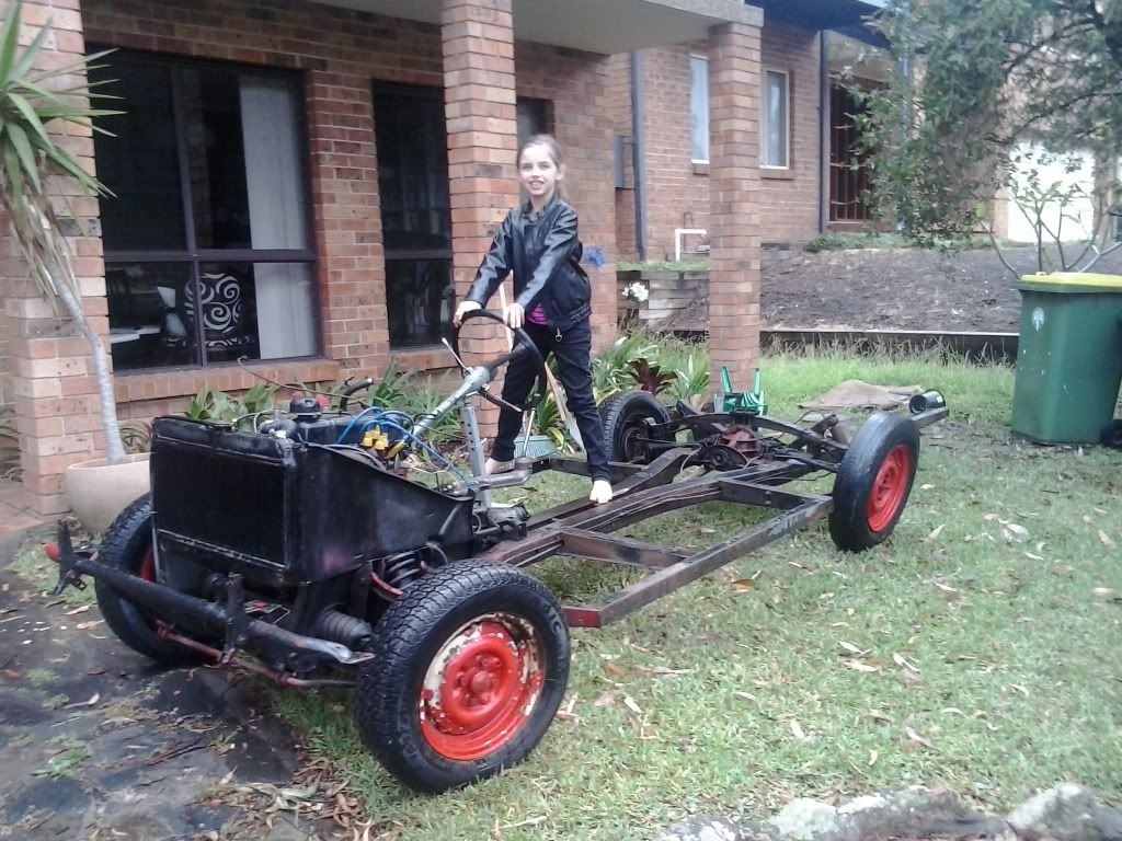

haven't posted for a while - can't get photo bucket at work and home my wife usually has the computer. (i know easy solution.) however, heres the work so far. pity its on the way down not on the way back together, but here it is. gave it a pressure clean. next step is to get the engine n gearbox out, and keep dismantling. the chassis will be sandblasted and powder coated. (thats the plan, wallet permitting)

Morning Tim, keep taking the photos if only to help you re-assemble. What ideas do you have for build? Are you aiming for D24 look-a-like style or something different?

Slow progress is better than none!
Chassis looks very clean and an excellent base for your Miglia.

Thanks guys. Its night here, don't mention the cricket. Yes I'm very pleased with the quality of the bones. I will be going for an old school look, kind of d24 but also without constraint. It'll be reg as a 1961 year based on the chassis, so carries the dna, but will also be a miglia. I'll try using the herald seats too, and initially those wheels u see. I'll use ally sheet for the cocpit, perhaps a "quilted" roll finish but that may constrict bends. We'll see.

I can't believe that herald has such a clean chassis

Thanks charman (ha how's that for a recovery in the ashes last night!) I think that would be because in Australia we don't grit the roads with salt. Just to make you all cry, there is only vague traces of surface rust on the chassis, otherwise looks brand new. That said, I've tried to sell the other body bits but the market for them is so low I've so far only sold the back bit, and that was to a guy who was going to use it for decoration!

look nice and clean, have you had to do much too it?

mikmiglia is on a distinguished road
Originally Posted by 1iTim View Post
Chassis is in great condition. Your climate has looked after this

Wow, that really does look like a new chassis. I'm very jealous.

I have to weld back in one of those spacer tubes for the body bolt but adide from that its fine. You wait till u see it after blast and mazda true red a4a powdercoat. Mike what did u do to the front ride height of #1?
