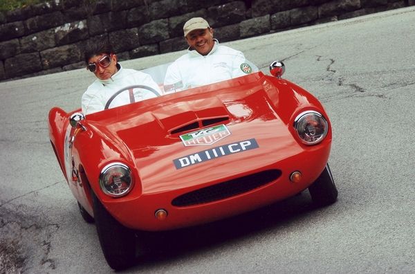

Old 2nd May 2018, 17:19
Posts: 5,141
Originally Posted by micky1mo View Post
I know it's got the looks only a mother could love but it's a classic.
I dunno, in a decent colour and with just a flyscreen it doesn't look too bad to me -
Mind you, it needs lowered floors and laid-back seats to avoid the Noddy Syndrome -

Old 2nd May 2018, 17:30
micky1mo's Avatar
micky1mo micky1mo is offline
Join Date: Dec 2006
Posts: 1,091
The "classic" shape grows on you after a while.
I plan on cutting out the flat rear deck and grafting the rounder SAMMIO ALPHA rear deck and boot lid.
Might also try a MG Midget aluminium windscreen as well.
We'll just have to wait and see what it ends-up looking like.

I have been on holiday in Verona, and visited a car museum nearby. Amazingly my wife saw a poster for it, and said she would love to see some of the older Italian cars in the flesh.
Two of them were of interest wrt to the small / simple lines, a Zanussi and a Fiat 500. The Zanussi is red, and the Fiat 500 is light blue.
They altered my previous opinion of this project.
Note the "bucket" footwell in the last picture.

Very nice with simple lines.
Are the cars as small as they look in the photos ?
Old 13th June 2018, 19:19
Barber's Avatar
Barber Barber is offline
Join Date: Apr 2016
Location: Camberley
Posts: 972
The Fiat 500 is tiny, the Zanussi 1100 and Fiat 1100 were a bit bigger, about as long as a Z3 I would guess, maybe the Zanussi a bit longer than the Fiat.
