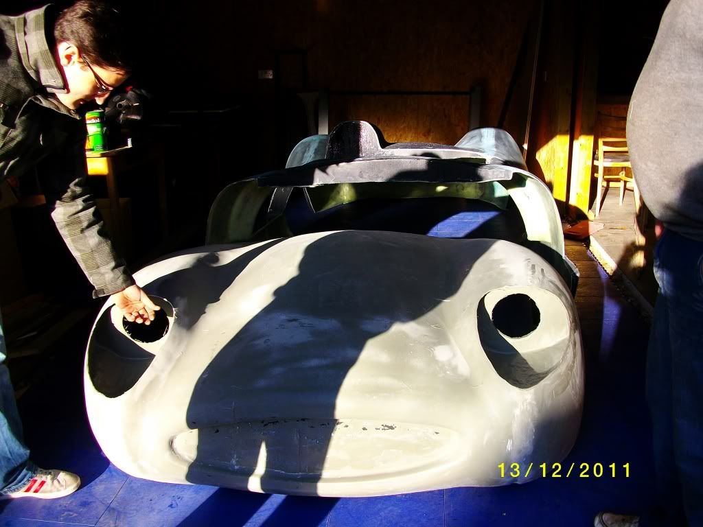

last post was a tester to see if we could add pictures, it works. Main body located, seemed to go well a lot more fettling before final fix, pure enjoyment rear goal posts and cills clamped into dims you have me, had to take top corners off but fits as snug as a bug in a rug. lots of measuring standing back having a look up a bit down a bit and so on.
See why you had a problem with final dims not be able to take the body off, we are lifting on and off and using all the photos we took at your workshop as a guide, we will take dims and records for reference. It may not be the way every one attacks it but it may be helpfull
This one shows the front bulk head I think we will cut up the "coffee table frame" and insert differently? we may also make the footwells wider in the square aperture with ply formers and move the pedal box over as we need to chop out the tunnel for the exhausts on the V8 and it's always cramped on Se5's when they insert the V8 plenty of room in the G46 wing bulkhead for this.
looking back at the bulk head ply templates will equalise both sides and secure the cills, again we have the luxury you did not have when building the prototype, everything open and nothing in the way. The body was located using the vertical centre line of the rear wheels and rear wheel arches.
will have to cut a little more off the up stands at the front
Under the bonnet test fitted long way off fitting but all looks good for clearance on the V8 nice detail have the cut line on the mould that will help when we come to match the bonnet line to the bulk head, but with a bit of felting should all work ok. Mounting and making the brackets for the forward hinging bonnet will be a challenge but there is good access under the car to take dimension and I suspect we will be coming to take more measurements before then.
So very pleased with today a long long way to go, in a way I am glad it is not a kit with instructions that just bolts on, we are all using heads which makes it all the more satisfying when you stand back and see what we have achieved.

Just come in from an afternoon in the garage wanted to see what the car looked liked with the arches filled out with wider wheels, not suggesting we use the revolutions wring decade, but it gives a good indication where a 15" 245 will sit the car will be a lot lower with engine and gear box in place and with shorter coil overs.
Gary, secured the front left cills by using metal angle straps cut and bent to match and self tapped into position see drivers side photo
I also made cardboard templates and made the inner arch floor, drop down and vertical filler on the passenger side from 10mm ply. The bottom plates are glued and screwed to the straps and cill plates under the doors, the vertical wing filler, I need to glue into position (will I get away with car filler) and then glass over them to give them an element of protection and for firming up the body.
One result is that with all the head scratching I can use the card board templates mirror image for the other side with very little alteration.
