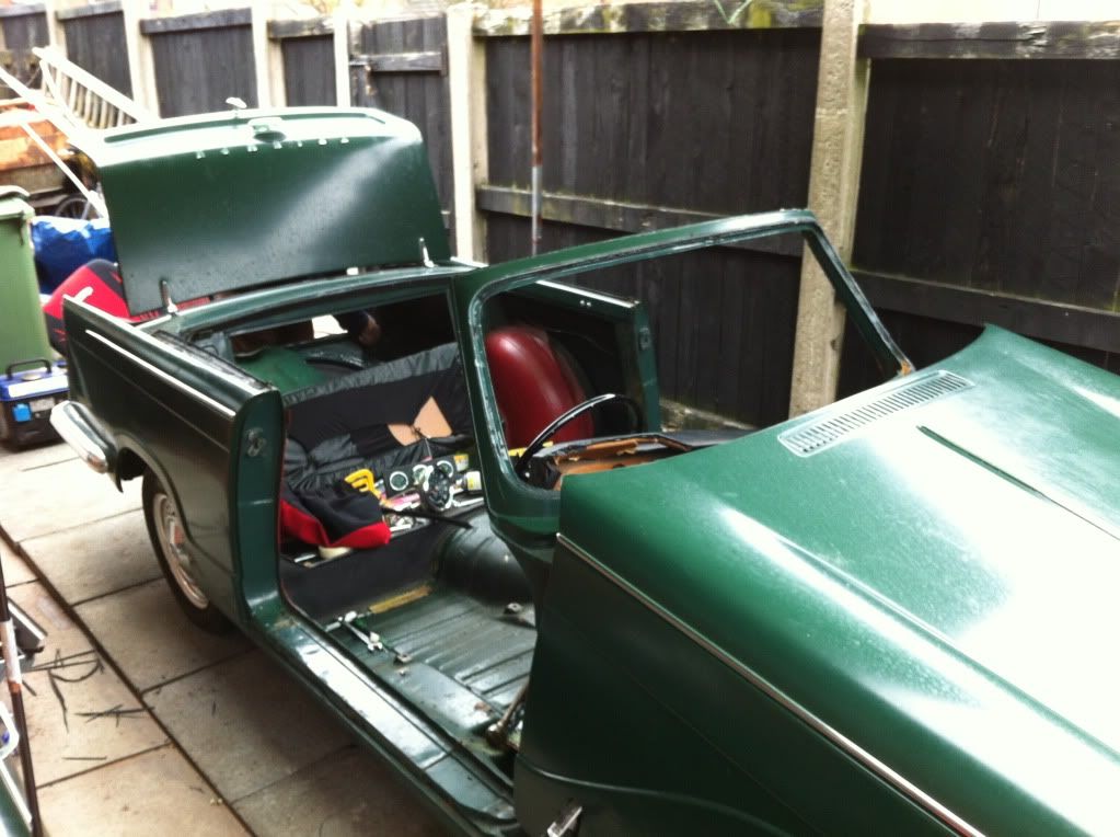

I thought that I would start my own build thread, as much to keep a record for myself as anything else. I have started the process of stripping my Triumph Herald 1200 donor which I bought just a few weeks ago and to be honest, it was such a lovely car that I had second thoughts about using it for the sammio build. In the end though, it was always bought to be made into a Sammio Spyder and that is what will happen.
Car before starting the build
I have spent the day stripping the car down and have managed to take out all of the interior, which thankfully has had no nasty surprises so far with the foot wells in good condition
The roof is now off and also the bootlid, the rear lights are out and the wiring pulled back through so hopefully tomorrow will see the body tub removed when I will get a real look at the chassis.

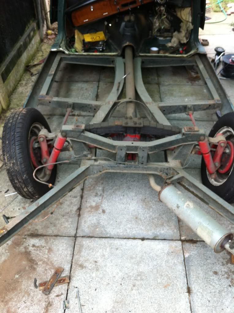

I have spent the morning working on the car again and have managed to get the body tub off. After a lot of head scratching and looking for and other bolts holding it on all that it took was a little brute force to brake through the bonding paste holding it to the front footwells. After getting my first good look at the chassis im im very happy to say that it is in almost perfect condition!
Apart from a little work to do at the front end like taking off the bonnet, bumper, heating unit etc I'm almost ready to start building. I had planned to do a full strip of every nut and bolt but the car looks to be in such good condition that stripping the car any further seems pointless. I will POR15 the chassis anyway as I had already bought it but it looks like it has been done not so long back.

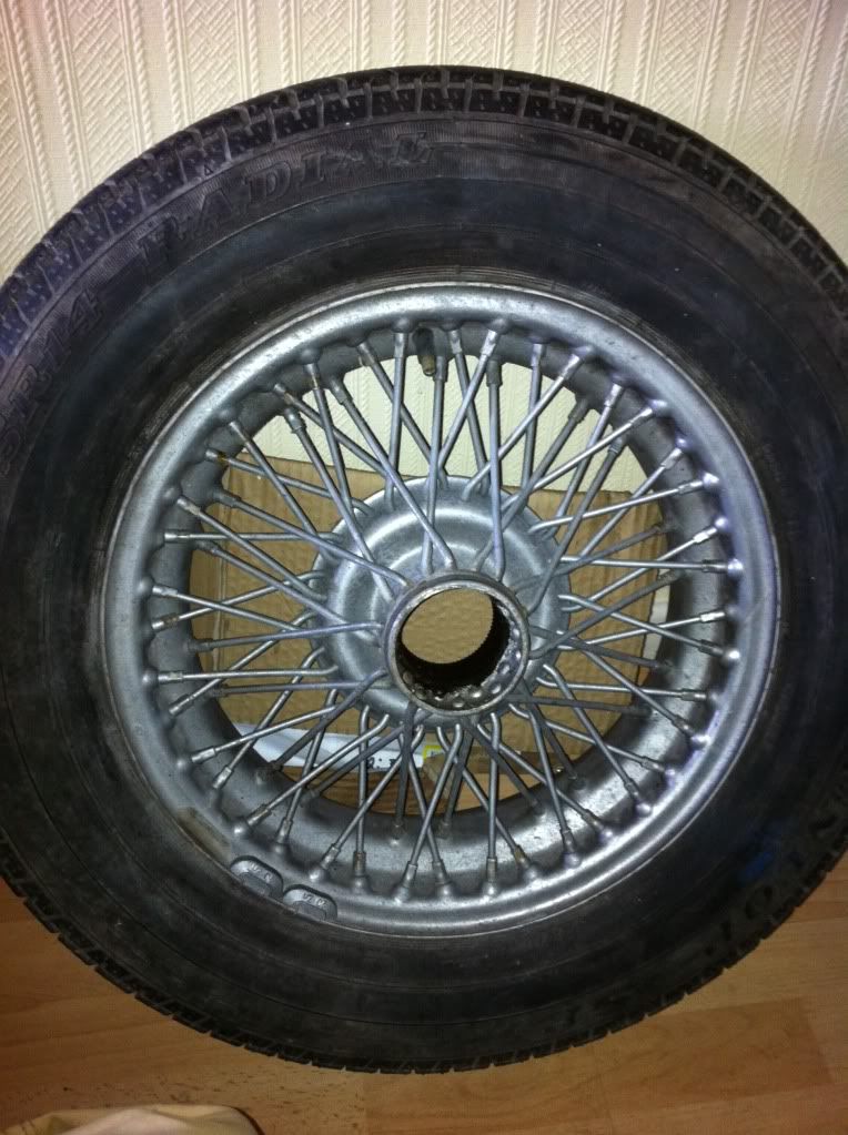

I have had a few deliveries today of kit that I had ordered online. Fibre glass, resin, POR15 and a set of 5, 14inch MG wire wheels bought off ebay for less than £40

Old 15th February 2012, 17:26
While you're at that stage it might be worth while just unbolting the bulkhead, lifting it up a bit and checking the chassis rails under it and bulkhead mounting points, as once the shell is bonded on you'll never get another chance and it may avoid some of the faff I'm currently going through :-)

Posts: 383
Good point dave, I will do that. Will also allow me to paint the chassis under there to make sure its all protected for the future.
