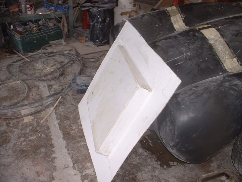

We are working out a slightly different build method for the Cordites , because they are having a more substantial steel frame , we are going to give people the option of having a fibreglass floor instead of plywood...
The front footwells and seat areas will drop into our framework and get bonded in just like our battery trays do....the body can be glassed to the fibreglass floor as well giving you a near total fibreglass tub....not quite but you see what I mean...
We have made the moulds for the seat areas .....they are being supplied with oversize flanges and can be trimmed back to suit.
These will also work as 'drop ins' through a ply floor to give lowere seat bases on an existing Spyder.
Front footwells will be supplied with the Cordite kit or can be bought seperate for £30 each.
Seat pans will be an extra thick layup with 6mm ply inserts bonded in for extra strength and will be £40 each....
Heres the mould for the seat pans to give you an ideas of how they will be supplied......

Hi Gary, can you post the internal dimensions of your lowered floorpans please? I need the width, length and depth to see if my MGB seats will fit inside them or whether I need a complete rethink on the seat front.
Old 19th March 2012, 17:44
Aaaargh ....forgot to do this before I rushed out the door to catch the post...
I know they are 460mm wide , just wider than a clubman classic....I think length was 590mm but need to check that - it is as long as it can be from just sitting up tight to the front floorpans and just shy of the rear outrigger leaving enough room to get a spanner/socket on the tie bar bolts should you need to remove them.
Depth was just a few mill less than the chassis rail depth at the rear , but it tapers upwards towards the front giving you a reclined pan...also they will be made with 3 layers of 900 sandwiching a bit of 6mm ply , so actual depth may be about 10mm less approx. but very strong......I will definitely get correct measurements tomorrow.
These are designed to fit in the Spyder either as drop ins or actual floor and will fit the Cordite too....
Old 21st March 2012, 22:11
450 wide
590 long
about 90mm deep at rear
30mm at front.
Heres the first set going in....these are extra thick layup with 6mm ply bonded in between layers - very strong.
These are being used to create the floor , they can be trimmed down to 'drop in' as well...
They are using a lot more materials than I expected and need to be £45 each or £80 ia pair if ordered with a kit.
