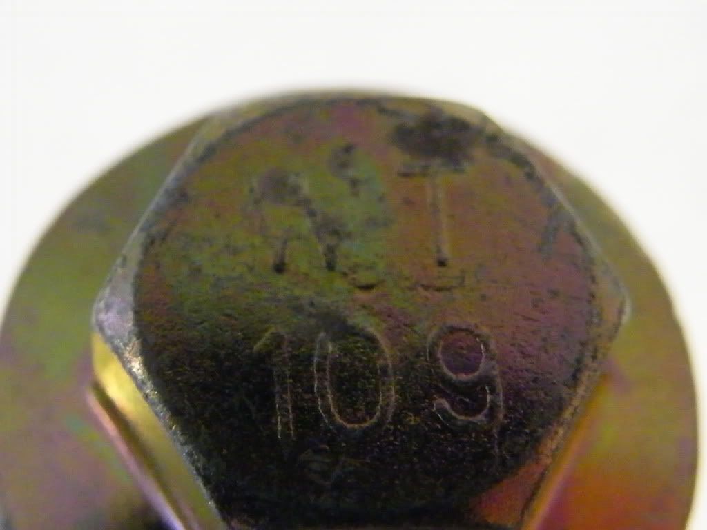

I should have added that the seat belt kit comes with special bolts of 10,9 grade hardness. Harder than normal 8.8 grade hardened bolts.
Could be important for insurance if you later had an accident? I don't think you can just chuck in any old bolts lying around.
Socket head cap bolts can be bought in this grade of hardness, but then you need hardened washers and spacer collet's to do the job.
