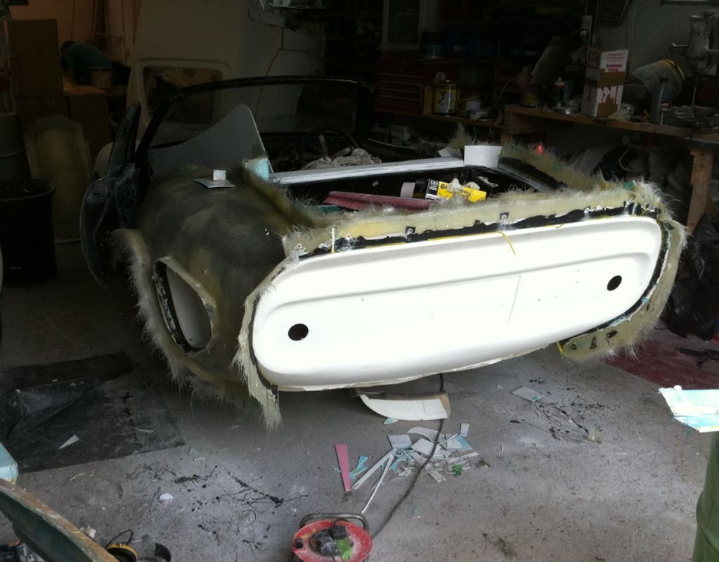

Progress on the soft-top rear end. The boot lid needed "deconstructing" to reduce the height at the rear to follow the line of the rear wings.
The top of the rear wings needed sectioning and lowering to work with the soft top. Interesting to see the width and length the kit adds to the car whilst the top of the wing is missing.
Rear works much better with the top of the wings lowered.
Removable hardtop anyone?

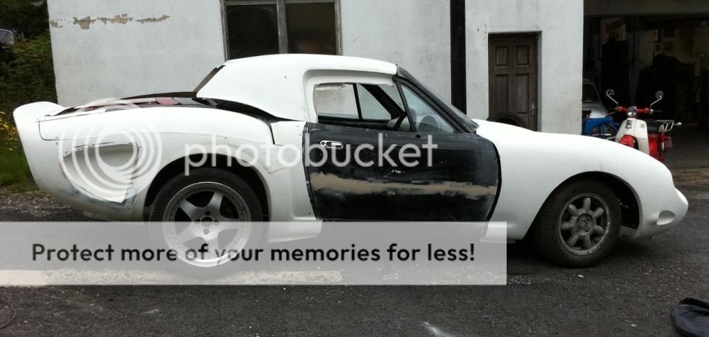

Is it still possible to fit a standard hard top to the car?
Any chance of a few photos with one on???
31st July 2012, 19:03
Yes you can still fit the original hardtop on after conversion. I don't have one to show you, but will Photoshop something and post on here in a few days.
