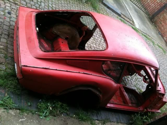

Productive day in on Monday, although the garage is even more of a tip. The red body stripped as naked as the day it was born. Some stuff servicable, some stuff to sell and a lot of stuff to scrap!
Found the tax disc too - last on the road in 1994. Explains a lot.
Had some thoughts about colour. I really like the old english white look with black wheels and trim but, I work for a certain green F1 team and I could probably get a very cheap paint job if I want green!
