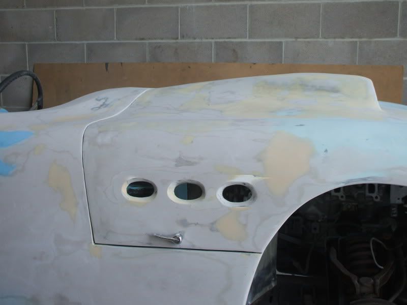

I can't believe it is over 5 months since I first met you & Gary and set off on the Sammio building road.
Like Mister Towed lots of this is very new to me too.
But if I had one initial question for you it would be what sort of filler do you use?
Plus do you have any tips for getting such nice "gaps"?
Some examples below (including your own build).

Hi paul how are you ? i think ive just answed one question about the filler i use on my car section miglia. As for the gaps, well if your trying to gap a door make sure you run at least a grinder with corse dise to etch the inner door shut suround, Fit your door so it fits in the hole, when happy apply Filler over the two surfaces to bridge gap. Once nearly seting just run a sharp knife against the (door edge not the door shut edge to cut first gap). I normaly sand over the top with a d a sander withan 80 grit disc.
This takes time but the end resolt worth it i think, takes it away from the normal kitcar standard door shuts. I hope this helps .
