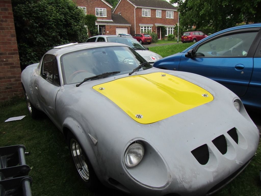

With all the recent discussions on painting on here I thought I'd post a the start of my budget effort on getting some colour on my MX.
[IMG]  [/IMG]
In case you are confused, the car will be yellow not grey. Just to get some colour I've decided to roller it and have tried things out on the bonnet. After a few cock ups I finally got a half decent finish, at least from a few feet away.
Week after next the rest of the car gets painted.

Will be interesting to see what process you use, paint, rollers etc. No doubt there will be a great deal of sanding and polishing after as well

Are you going to be rollering the whole car? Is it rustoleum or coach paint?

I'm using Rustoleum 7300 and plan to roller the whole car. The rollering leaves very bad orange peel but I put a thick layer on the bonnet, let it harden and then cut the orange peel back with 240 grit dry then went through the different grit levels wet until it was ready to be T Cut and then polished.
It's not perfect but I can't afford a pro job so this will do until I can. I estimate that the entire job, paint and consumables, will cost about £300.

What mix thinners did you use with the paint? 50/50?
