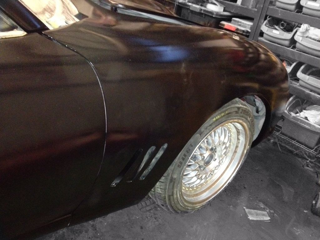

The car is all one colour at last. Just have to wait for the paint to harden now before i can colour sand it. [IMG][/IMG][IMG][/IMG]

Inside that metal shed in this weather you probably only need to leave it a couple of days before polishing.
If you bad mixed the last coat just right it would have come up more shiney, not to criticise, I can only get it right by luck....
I quite enjoy the last bit, flattening with 2000 and cutting compound to bring out the hidden shine.

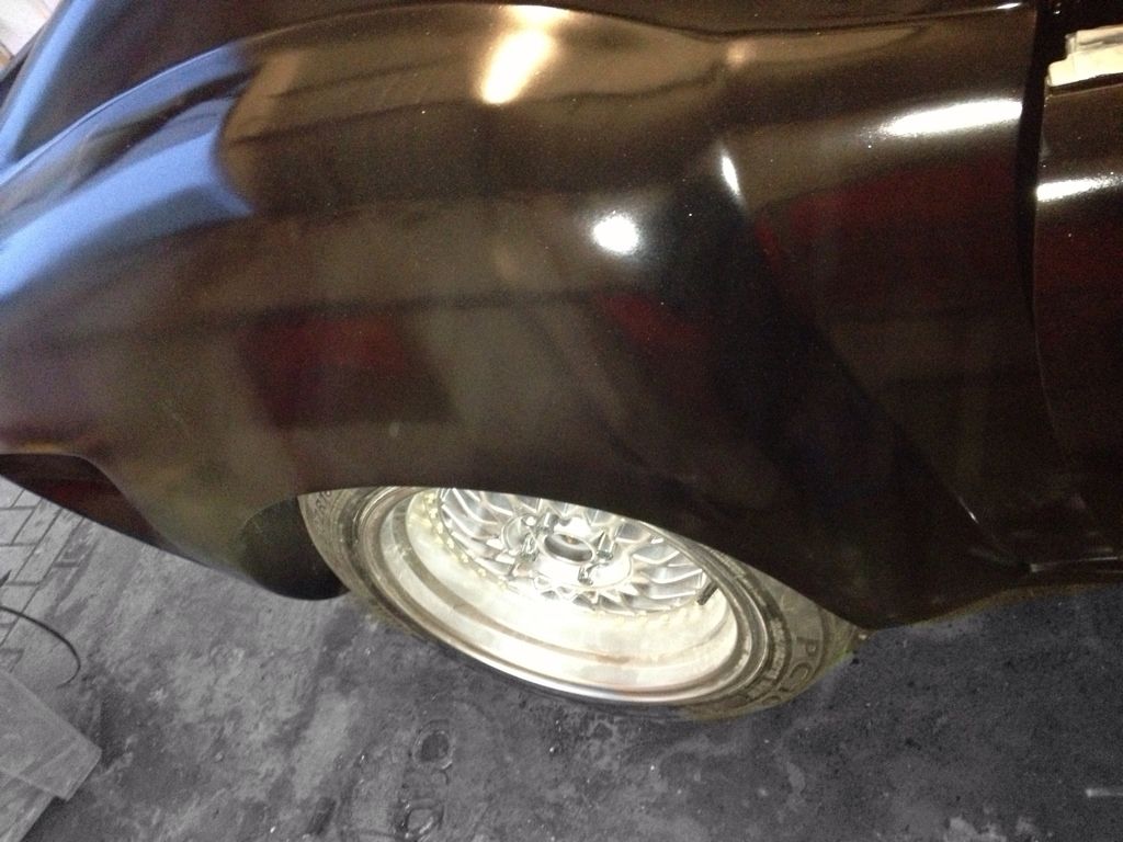

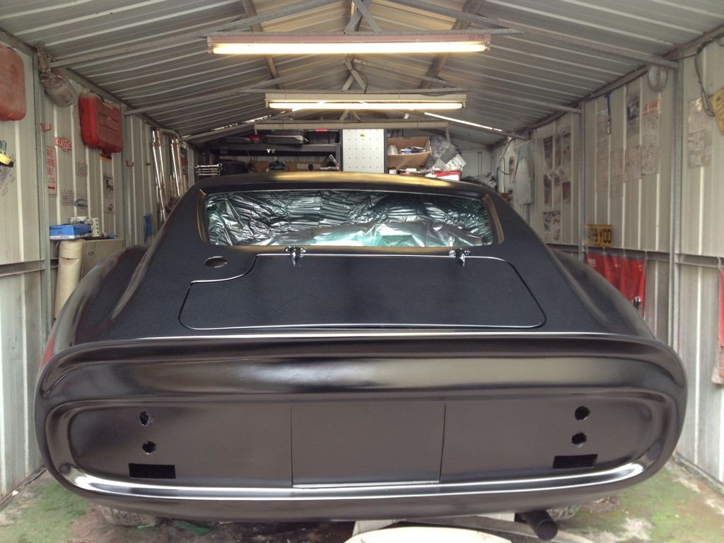

Despite the lovely orange peel affect i feel the black sets the wheels off nicely. When i can get it out of the garage i will take some more pictures stood further back [IMG][/IMG]
[IMG][/IMG]
