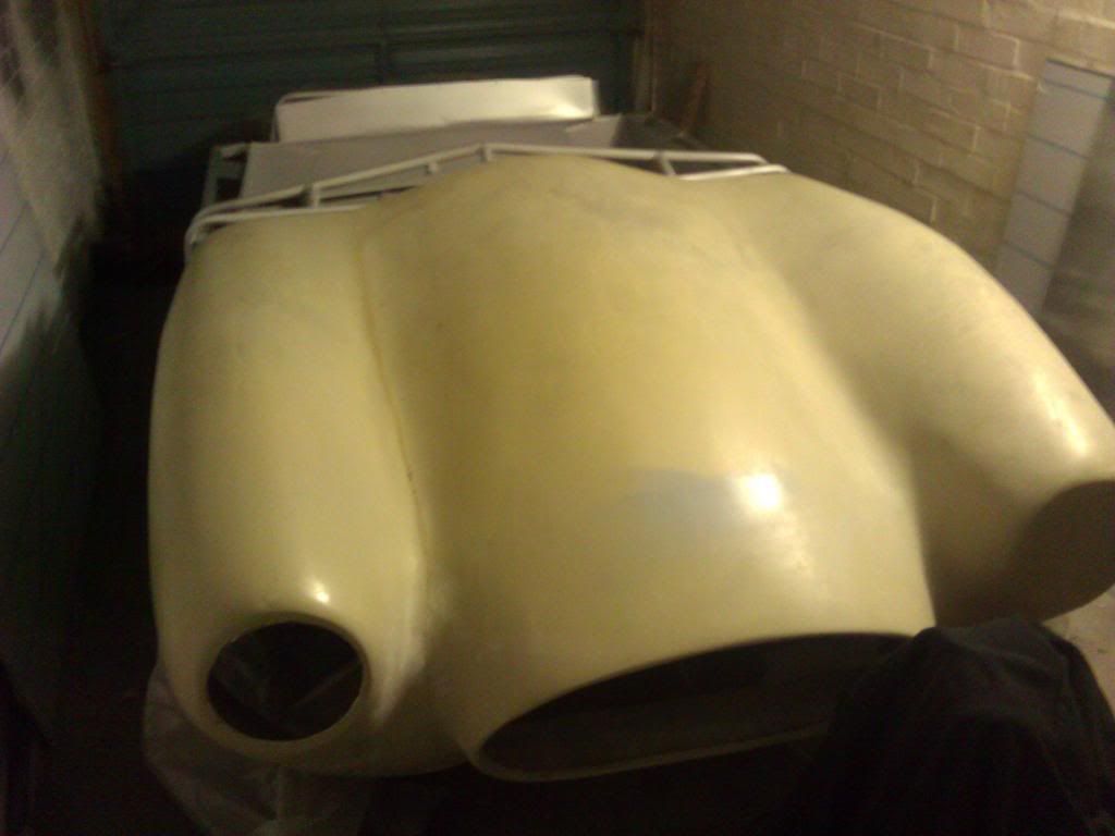

The cabin is aluminium which has been shaped, riveted + composite bonded together.
So im well behind considering how long i've had the car but progress is a lot quicker now so i'll have some more pic's this weekend :-)

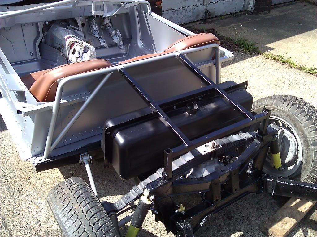

Some updated pics outside

Where do the seats come from?
Old 7th May 2013, 08:06
Posts: 5,327
That looks very nice indeed, love the riveted ally tub. Keep posting those pic's!
Aren't they Mk IV Spitfire seats?

As for the seats, i think Mister Towed is correct, as the guy i bought them from had a few spitfires.

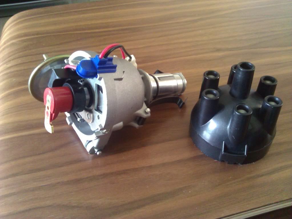

Something else arrived today :-)
