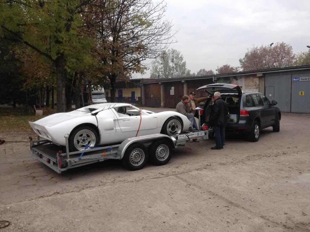

A polish guy here in Hamburg offers GT40 kits made in Poland for a competitive price, so I decided last year to drive to Poland to have a look. I saw a frame, and some bodyparts in quite a good quality, but I did not see a finished car or a complete body. Nevertheless I bought a "rolling chassis" with body to be delivered in october, and than the story began...
Anyway, I don't wanna tell to much about what has all happened, I picked the things up in Poland in october, and brought the stuff home.

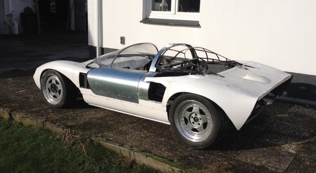

The first idea was to build a GT40 roadster with open roof and a speedster style windscreen, but the more I looked at the car, the less I was happy with its proportions compared to the real thing.
The front was too short and hanging down, the rear was also hanging down and had strange lines, so one day I decided if I have to change so many things to make it look right, and can build something different and much nicer out of it...
The curved front fenders reminded me to the Ferraris from the mid-sixties, the Dino and the P3/P4...
A P4 kit already exists, so I decided to go for the much rarer Dino 206, and started comparing the proportions:
not so much of a difference, but the wheeelbase from the GT is different to the Dino, the Dino 206 is a very small car with 13" wheels, and I (over 6ft tall) will never fit in there...
With the longer wheelbase from the GT it will be a 105% scaled up Dino, which makes it bigger and wider and I do fit in there...

So I decided to hacksaw the GT and build my alltime favourite dreamcar out of it...a big challenge, but at the end I will have a rare car with unique background, as far as I know there are only 18 Dino 206 built and a handfull metalbody reproductions...

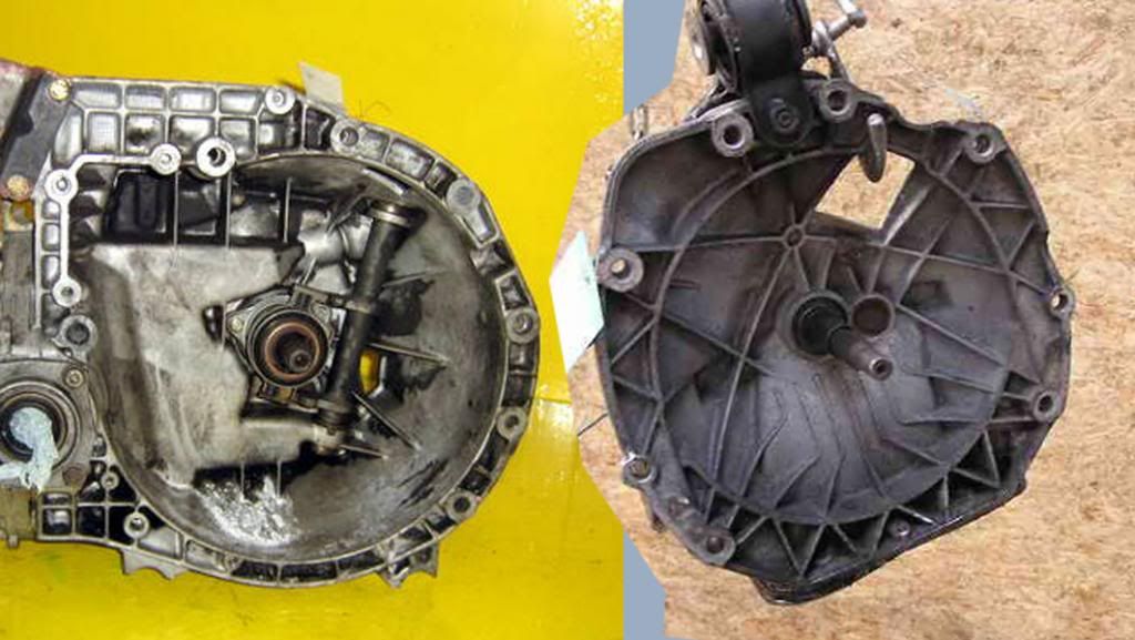

Now engine and transmission choice...
I have a Ford V6 to VW/Porsche adapter plate lying around here, could go for a Ford Essex V6, or even a Cosworth V6, or to have an all italian solution I go for the Alfa V6 attached to a Alfa Boxer gearbox from the Alfa 33 or 145/146.
The Alfa 33 gearbox does not fit the Alfa V6, I still do need an adapter, but I have the hope that at least two or three holes match, and I can use Alfa components for clutch and flexplate, and with an 190hp Alfa 3.0 V6 QV from the 75 or GTV6 it will be a classic and cheap solution compared to the Porsche transmission...
the Alfa 33 gearbox (built up to 140hp):
the Alfa 164 gearbox compared to the Alfa 33:
