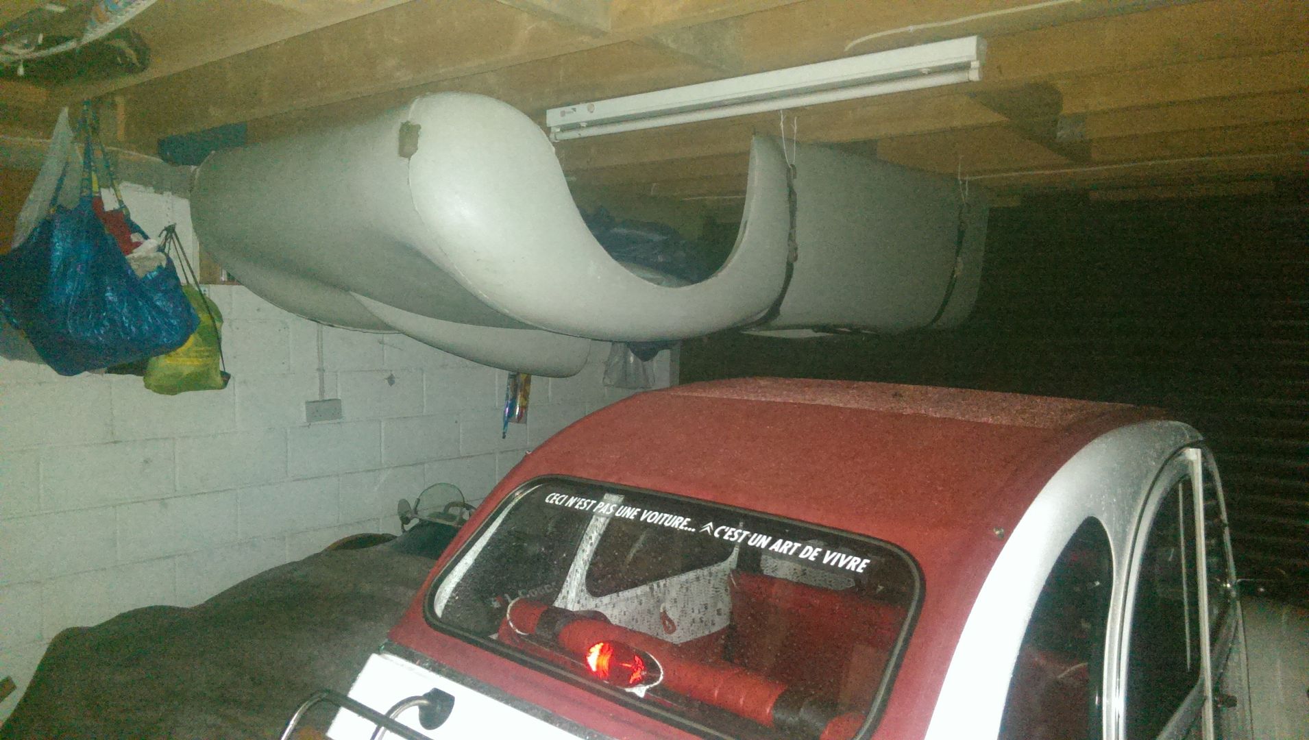

I bought from a fellow member a sammio shell with the idea to built a new 2cv sammio. I read that already two other members decided to go on this direction and I hope to meet them one day.
The donor car is a Manx (2cv kit car) which I bought from a friend of mine. This solution should help me to cut down time and money in constructing the frame. In fact I will use the Manx fiberglass shell as new the main part for the sammio.
I add a few pictures below:shell, donor car (it is the white one ) and storage room.

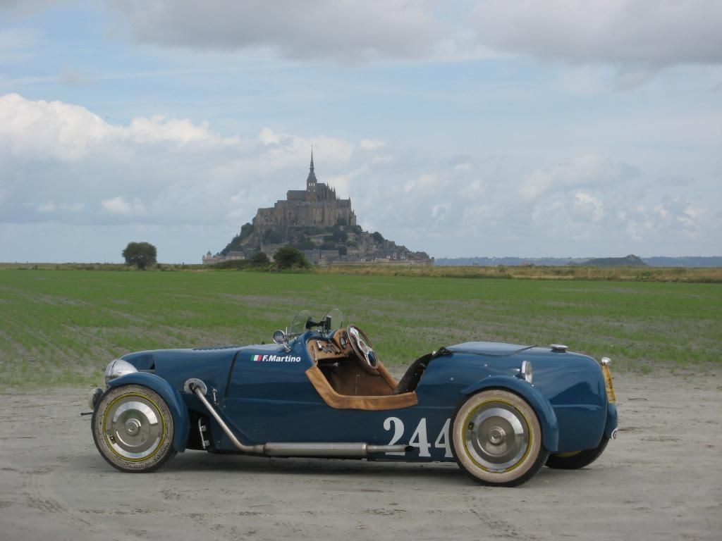

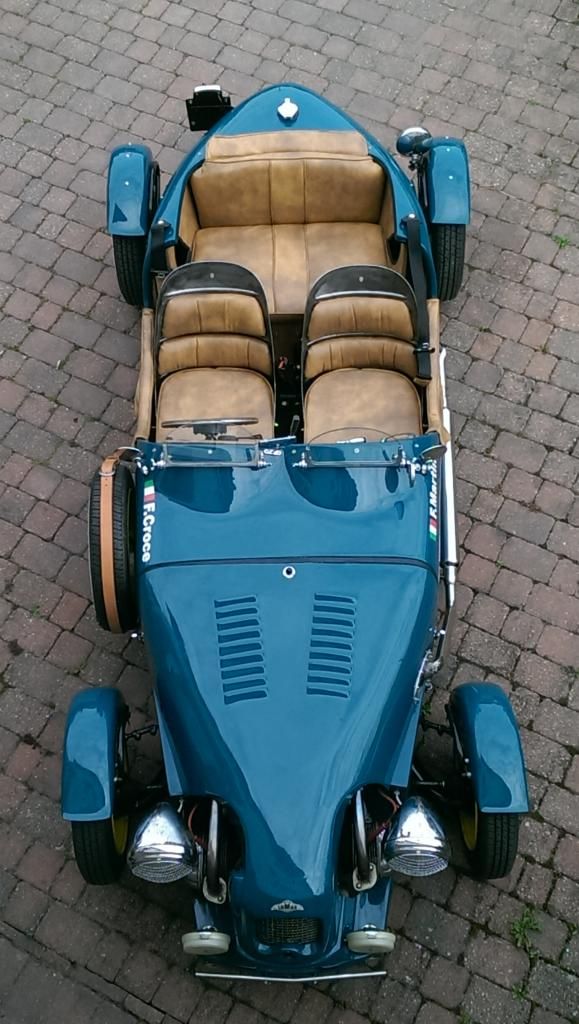

Is "C 480 DBL" also yours, as that looks interesting too.

Yes the blue one is mine too. It is a lomax 224 I bought two years ago and had the interior fully retrimmed (mother in law supreme job!!!)

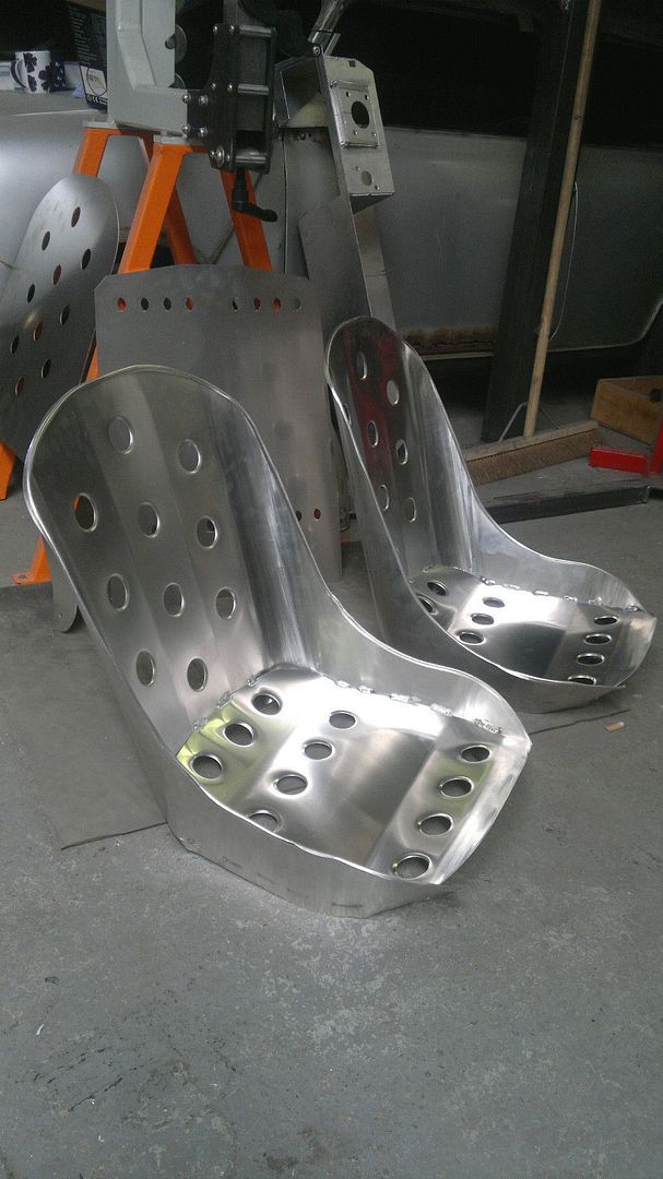

I'd recommend you consider that from day 1 and design in a suitable seating position - you could maybe mount the body 50mm or so higher up and use steeply raked-back seats mounted towards the front of the cockpit so you have a laid back driving position, a bit like this -

Welcome to the forum Max224 and i look forward to following a new build.
The lomax looks the part and i bet you get plenty of attention when on the road.

Fabio - Your Lomax looks good and that really is a great photo.

I agree with you Mister Towed that 2cv flat floor does not help
I will start using my lomax seat as "template" which are steeply raked-back
http://[URL=http://s1112.photobucket.com/user/thowy/media/IMAG0198.jpg.html][/URL]
but the aim is to use somenting more similar to this ones but more steeply
Old 30th September 2015, 20:10
Posts: 5,327
Nice 'bomber' seats. Are you fabricating them yourself?

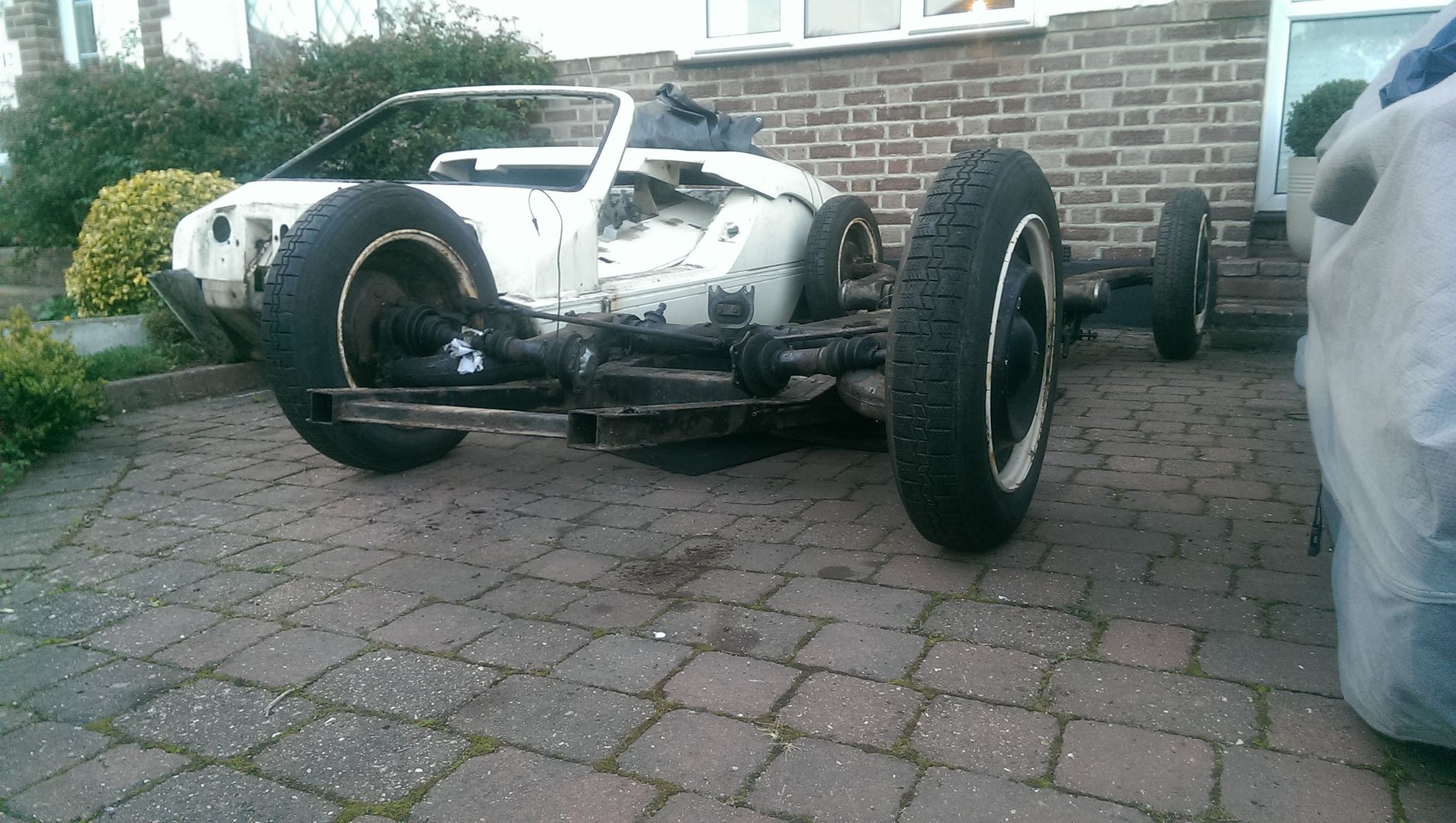

I did not worked out the lines but removing windscreen and part of rear body the sammio shell should them just fit on top without too much troubles
I separated chassis from the body during the weekend. Chassis has a few rusty points but the main rails seem to be ok

Hello everyone,
Worked on the car yesterday and managed to remove the engine, gear box and a few suspensions parts.
I hope to keep the car this low knowing that a few modifications will be required (front arms. probably sammio shell etc).
For now parts under tarpaulins. Again!!!
