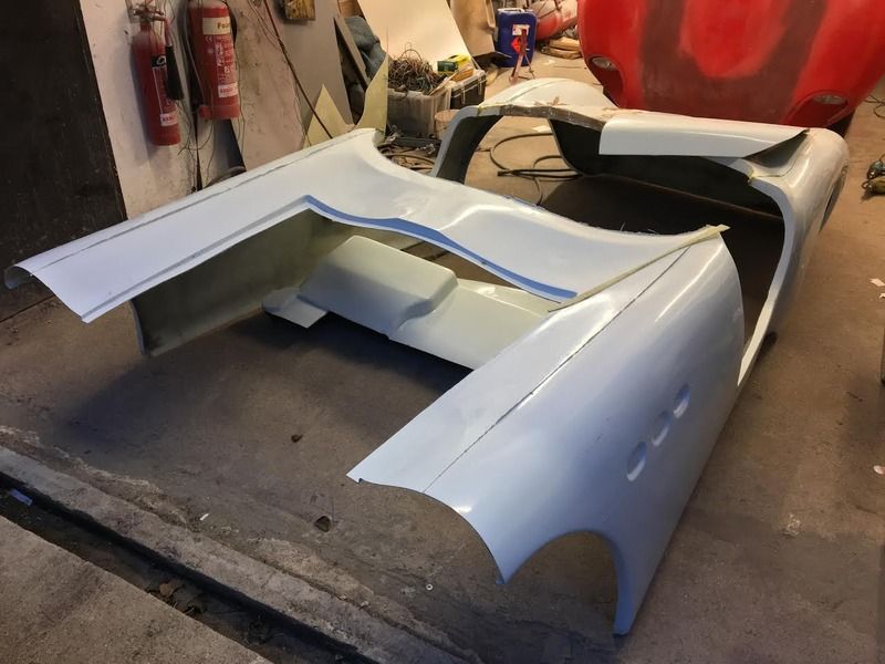

I took delivery of my starting point this morning ...A 2/3 section of a Miglia Speedster with single door skins , no bonnet , no dash and no headrest and a Cordite bulkhead section.
I'm going to glass the doorskins in place to re-cut door apertures once the rear wings have been modified and made symmetrical , correcting the cockpit and door length issues as well ....the body is going to be widened slightly and rear wings plumped up a bit in the process .. Headrest will be added after and a separate bootlid ....
Bulkhead will be a permanent fixture and a flip front created from a re-vamped Z300 bonnet with altered grille aperture and modified to flip like a D type leaving the lower rear section of the front wing in place ...portholes will be removed and a vent put in their place ...

I found myself free for a few hours today , so made a start on the new body.
I have decided to keep the cockpit position the same as the S*mmio , avoiding the need to move the bulkhead , pedals , stretch steering and gearstick etc...The original concept work well , so why change it ?
The bonnet will be stretched back to the screenline to give it a longer look on the front without changing too much . The nose will be slightly longer than a S*mmio helping give a long nose look too .
I'm starting with a Miglia / Cordite body so I need to move the cockpit a bit but as the car is going to be a few inches wider and I am changing the cowl area and cockpit shape , moving the cockpit is not too bad a job ...
I have started on the pass. side rear wing and rear deck area ...the arch is being modified to give it a lower top lip and a slightly less round shape compared to the original ...The rear wing has been split along the flash line and the rear pulled out a few inches to take the pinched tail look away ...

I have started to fit the rear centre section of a D type to the rear as well , as I want to take the flatter rear panel look away and give this car a more curvaceous rear to match my intentions at the front a bit more ...It will need to be tied into the rear wings with a gentle , flowing curve ...

Took a trip over to Tribute today and rummaged through their scrap 'glass pile for some bits and pieces ....Thank you Chris....so will put a few hours in to the car again tomorrow and hopefully get the rear corner and rear deck a bit closer to looking something handy .....
18th November 2016, 18:31
With the help of my mate , Glan , we got a bit more done this week ..a bit more work on the rear wing and rump area ...I really like the way we have fattened up the rear and given the rear end more of a curve ..We are concentrating on one side at a time ..

I have also re-cut the door aperture , removing the Cordite-like dogleg and shortening the door height a few inches , as I want a deeper sill area for the inner framework I have planned ..the front section of the body has been moved out an inch and the sill is starting to be re-shaped to join the rear section and lose the area where the body tucks in just in front of rear wing ...
https://s17.postimg.org/d9wfole7z/side.jpg

This pic probably shows the door aperture a bit better ...new lower section created in foam skinned with fibreglass to give us a solid base to add filler to ...I have , today , added a similar amount of material to the front and rear upright shuts too by fibreglassing them and they wil be shaped up and filled to blend .. the idea is to have about a 3'' door shut , giving enough material to house a decent depth of door as well somewhere to bolt through into the frame and house a latch mech. as well ..
https://s22.postimg.org/7fblq3vsx/doorsill.jpg
The pic also shows the straighter sill line that now doesnt tuck into the rear arch anymore ...

Here's some pics of a bit of work that Glan did on the car today ...
As the rear pass. wing is nearly finished and at a stage it could be patterned ...Glan has made some slice patterns and we transferred them to the otherside , so the drivers rear wing could be cut and moved outwards the same amount. About 10mm needs to be added to its height as well .
We also made the 3mm hardboard spacers that will give us an even 3mm gap around the new door panels .....
This picture also shows the slice pattern that will duplicate the rump curve to the drivers side too ....
24th November 2016, 21:49
Glan had a day on the car today ... he cut the Miglia door to fit our new aperture and gapped it with the 3mm hardboard pieces I cut out for him ..The doors have a flat spot on the top , not as flat as the original S*mmio , but still flatter than I want on this body re-vamp ..so Glan has tweaked them and bogged them up to have a much more appropriate roll to them from top to bottom ...I decided I didn't want the door to end at the cockpit edge without any detail ...so a slightly raised radius has been introduced to that edge ..I'll take some pics tomorrow ...and the sides of the cockpit now have a curve to them when viewed from , front , rear or above as opposed to the straight sides on the originals ....pictures will show it better than I can describe ...
I found a few hours to glass , foam and fill the drivers side rear valance area and make a start for Glan to shape it up using the slice patterns ...hopefully tomorrow should see the rear wing sections shaped up a bit and I want to find the time to re-position the rear arch and reshape it on the drivers side to match whats been done on the opposite rear wing ...
