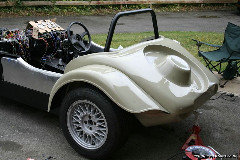

I spent a long time looking at photos of finished sportster. The one thing that I noticed on a few was the front to back positioning of the wing was a bit off, best thing to so it put something between the wheels and the wings and then move it around until the wheels sit nicely with the flow of the wing. The other thing I saw on a few was that the wing was too high up, I guess the spring height helps adjust that. I suppose in the end it's personal preference, I spent many hours eyeing this up and I think it's pretty close to what I think is the right place to put them:

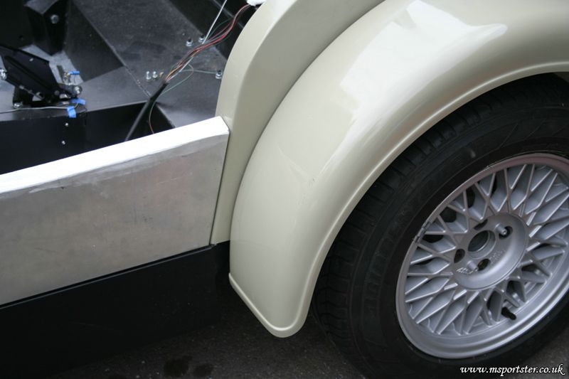

Yeah - I took a long look at you guys photos (Patrick, Robin & Peter), and this is where mine ended up this afternoon:
It's awkward trying to get pics of them in the garage, I'll get some better ones next time I have her out on the drive.
It took a long time getting them equidistant from the doors, and parallel to each other and the tub - but I think I got there in the end.
The nut plates I made up work a treat. :)
19 Jul 2009, 11:22pm
looks great in the photos, spot on I'd say :D
