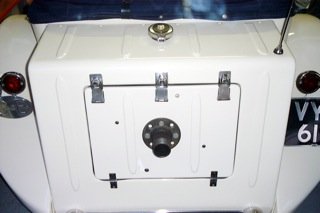

The only problem is that the filler cap (Aston type) is mounted on top so I can't get up that high with the vent pipe. I can get within an inch though and the nozzle will be below that. I am unlikely ever to fill it to the brim though. Do you reckon I should be OK?

Should be OK by my reckoning and I would have to overfill the tank which is unlikely on my budget! Any thoughts on flexible filler pipe?
This attachment isn't my car but shows the position of the filler cap.
