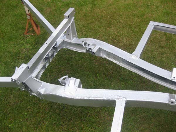

17 Sep 2011, 2:04pm
Thank you for the interesting views above - they echo my feelings exactly.
Just a before:
And after:
View of my chassis for anyone who is interested.
Thanks
Chris
17 Sep 2011, 6:09pm
Hey, that looks pretty good!
Are the pictures in bare metal after blasting or is there some kind of coating?

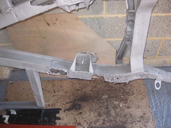

OK, doesn't look too bad from this distance.
Ahh, a few issues arising.
Hmm, should you really be able to see through the chassis?
And this is what was keeping the driver's feet off the M25.

17 Sep 2011, 10:17pm
Mister Towed,
My before picture is after I had the chassis blasted back to bare metal and the patches removed.
The after photo is following weld repair, seam sealer, POR15 undercoat and Sterling Silver POr15 topcoat.
Chris
