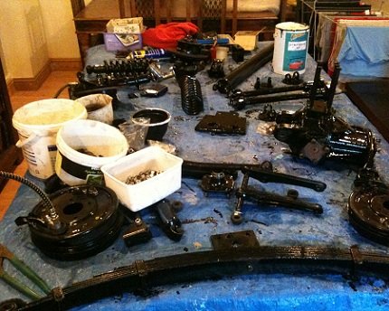

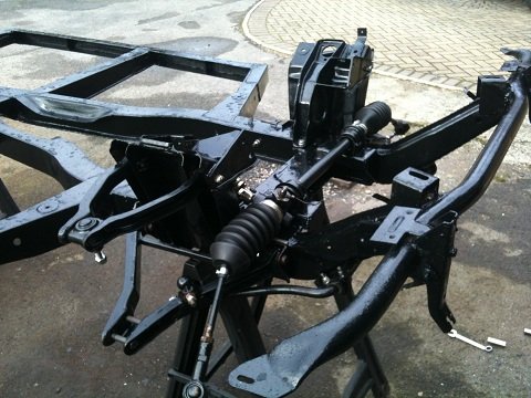

4 Mar 2012, 6:35pm
well, i managed to get some bits on the chassis, so the front suspension is starting to get there.
I also got the front and rear brakes together and got the diff and propshaft cleaned and painted. I am replacing the UJ's in both the rear axles and the propshaft, as they are cheap enough to do and there was a little play in one on the propshaft.
My pool table now looks like this... :eusa_shifty:
So I am on target to get the chassis rolling by next weekend, and I will then get onto the frame and floor.
