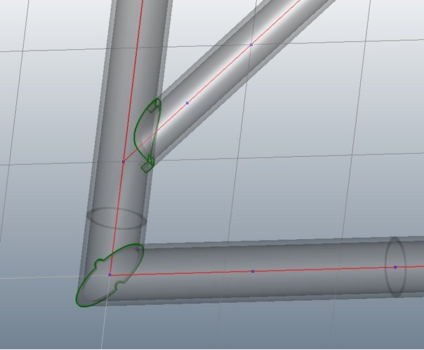

All connections of the tubes are calculated by the software is such a way that they fit on their exact location.
This is done by adding possition helpers (pins and holes) to the tubes which interlock.

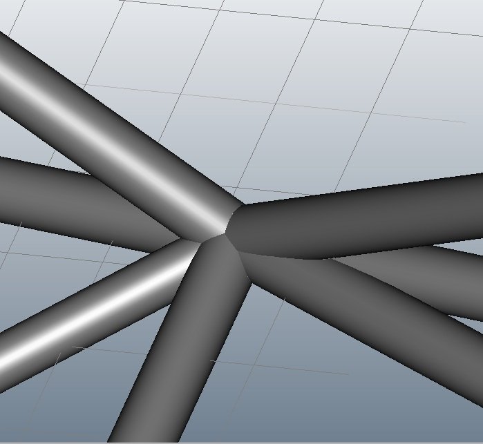

And especially round tube is very nice, because it calculates the exact fitment of the tubes by cutting out a fish mouth.
It looks like this:

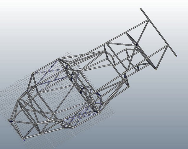

These are 2 pictures of a Le Mans winning Group C racer:
