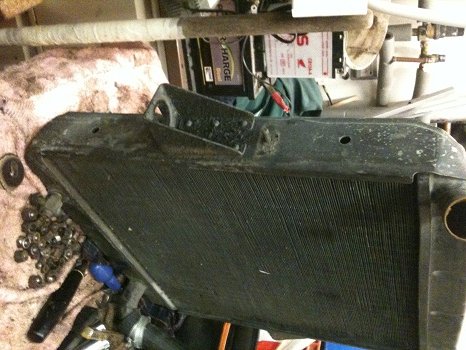

My number 1 idea is to use the original Vitesse radiator and lower the mountings by drilling out the rivets and reconnecting further up the radiator, thus lowering it. I am not sure how that will work out with the pipework and exisiting pulley mounted fan, but I will have to wait and see. Unless anyone else has a brill idea I can copy/steal/imitate. Best idea wins a beer at the great Sammio informal not-an-owners-club bash! :biggrin:
9 Mar 2012, 4:29pm
I ended up moving the original brackets up a bit. But rather than drilling them out, i cut off the protruding bits with a 1mm cutting disk and then welded the bits i'd cut off back on higher up.
The way i cut them i left the parts with the rivets on the radiator as it gave me something substantial to weld them back on to.
I then used spacing washers to fine tune the final position.
It worked for me, but I'm sure there are other options :ranger:

I've finally got some pics of my modified Vitesse rad for reference.
Please excuse the general untidiness of my under-bonnet (especially compared to some on here!) as tidying up the engine is next winters job!
But you should be able to see what a std rad looks like lowered and how little room there is with it all back together with the 2L 6.
16 Mar 2012, 3:28pm
Thanks Dave, that is brilliant info, and gives me something to go on now. I really want to use the original radiator so I can keep the period look, even under the bonnet.
I can see where you re-welded the mounting brackets on, so how much clearance does that give you to the bonnet now?
