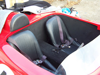

Here's how mine are progressing -
They're about as big as you can get in the Sammio cockpit and give a very comfortable, and low driving position, which is what I wanted. :)

Towed ....really liking the way your car is sitting now..stance looks great , seating position is bang on too.....

Thanks Gary. I was a bit worried I might have lowered it too much but now I've trial fitted the body I reckon I can get away with it. It's got three cut down top leaves under the 80mm lowering block, which has some box-section welded into it for extra strength btw, giving 98mm of lowering on the back. I cut the front springs down by 95mm to match. That's as far as you can go on the front without major modification as you have to put both the 'rubber' shims on top of the shock tower rather than one each side or the spring doesn't seat properly (hope that makes sense).
The seats are great and I reckon you could mount them on a flat floor and still not sit too high. That would also allow you to mount them further inboard (so long as you fitted a low-profile prop tunnel) which would give you more shoulder room at the sides. Having been out in Phil Jacklin's BRG 2.5 litre car (awesome!), where you sit at about the same level as mine, there's no problem with 'wind rush' past your ears. The wind deflector does what it says on the tin.
Oh, and apologies for the seriously scary expression on the latest pictures but I've just finished a run of weekend late shifts and my 'Feck off home now or else' expression that works so well on drunken idiots seems to have got stuck on my face... :mod: :party: :mod:

Lowered pans and the right seats make a huge difference to the driving position and overall look of the car.
I made my own using phenolic coated ply and fibreglass -
It took me about three full days and cost around £70 in materials. Then, just in the nick of too late, Gary announces his at £90 a pair.
Spot the difference :(
They look like pretty good value to me and will take the driving position from this -
To this -
It might not look much but it makes a big difference to the amount of exposure your skull gets to the elements. :party:
