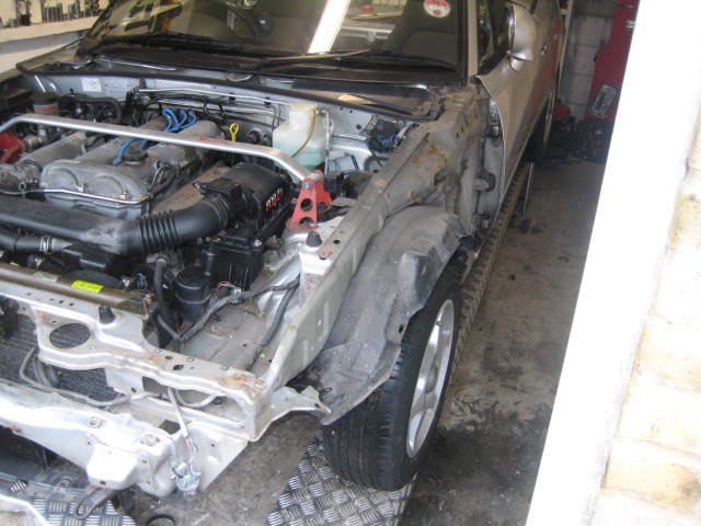

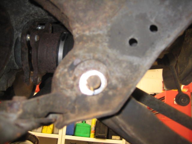

Hopefully some pictures of the donor will now appear. Done it direct from the computer as still just getting error messages when trying url's.
12 Nov 2012, 2:46pm
Looks like a tidy car, you should make a fair bit on the removed parts :-D

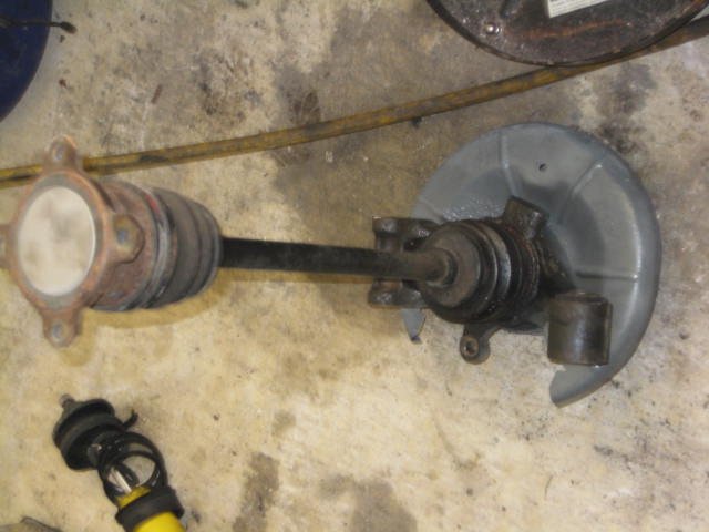

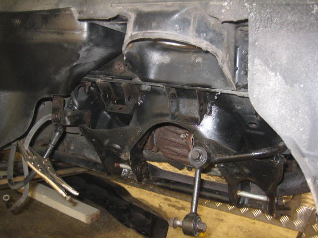

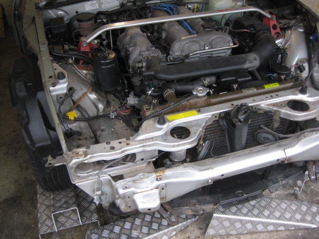

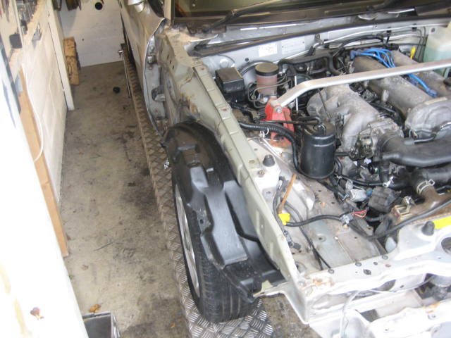

Managed some time in the garage this afternoon, and on inspection of the underframe and suspension have decided to strip and refurbish brakes and most of the suspension, as the original shocks are past it (not sure how it got through an MOT 2 weeks ago.) i think i will go for a set of adjustable coil overs.
As I have a bit of time think I will underseal the car and straighten out the chassis rail which has had more impact.
couple of pic's of progress.
Attachment “IMG_0033.JPG” from the original forum could not be reliably recovered.
Attachment “IMG_0034.JPG” from the original forum could not be reliably recovered.

Cat7 wrote:
Was amazed how simply the MX is screwed together, although have some drilling and tapping to do on the m8 and m10 bolts that hold the wings on the base of the sill.
A very normal problem that we have found with all the MX5's we have done. It's because the water draining from the scuttle area runs down behind the wings, the MX5 has few faults but this is one of them. Looks like a great base car :happy:

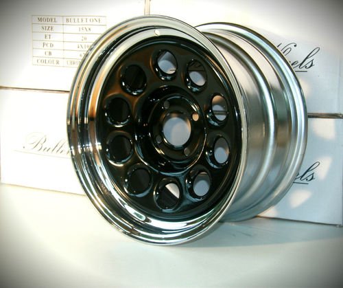

What do you think of these?
12 Nov 2012, 8:00pm
Cat7 wrote:
Chris, Your a star. Many thanks. My night is mapped out trawling the internet.
Very nice. 15"? Do you have any offset (ET) and width info on them so I can check if they will need spacers or not.
Are they the same as:
http://classifieds.pistonheads.com/c...-mattig/907752
That Nick put in a tread last night?
12 Nov 2012, 8:11pm
Bullet wheels
Chris n the following
15x7, 4x100 PCD, ET20
15x8, 4x100 PCD, ET20
15x8, 4x100 PCD, ET5
was thinking of 15x8 on rear and 15x7 on the front. Do you think that would work? :ranger:
Nev
Yes. Plus a 1" spacer on the rear.

12 Nov 2012, 9:25pm
spacer
Guys,
would that be the ET20 offset requiring the 1" spacer?
being a tad thick me feels... :frusty:
12 Nov 2012, 9:29pm
Cat7 wrote:
Guys,
Nick?
