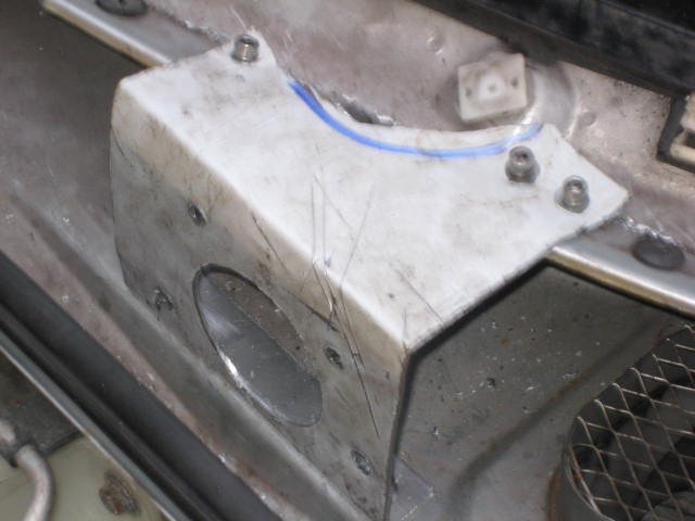

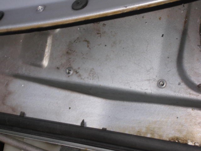

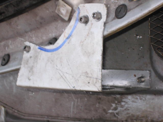

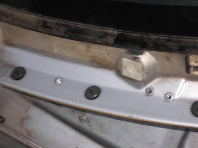

Started relocating wiper motor
Started relocating wiper motor today, so a few pictures of how I am intending to achieve it.
Intention is to move the spindles to the centre of the windscreen, similar to Chris's demo car but utilizing the Mazda equipment.
By placing the motor in a transposed position the direction of the motor changes.
You can also remove the rubber boot from the control rod and remove the plastic bearing, fit this the other way around and the rod is in the correct orientation to re-connect to the motor.
I will have to shorten the control rod and alter the length of the wiper wheel box arm, but it will take some experimenting. The offside wiper wheel box will also be relocated towards the centre of the windscreen.
Potentially each wiper will have a differant sweep length, so some experimenting will be in order.
If anyone else is interested I can make some templates of the changes.
