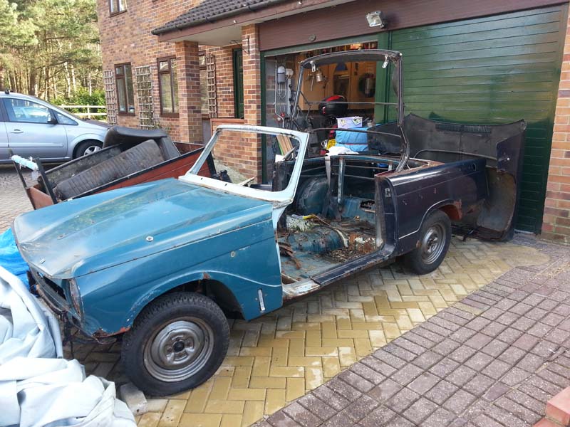

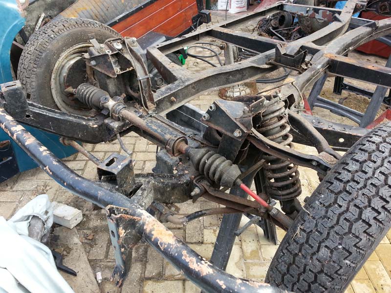

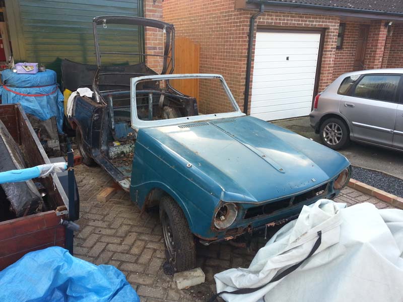

This is the sorry donor, bought from ebay for £205 as a part finished restoration!

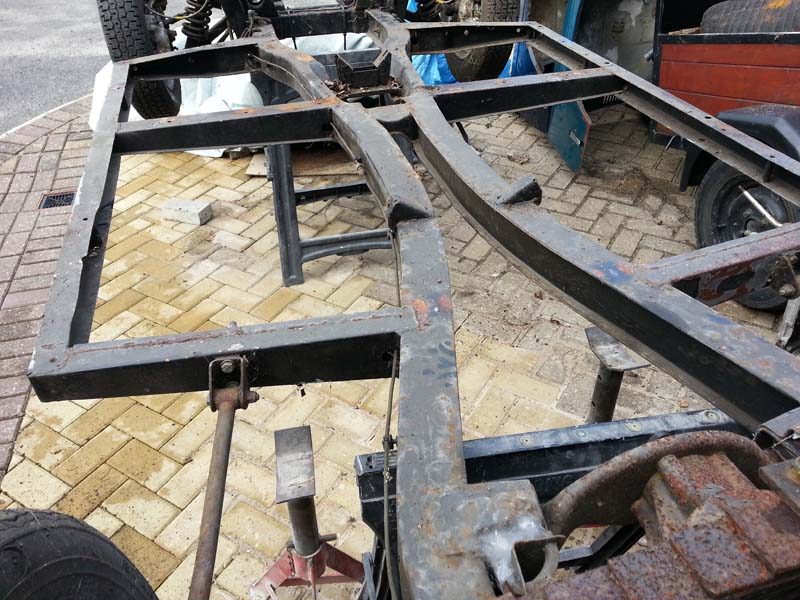

The nice thing about it (if there is one..) is that the chassis underwent a rebuild so everything was new - but that was about 6 years ago, and it was stood since then...
It will need a full strip and rebuild again, but has some nice touches like stainless steel brake hoses and a really good chassis that won't need any welding!! :eusa_clap:

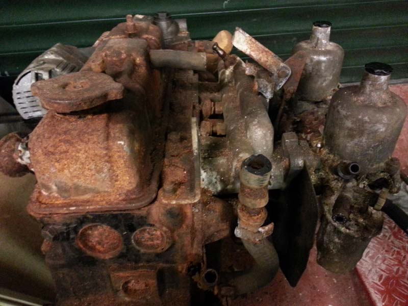

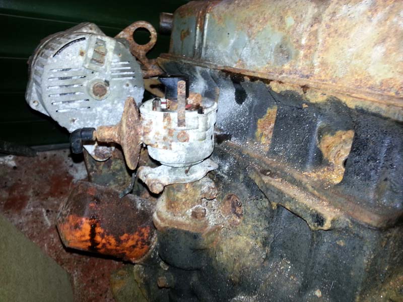

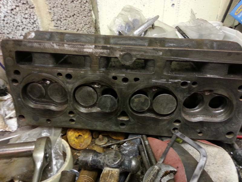

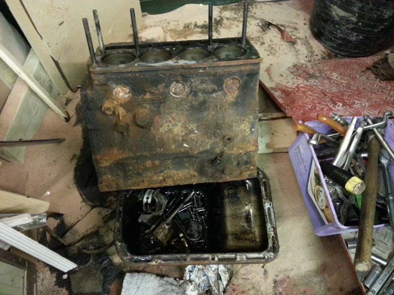

the 1300 engine was not in a great condition though and so I have bought an even more sorry 1500 MG Midget engine....
When I started stripping it down, and got rid of all the corroded ancilliaries, the actual block and head were in great condition - I reckon it had a rebuild, with new bearings and piston rings etc only a few thousand miles before it was taken out and stored for 3-4 years...
The mains are 0.010 u/s so it had the crank reground and the big ends are std size. No wear on the crank or bearings so I reckon a spruce up , rebuild and some new bits (distributor, alternator, water pump etc) it should be lovely in the miglia speester.

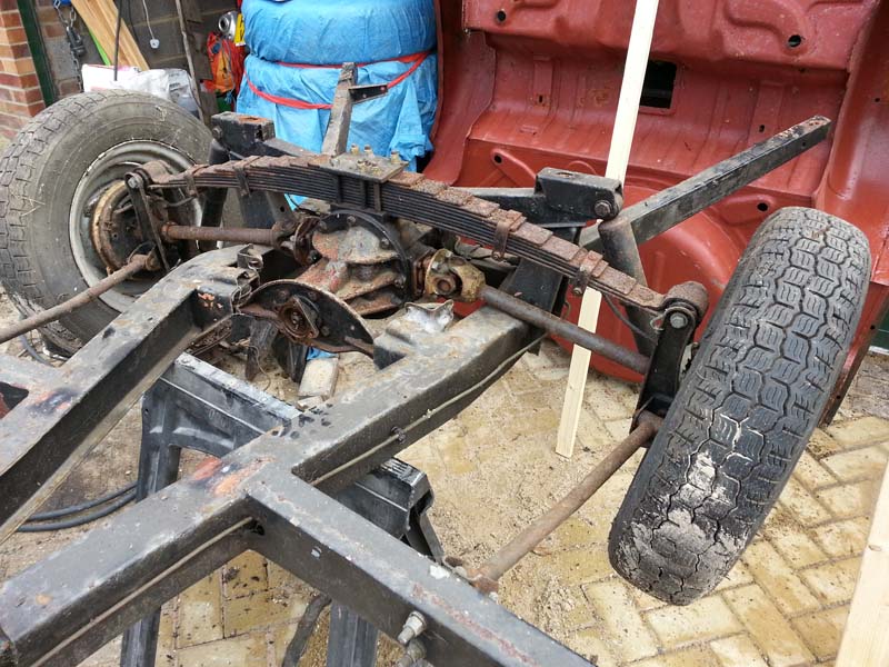

err, the whole chassis - new everything - but then they parked it up under a tarpaulin for 6 years or so! The rear brake drums and front calipers still had the paper protection and labels on them!
Pity, as it will need a complete stripdown again but at least all the bolts should come off fine! Will repalce the rubber bushes with silicone ones as well while I am at it.

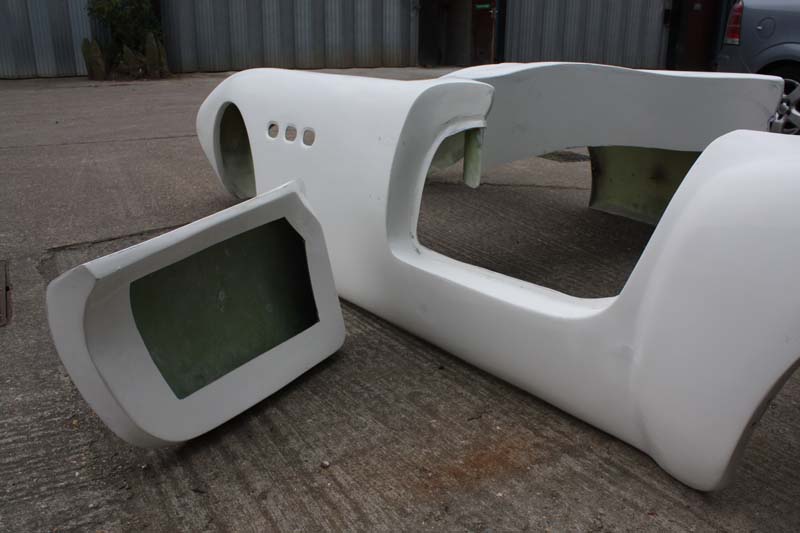

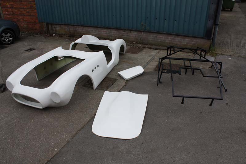

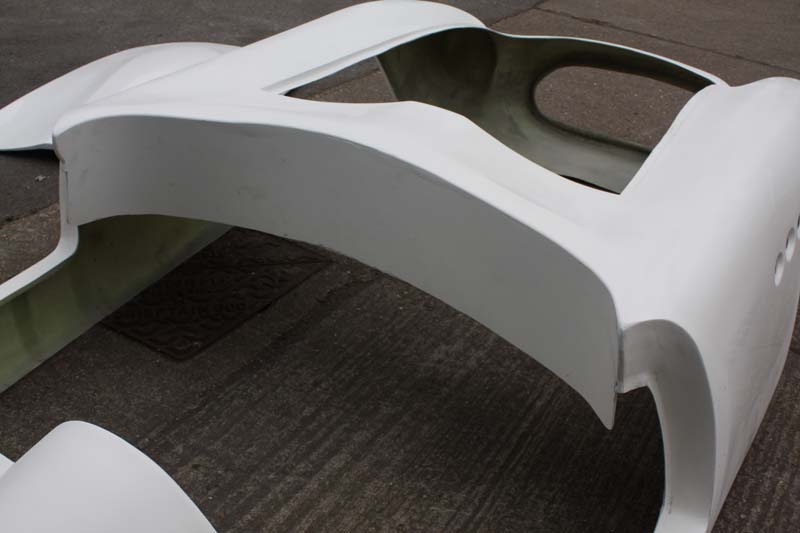

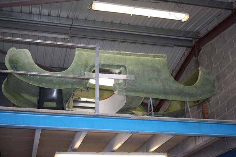

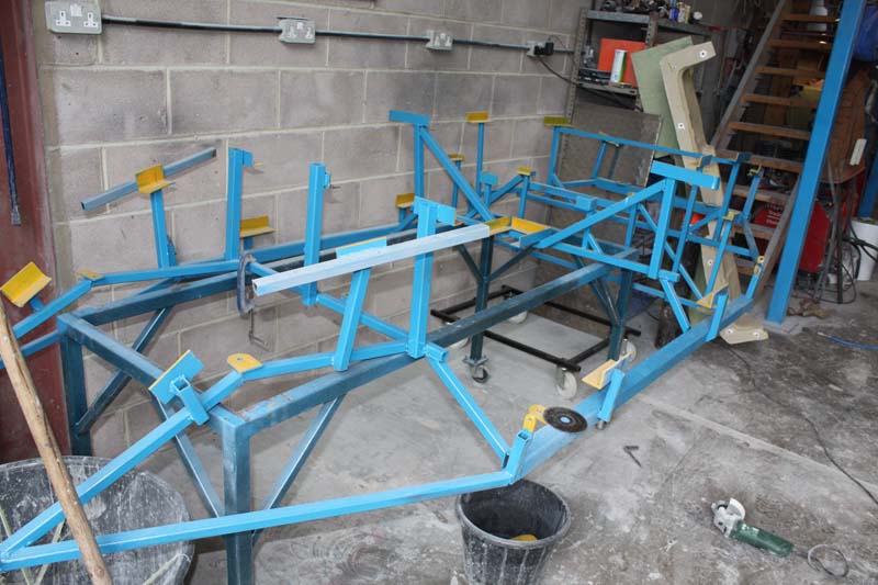

Went down to see Mike at Miglia today and saw the first kit roll off the production line.....

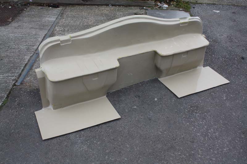

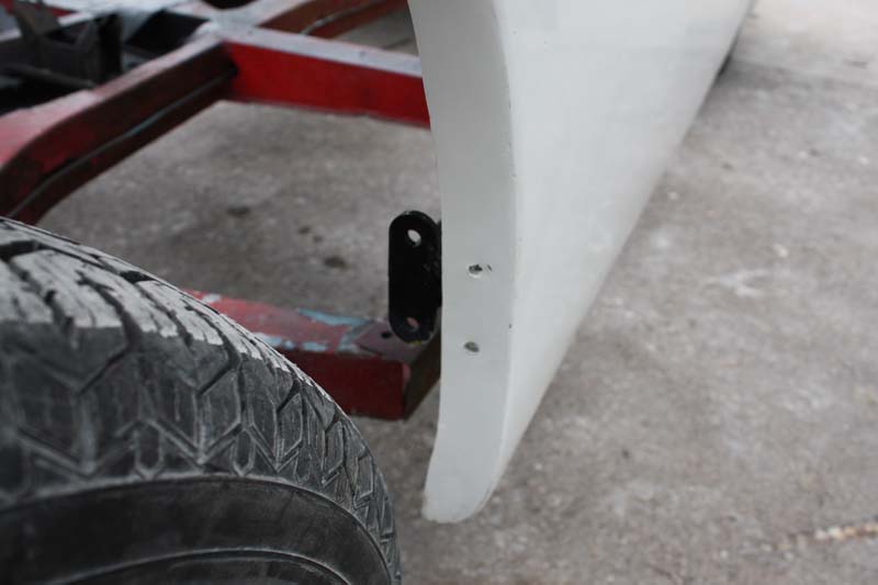

I didn't fully appreciate the amount of work that has gone into this. The dashboard is actually part of the body ...
The door shuts are finished nicely, and the doors are pretty weighty items that should close with a nice thud! Even the bolt holes for early mini door hinges are moulded in so you can't drill then wrong! Nice attention to detail.
Another little "feature" is that the frame bolts to the chassis, and then the body is mounted, like the Sammio/Ribble kits, but this time, the body has mounting points so you can't get it misaligned.. nice! :eusa_dance: No more faffing with the bonnet gaps and door gaps this time!
Also, I didn't appreciate that the front end is significantly longer than the Sammio I built, meaning that the front bumper corners on the chassis won't need to 'fall off', and there is lots of room to put a choice of radiator and mountings in there.
And because the body is one piece, the frame comes right to the front and adds additional support. No more bonnet flexing or adding in additional strengthening. I am hoping for a quick build so all this helps a lot, having gone through the long-winded sammio route first time.
Oh, and you get a front bulkhead as well and this is set back from where the original is so you get around 8-10" extra room at the front in the engine bay - ideal for my BMW servo I have planned. The flat bits at the font cover the front outriggers, and is where I will be mounting the battery so it is accessible, but out of the way, again no more worrying about a lowered battery tray!
So really impressed with the set up - even the jig for making the frames is a work of art!

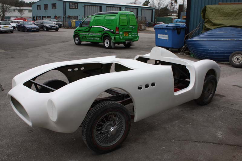

And here's the next kit underway...(hopefully mine :pray: )
So all in all I can't wait to get mine started now! :icon_cool:

There are some lovely touches in there, looks like Mike really learned from some of the interesting "quirks" of the Sammio!
2 Mar 2013, 6:56pm
Nice to see you today, im glad you like the kit. Ive tried to make it , so the customer enjoys building their Miglia kit. I forgot to mention the kit also comes with the new longer bolts , so you will be able to fit the frame and body. This should only take an hour to fit too :icon_cool: .

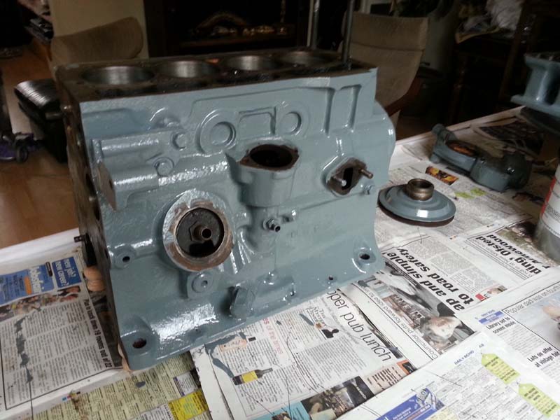

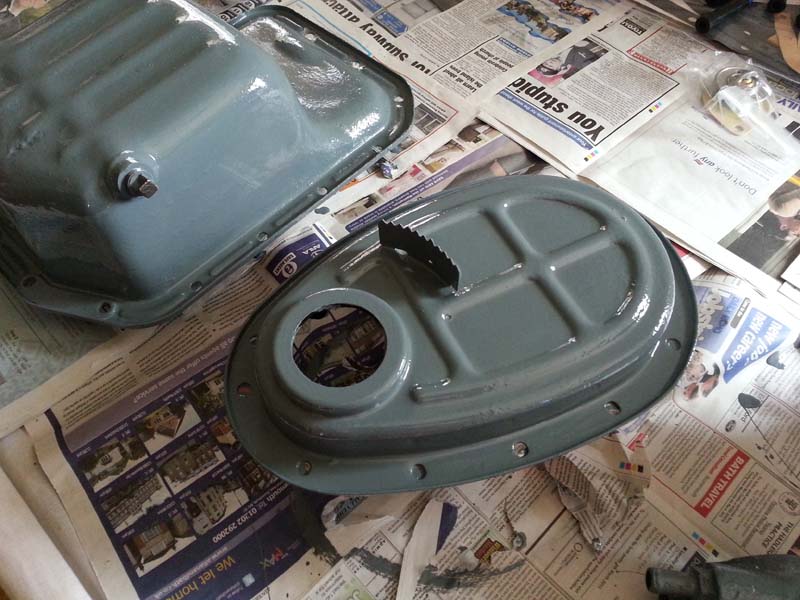

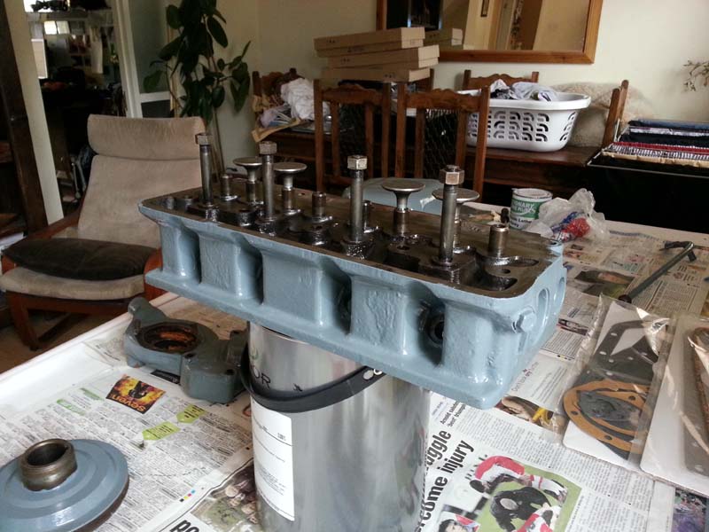

I got bored with a black engine, so I went for a colour that was going to look period....
from rusty old engine to shiny enallemed one...
(yes, I know the valves are in the wrong way round! :laugh: )

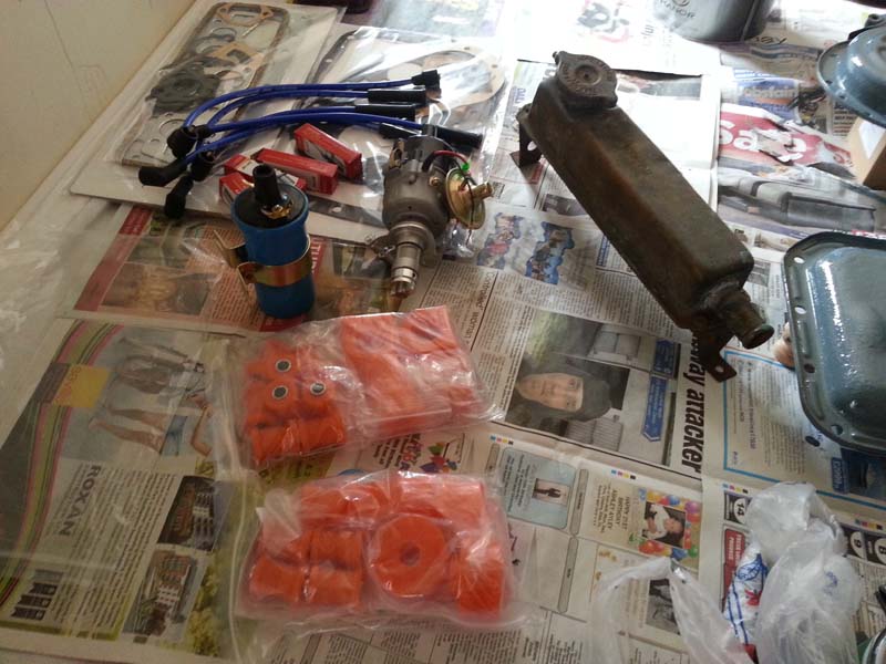

Also got some new and old bits for the build.... Early Vitesse 1600 Header tank which I loved on my old sammio, poly bushes for the chassis and a full accuspark distributer and electronic ignition kit with plugs, leads and blue coil...

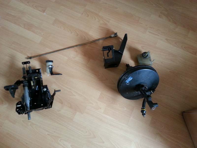

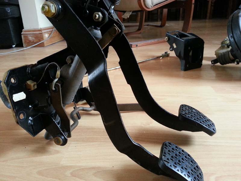

And this is my BMW e30 pedal set complete with servo...

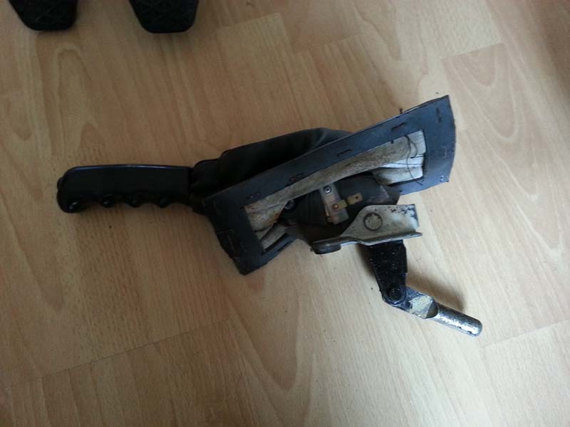

and my TR7 handbrake that has convenient flat mounts and just needs an appropriate nut welded to the cable end so it fits the herald standard handbrake cable (same as I had on my Sammio)

3 Mar 2013, 3:44pm
Looks good Tony, looks like dove grey ? What paint did you use .
3 Mar 2013, 4:12pm
it's Harrison Lathe blue/Grey actually :icon_cool:
It's 0.5litres from ebay - a company called Stationary Engine Parts.
Engine enamel, good and tough and a whole range of colours, heat and oil resistant.
