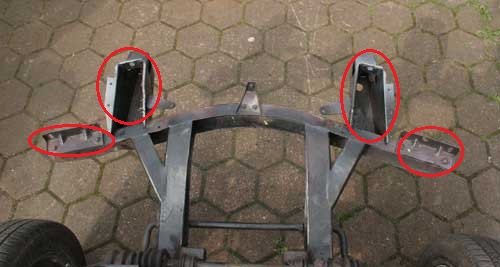

I seem to remember reading somewhere that some of the original spitfire chassis is redundant on the front end, can somebody let me know what is removed, i have added an image and circled in red the parts i think may be not required, any help appreciated.

Once you've bonded on the body and got it through the rebody inspection (whatever form that take now???), just lay the bonnet over the engine and cut off what gets in the way. It really is as simple as that. :)
20 Apr 2014, 9:02am
Thanks Mister Towed, so what i pick up here is to leave alone until the inspection has been approved other wise there may be problems.
20 Apr 2014, 9:11am
The rule of thumb is that to qualify for a rebody instead of the onerous iva the body needs to be fitted to the original, unaltered chassis. You can add or move brackets but you can't shorten it, so to be on the safe side it's best to leave the front bumper brackets alone (or the boot outriggers on a Herald/Vitesse chassis). Once the rebody inspection is completed, you can do what you like with it so that's the time to get busy with the angle grinder. Good luck fitting your bonnet, just use your imagination and I'm sure you'll come up with a suitable bracket arrangement, even if it takes a few goes... :frusty:

Andy with a navigator kit what on th front end is not required in my photo?
23 Apr 2014, 3:11pm
Hi. None of the ringed areas are needed for the Navigator bonnet hinge. We usually weld a small bracket just inboard of the outer longitudinal member and marry it with a bonded bracket on the bonnet.
