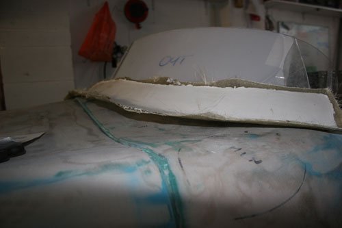

11 May 2015, 8:12pm
Photo as promised of the fiberglass screen surround, you can see the fit is not the best, that's why i suggest you make your to suit your car.
12 May 2015, 7:13pm
Thanks Swifty, I see what you mean, it do's look naff. I think I will call on a friend who works with s/s and see what he thinks.
