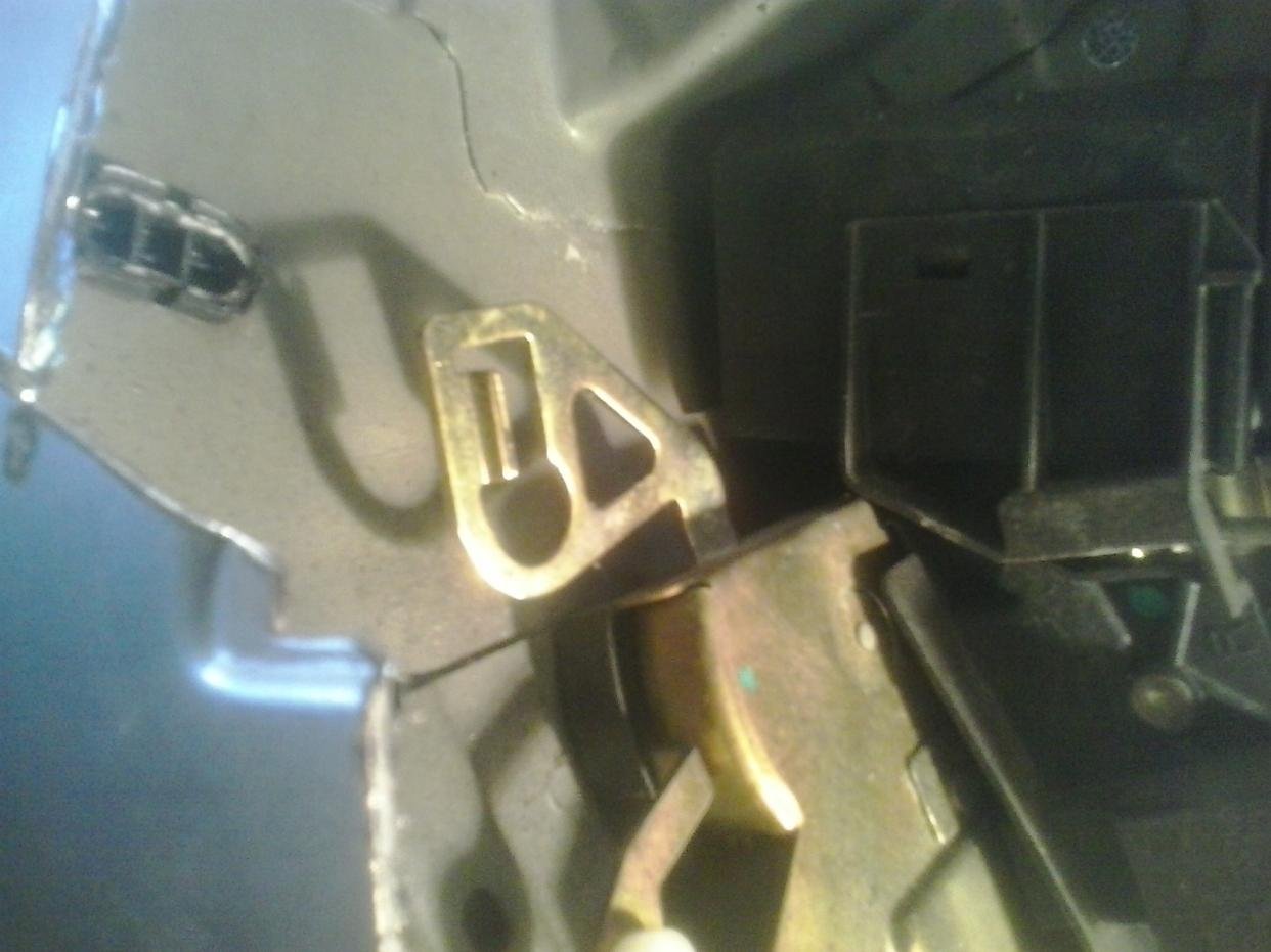

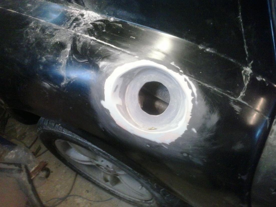

today I mocked up the door handles so they will now open with the alfa handles and I also fitted the petrol filler tube ready dose need a bit of trimming down a bit

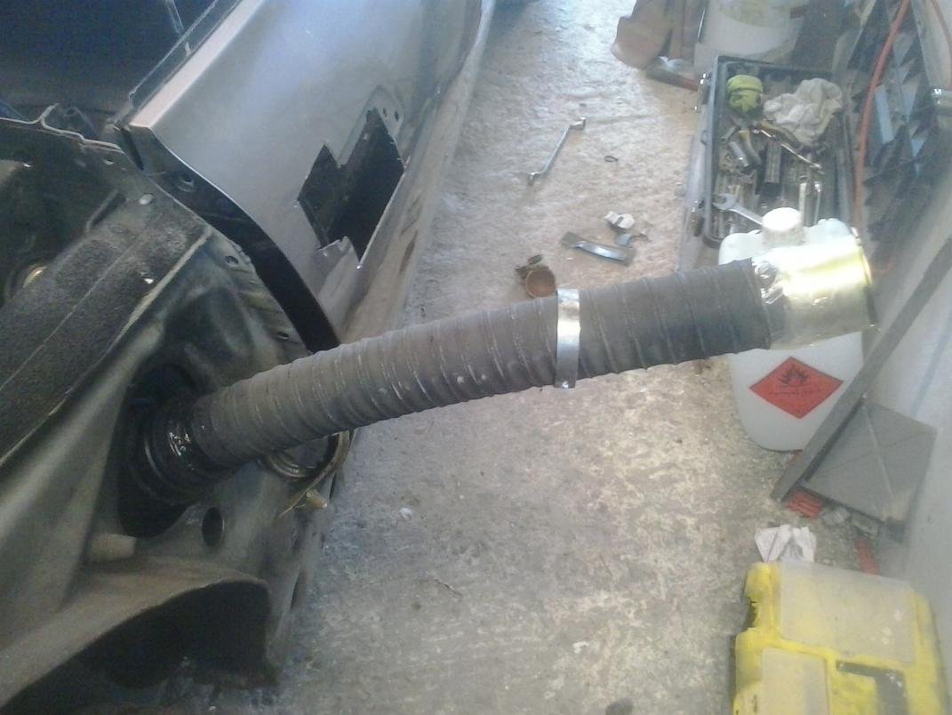

Fuel pipe
Hi Andy
Hope the build is going well, I have just started my z3 tribute cobra build and want to do the same as you ( extending the fuel pipe ), any chance you could let me know what diameter flexible pipe i should look for + how did you fix it to the tank end.
Thanks
Wolfie
1 Jun 2015, 1:17pm
hi the pipe is Ultra Flexible Fuel Filler Hose 51mm (2") - FFF51 form car builder solutions, if you take the top off the filler hose on the car its fixed on with 4 lugs around the top. bit of prizing with a screw driver and all the filler mount will come out the tube. the new tube is a snug fit down the inside of the pipe and I fixed /sealed it with PU18 High Strength Polyurethane Adhesive & Sealant and a large jubilee clip off ebay . it worked well for me . good luck with your build andy

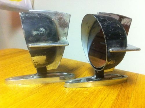

that sounds like it would be one nice build, for now I am going rat look dune the well polished look and its not for me. got some well nice parts arriving from all over the place my mirrors and headlight covers have just got here from the states
give you a idea of the look I am going for old school all the way

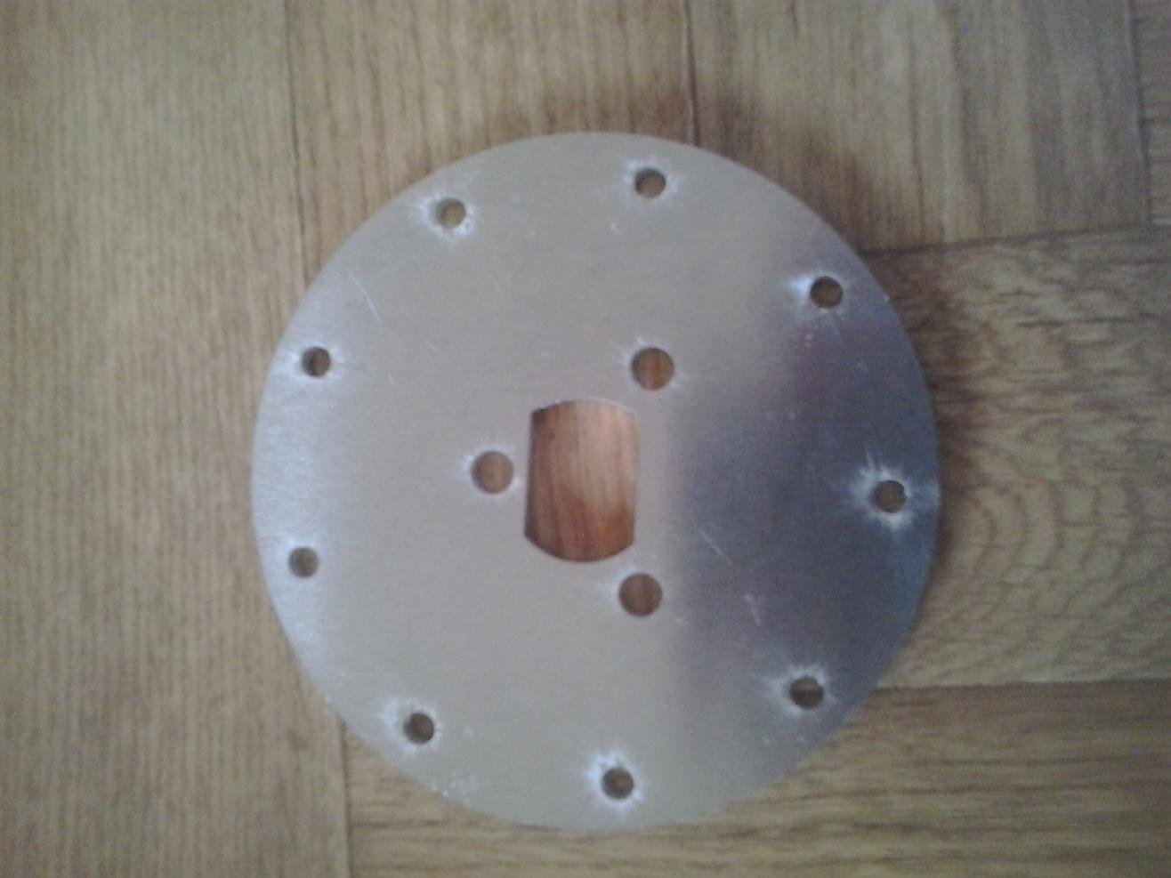

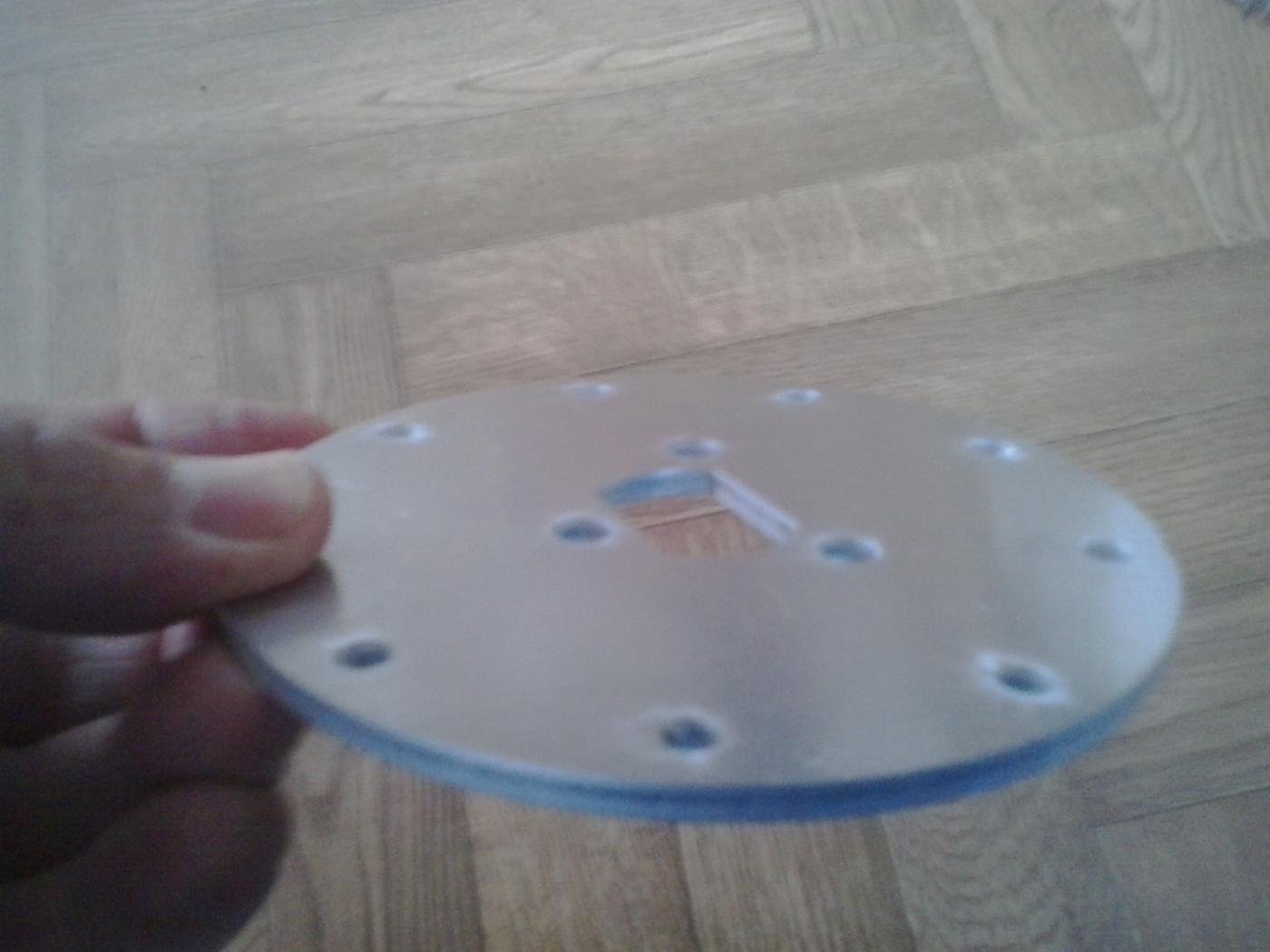

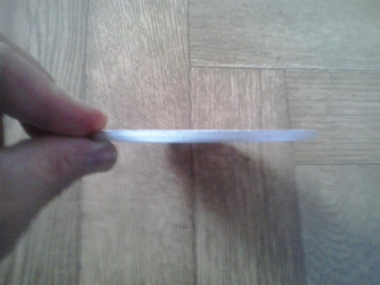

steering wheel boss adapter
just got this
from http://www.ecas2cvparts.co.uk £20 with delivery perfect fit for my steering wheel it will now bolt onto the smaller size boss.

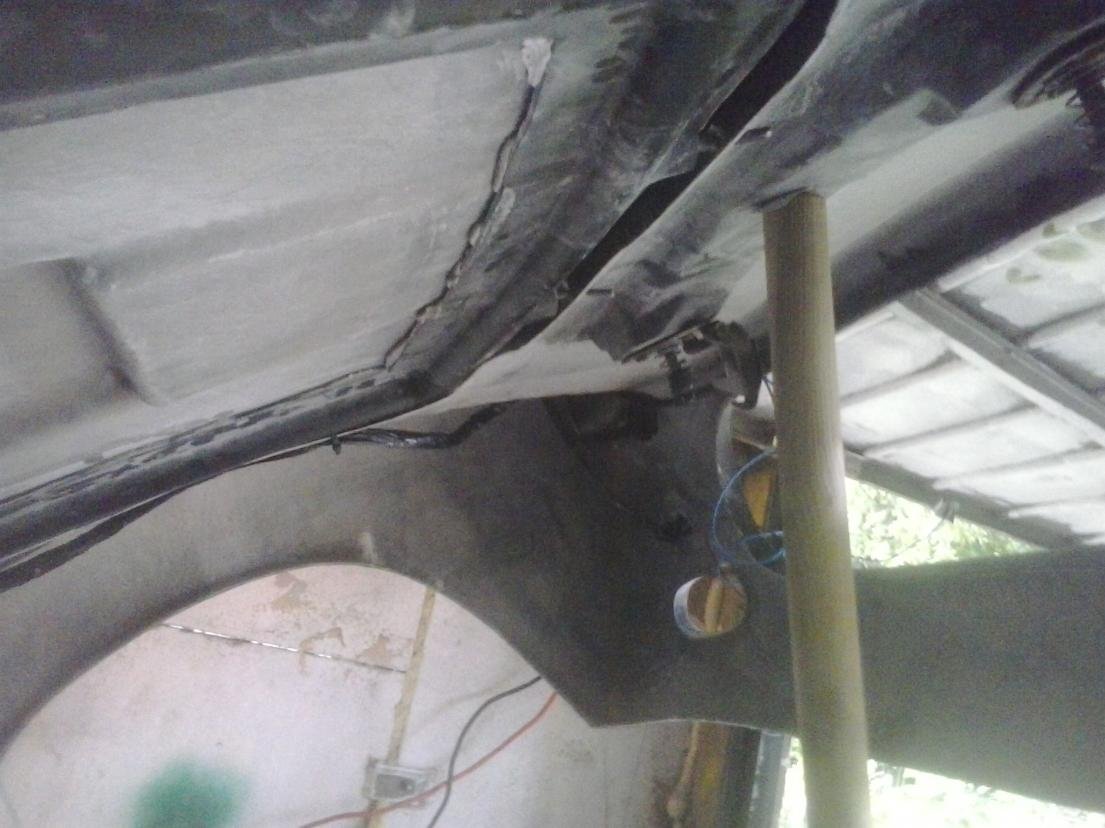

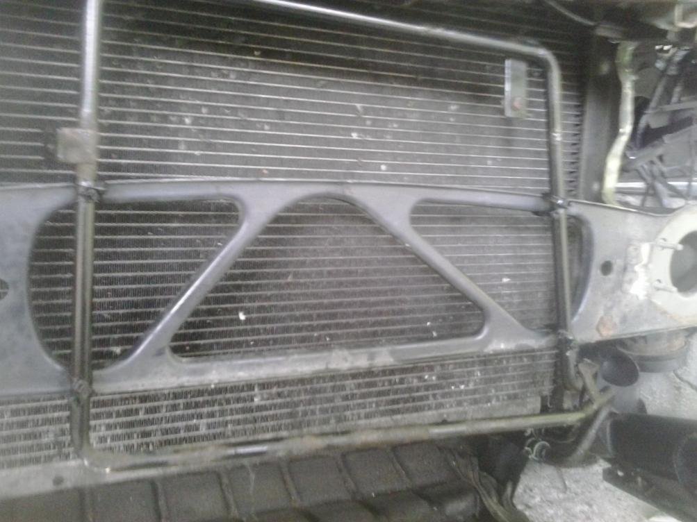

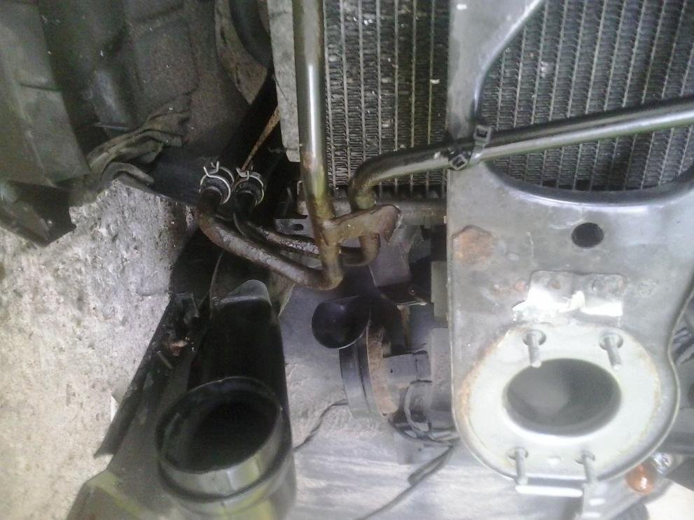

kit arrived Thursday so had a few hours on it since then front of the car now striped with the crash bar removed. oil cooler rubber pipes trimmed back prob about 3 inch to allow the cooler to be fixed to the slam panel.
main body of car fitted Friday loads of clamps and a tin of risen on the top for a good measure,left overnight to set.

Good luck with the build! I'm nervous about cutting oil pipes, is that 100% necessary, or just something you wanted to do to re-position the cooler? Good to see that kit can be delivered, saves a long trip to Devon :thumb:

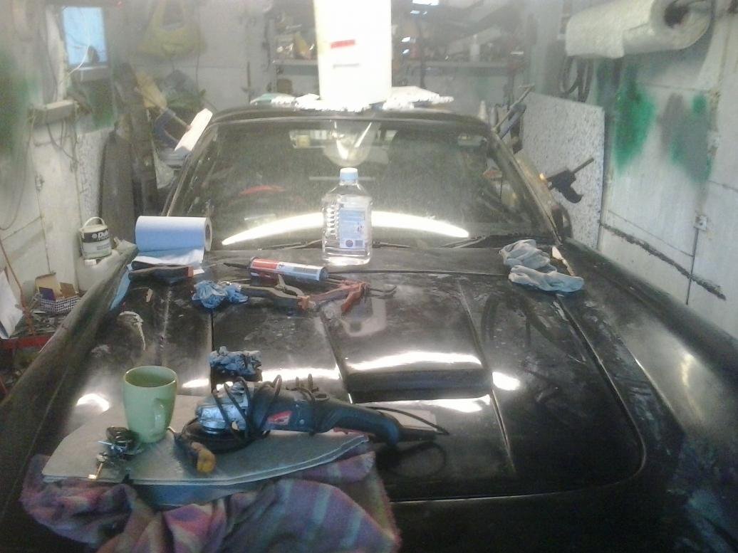

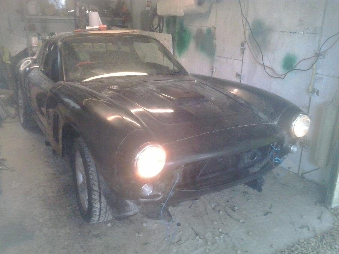

lights fitted and wired
had all Saturday fitting and wiring the lights up, the back is just short on the original so all the wiring needs to be extended by 6 inch. The front is a mare you need to release the radiator from the top and pull all the wiring back. starting at the drivers headlight make a new loom to run around the inside of the bonnet and the splice it into the original wiring loom it takes ages to do.
Trial fitted the boot on the hinges the gaps are spot on so things mus be well lined up.

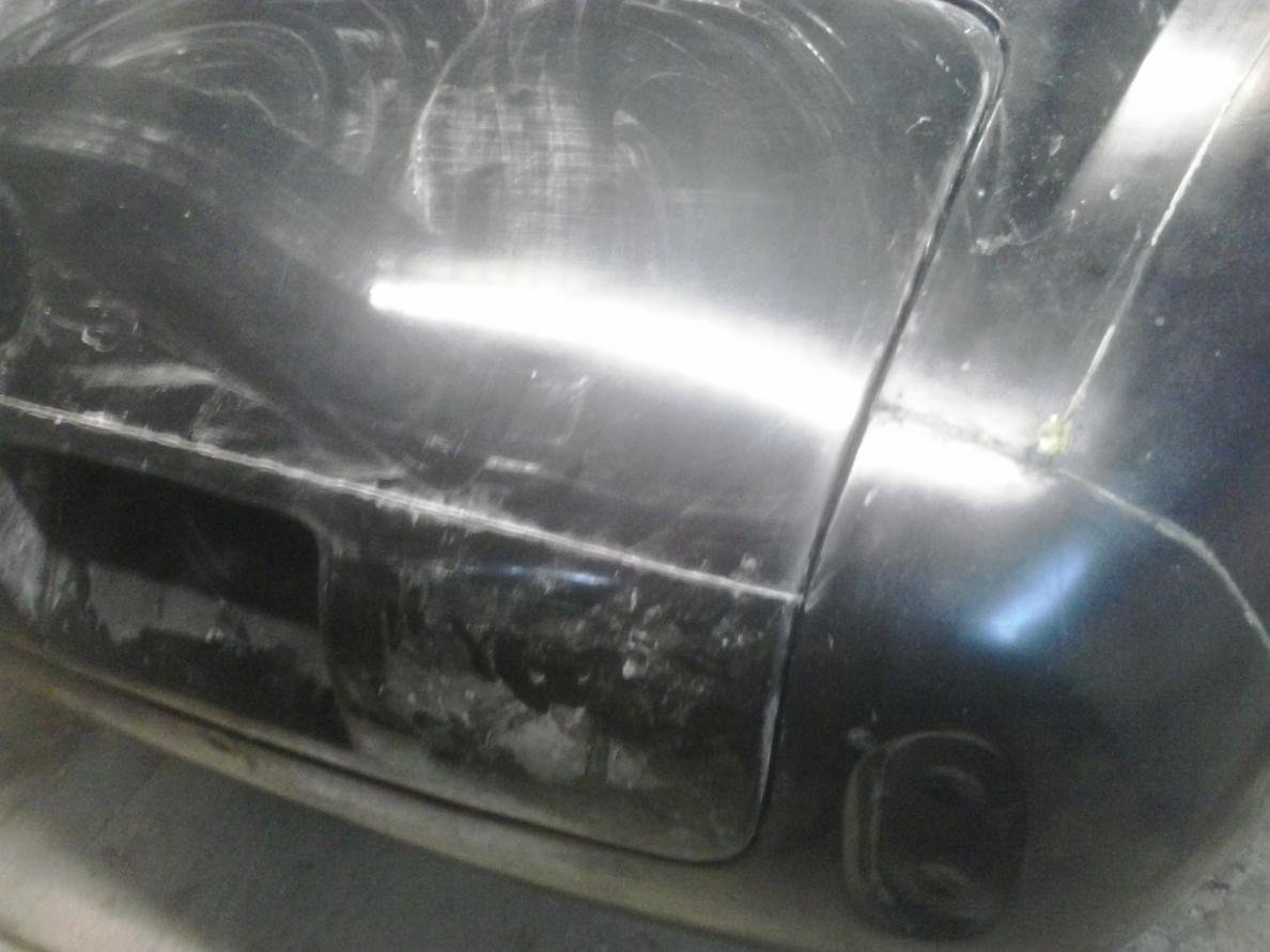

petrol recess cut out and bonded on need just a bit more filler then patch the paint.
next job look at getting the doors bonded on and sorted if it ever stops raining my ducks were happy this morning if nothing else

The oil cooler sits to far forward so it has to be moved back, its only for the power steering so don't fret over it get a clean empty tub pull a pipe off and drain it then you can put it back in when you have trimmed the rubber pipes.

I have tried a good long internet search, does anyone know if you can run without the cooler loop?
14 Jun 2015, 7:20pm
its a ten min job to move it back if its there its got to be needed. I did not run mine until it was all refitted and filled back up

Have you tackled the door handles yet, I have some Alfa 156 handles which I will try

you just need to take off the two air scoops for want of a better word one each side of the rad top to bottom. if you look at the picture of ware the bumper bar was bolted on you can make out I have cut steel off top and bottom I have gone alfa handles they worked on the mock up just need to try them with the door skin on

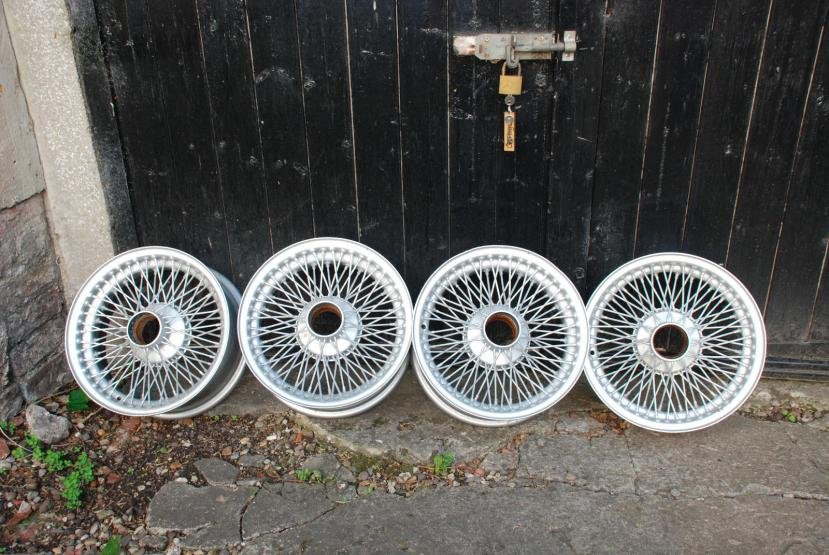

different wheels again
god how many types of wheels are on the market, can not say I'm a lover of wire wheels but they do belong on this car so new purchases 7.5j x 15 jag wheels fully reconditioned and powder coated £130 quid just need the hub adapters info anyone WCA one for you
