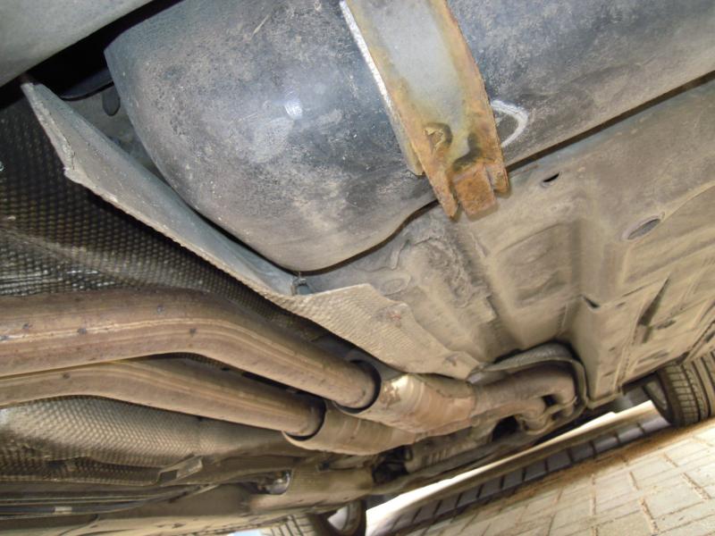

Ive got a 2.8 z3 and it has 2 pipes from the cat but then goes into 1 rear backbox.
12 Jun 2015, 4:48pm
Z3M exhaust......
won't fit, since the Z3M has NO sparewheel area and all others do....
So you need to get rid of the sparewheel area, weld in a solid plate, use heatshielding from another Z-3 (if you want it to be the same on both sides) and make your own custom exhaust...
Thats what i did....

Hi,
That's great, exactly what I need to do exhaust wise, please can you provide any underside pics? and I like the sound of 17" Chrome wires on hubs, would you be able to tell me where did you got them from and how much?

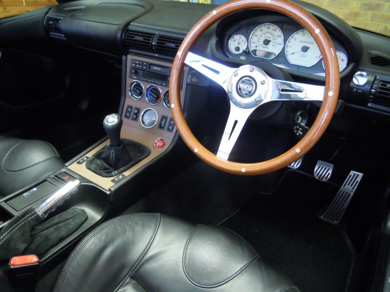

Wheels, steering wheel and exhaust
Please see attached pics
Note; the tyre on the rim was just for showing the height of the tyre, I use 245/55-17 on the rear and 225/55-17 front

Thanks for images, that looks like a left hand drive though from the steering wheel, love the wheels, where did you source them from the US?
12 Jun 2015, 6:43pm
My steering wheel is already on, chrome look stereo in the post and dash mounted internal mirror will finish it all off:
12 Jun 2015, 6:45pm
I had the wheels made in China
