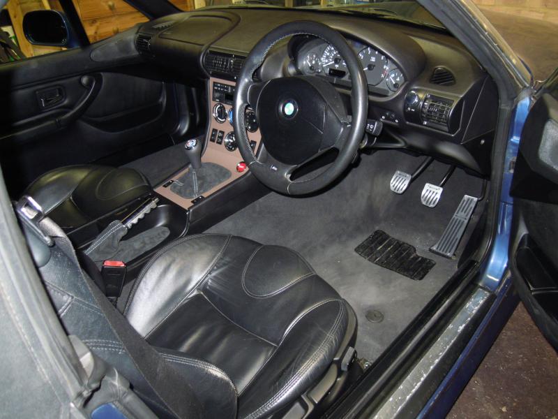

I thought I would share the preparation of my Z3 interior.
I have on order the 250 SWB convertible kit from Tribute and whilst I wait for it to arrive (Due before Aug, fingers crossed) iv'e decided to strip my old very dark n plasticy interior down and try and create an older look in anticipation of the kit being applied later. Any how on with the show. Here is what it was when I got it:

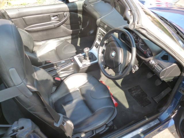

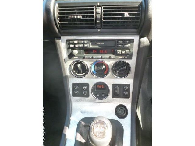

Stock interior, I think with Chrome pack installed but the central console look like someone had scoured it with a brillo pad (Showing my age!)

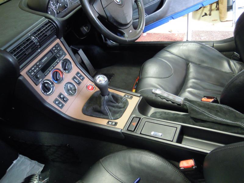

The gear knob had a distressed look and had to go, I replaced it with an Alpina one reason being as when i took the old one off found that it is back illuminated (the original one I had didn't work, so had no idea until I removed it and found 2 wires). Its any easy replacement, literally pulls off and push fit.

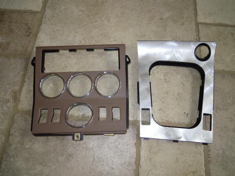

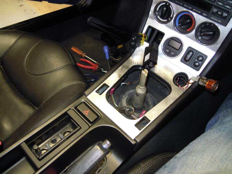

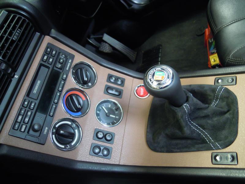

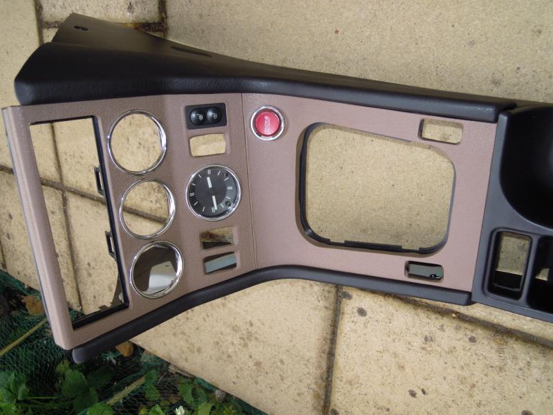

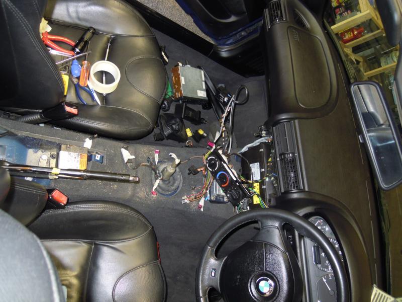

I also thought while I was at it I should take the centre console out and cover that awful scoured metal finish up and ordered up some leather look vinyl, went for classic brown as wanted chrome rings of clock and heater controls to have a darker background against them, pulling the centre console out was a bit of an ordeal but once you have done it once its easy to see how it all comes apart and goes back in nicely, so I labelled all the wires up as I removed the switches
and it also gave me a chance to clean out the 'crud' that gets behind the panels. So with the console off I went to work covering them
Which was pretty easy with the help of the wifes hair dryer! I bought a S2000 engine start switch and opened out the hole a little to get a good tight fit, which had to be angled to fit the switch body as its pretty long. Don't smoke so won't miss the fag lighter. Also I swapped the digital clock/computer with an analogue clock (ebay), the wires are already in and just a matter of plugging it in.

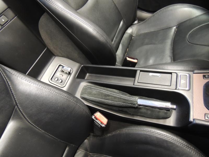

So then refitted centre console and fitted new gaiters to handbrake and gear selector (Push fit over existing fittings). Fitted new chrome hand brake handle also.
Also removed massive fire extinguisher from drivers seat....

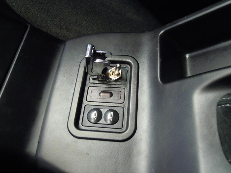

Oh and just for a bit of fun I fitted a chrome covered aircraft switch and cover to rear of console as had a blanking plate. I tell the kids its the 'ejector seat switch' for the passengers seat, but only works if the roof is down

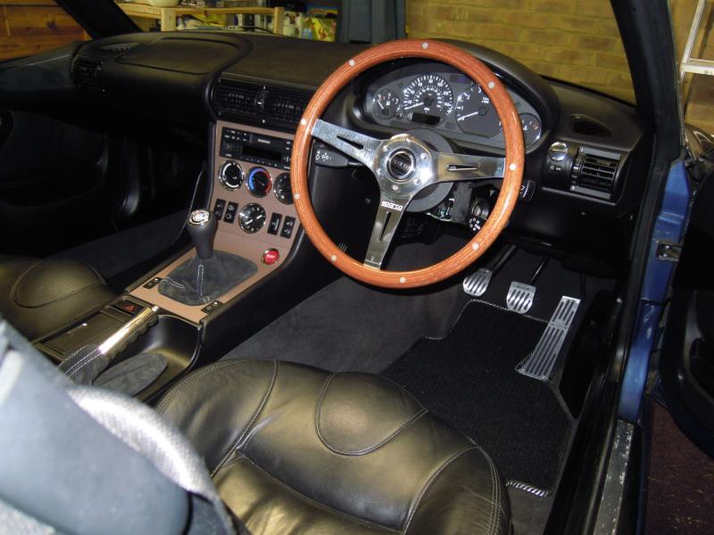

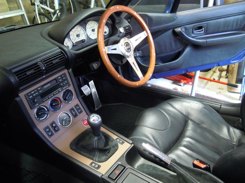

Next job was pedals, bought a set off ebay (z3 pedals), ah but they don't easily fit and had some difficulty in making them good using combination of securing to existing pedal covers and drilling into pedals directly. Overall they are secure and have had a good test and are safely secured, but it took some effort
Then got some tailored mats with silver grey twist edge and had to secure with new carpet twist grips. Then onto taking the tired M3 steering wheel off and replacing with wood and chrome one. You are advised everywhere to do this safely as not to set the airbag off, disconnecting the battery and having a few cups of tea just to make sure any residual electricity has gone before removing. I had bought a boss kit from demon tweeks and its a matter of taking the rear of the old steering wheel assembly and attaching it to the boss kit (means that the indicators will automatically turn off when turning back around a corner and also with the wiring the horn will work fine). I also had to buy some 2.2 Ohm resistors to wire into the circuit under the wheel cowling to fool the system the airbag was still there
Now this causes a problem if like me you turn on the ignition at any point without the resistors in place as the car thinks the airbag has gone off and now the airbag light on the dash is on permanently. So to get around this I bought a B600 OBD device (£15 I think) and plugged it into the port in the engine bay and cleared the code and low and behold the light works properly! yay!

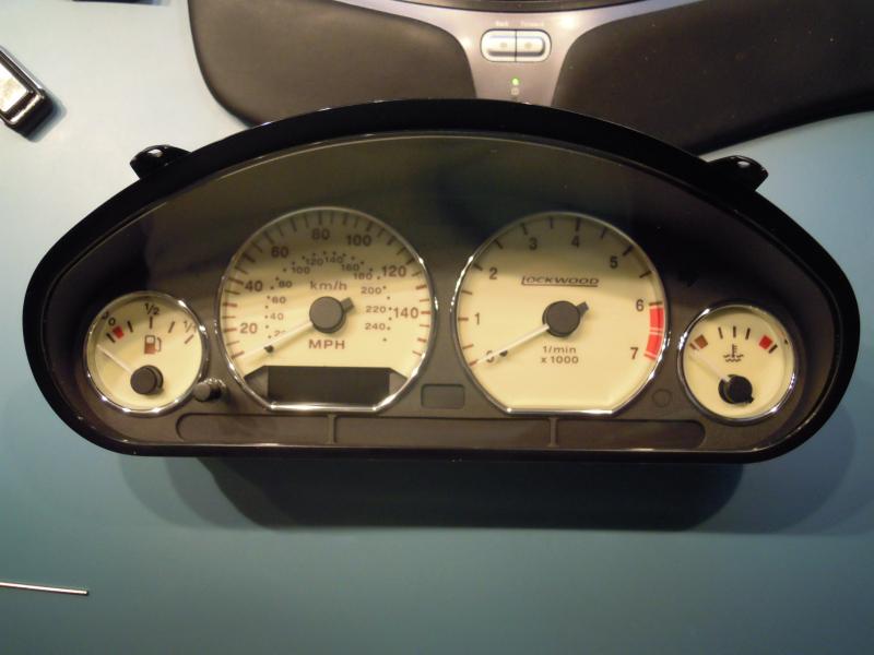

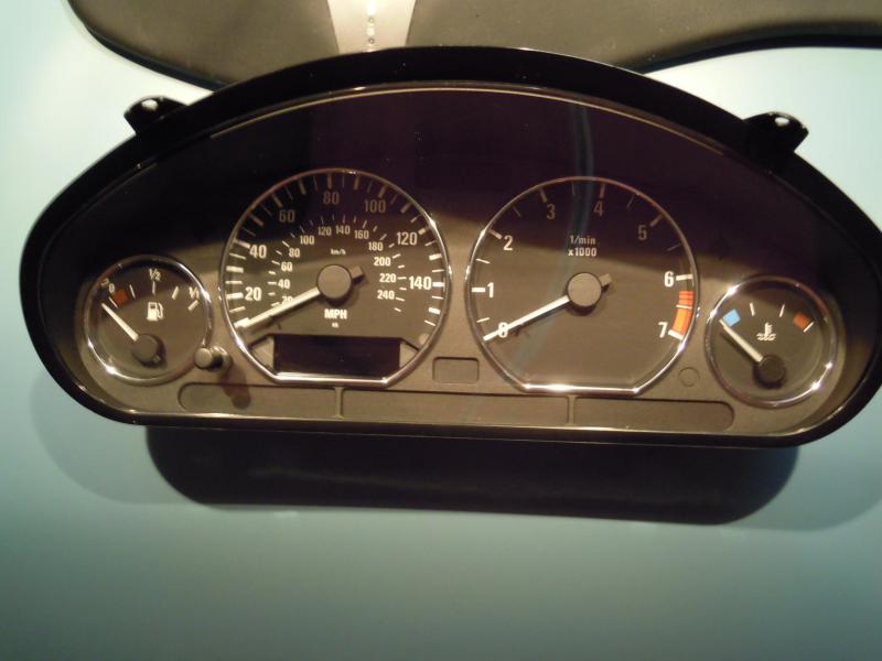

Next onto the instrument cluster
I had a choice to going for Cream or White, I went for cream as white looked too new and sporty and wanted a more classic look. Also adjusted the template sent to remove cream around oil and highbeam light in top middle, just wanted dials changed colour
So with that refitted, pretty easy with couple of screws, I had got to this stage

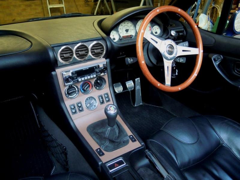

Next was a few little touches, chrome finish around centre console hazard lamp switch (push fit) and chrome effect trim around door lock pins
Then onto that rather bland looking BMW business stereo. I found a modern stereo with an old chrome look to it (classiccarstereo.com) for £110 delivered that has USB, bluetooth, SD card, flip down front for CD, etc. It was quite chunky and sticks out a bit but I am hoping with many of the other mods fitted and the old 250 kit on it will 'blend' in

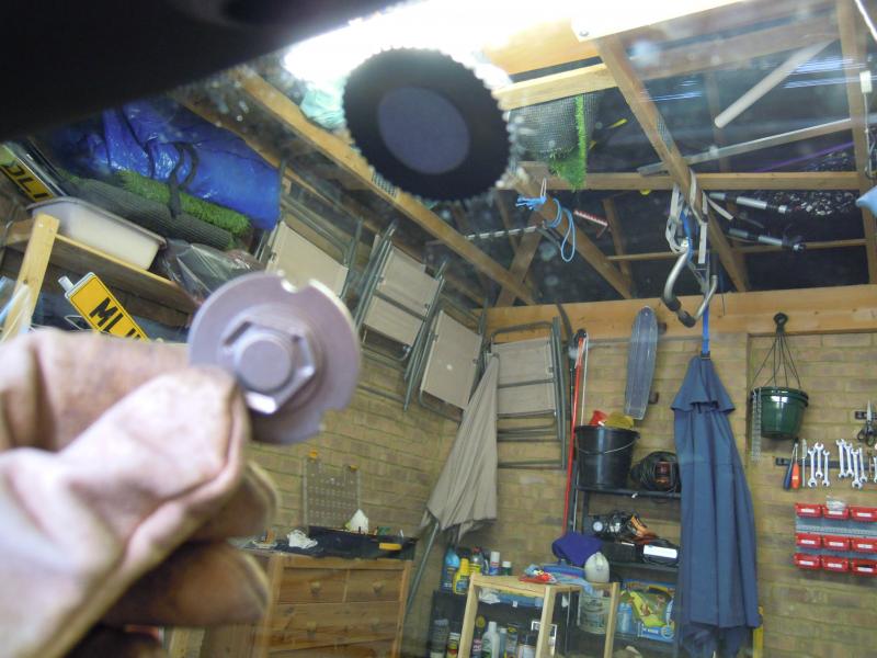

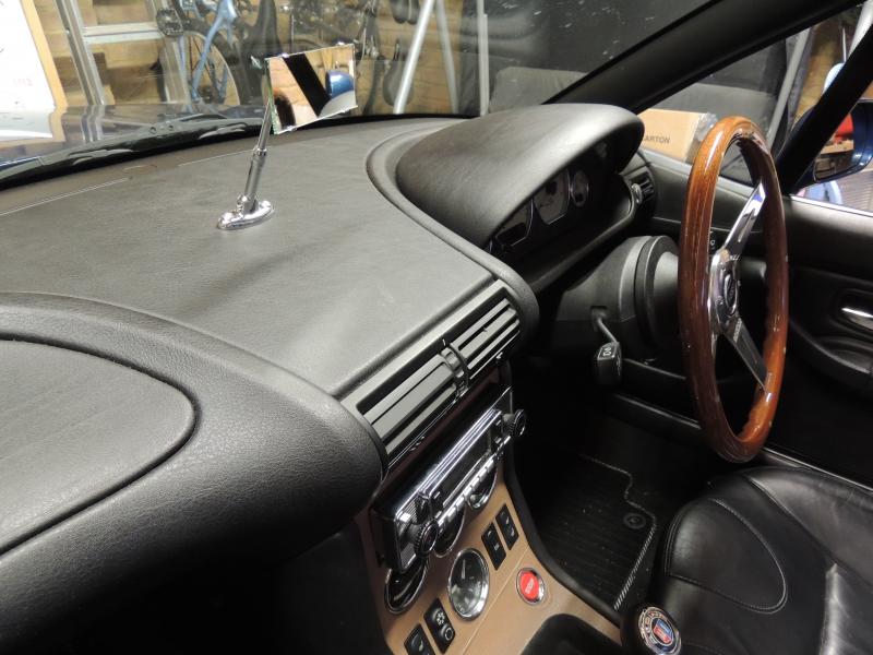

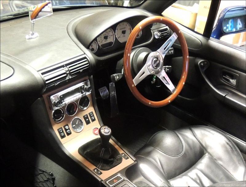

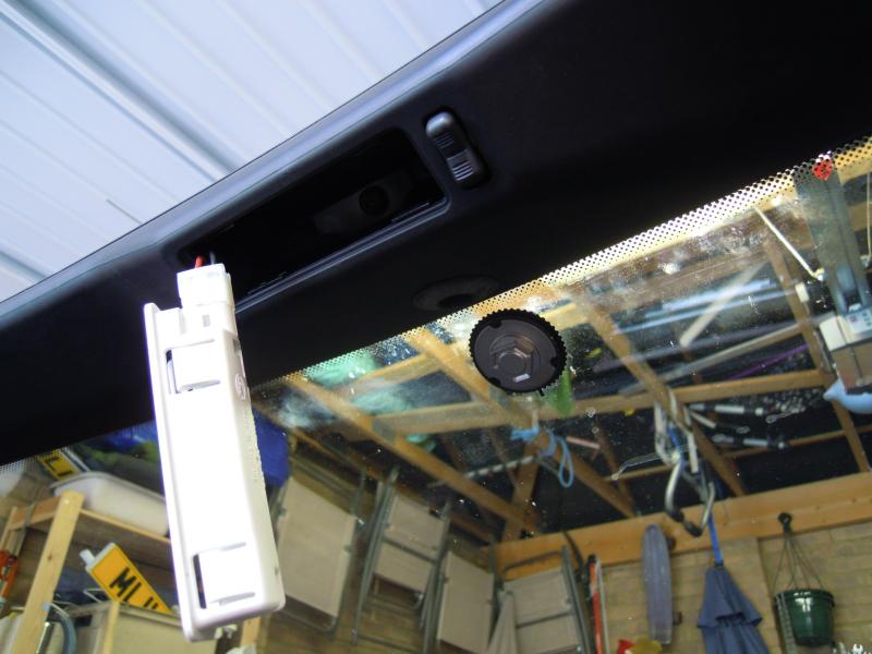

On to the massive rearview mirror, it had to go, however its pretty easy to remove then there is a huge circuit board inside of the mirror its self that is the key fob remote antenna. I searched high and low on the forums and found that it can just about be fitted in the space behind the interior light trim, having dutifully insulated the exposed circuit so no shorts will occur I mounted it behind successfully, need to remove 5 screws to get enough access behind trim.
So was then left with a big silver locating fixing on my screen, with the trusty wifes hairdryer in hand I warmed it up and gentle pulled it off, gloved it was pretty hot! then whilst the glue patch on the screen was still hot then used a stanley blade to remove the patch
Bought a new smaller chromed up, adjustable mirror and mounted to the dash, pulled the centre air vents out to get positon and access correct before drilling the holes to mount it

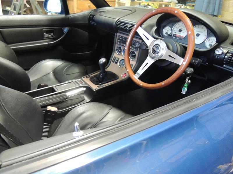

So this is how far I have got trying to make the interior look more 'older', possilby a few more minor tweaks with a little more chrome here and there but I think thats about it now and ready for the kit!!!

24 Jun 2015, 7:32am
Vents
Hi,
Your interior certainly inspires me, so thanks for posting pics, I have trawled the web looking at what can be achieved.
For the center vents I was looking at youtube last night at DIY chroming sprays and this might be an option for the them, but would need to take moving parts to pieces to spray and then reassemble afterwards. Has anyone split a vent into its moving parts I wonder, it doesn't look so obvious even when I have the assembly in hand. Also not sure of the robustness of the finish for moving parts, maybe it will flake off or deteriorate rapidly.....?
24 Jun 2015, 8:22am
I started to try and split the vents with the idea of sending them off to be 'plastic chromed' but they are all just push and clip plastic and not designed to be taken apart.
This means that if you are able to pry the plastic clips apart without them snapping the plastic will probably bend a bit and not clip together.
I think the spray can approach would work if you spent a little longer than the 30 seconds preparation I gave it. I just sprayed them with alcohol and swiped clean to get rid of the grease and then sprayed with silver.
A little light sanding, plastic undercoat, following the instructions on the rattle can would give better results. The places that there is rub/wear are inside the vents where the plastic moves up and down or side to side. This really doesn't show. The thumb dial used to open and close the vents doesn't show any wear yet.
24 Jun 2015, 8:35am
vents
hi,
I think I might have to take the plunge, thinking of buying a vent off ebay and seeing what I can do with it and that way keeping mine on car for once I have determined what to do.
Really want 3 round vents in center chromed up though, surely there is an aftermarket business case for this part to be easily replaced, maybe another cars vents will fit with a small modification!!!!! ok I am hoping alot....

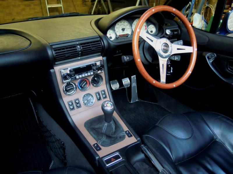

24 Jun 2015, 10:10pm
Used paintshop to see what it might look like with audi RS3 round vents (ok Im no graphical software genius)
before
After
Is it worth the significant effort?...I'm not sold, thinking that spraying the originals silver would have better effect...ummmmm
:juggle::noidea:
