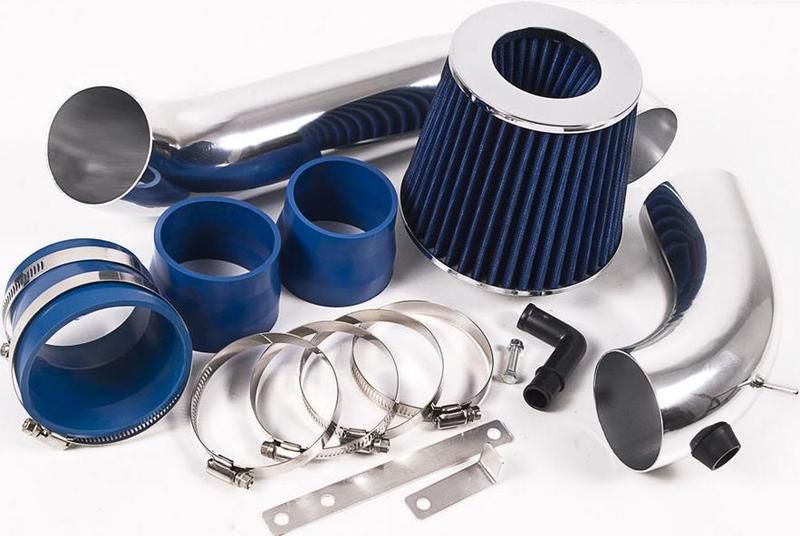

Would something like this suit?
Described as a MAZDA MX6 2.5 V6 93-97 HIGH FLOW COLD AIR RACE INDUCTION INTAKE 3" FILTER KIT currently listed under eBay item number: 350794802439 for £39.99.
14 Aug 2015, 6:29pm
That sort of dry cone filter usually sells for £12 at shows.
14 Aug 2015, 7:16pm
True. My local Motorworld has them for around that price too. And you'll still need a flowerpot/paint tin or similar to keep it all coolish.
