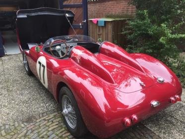

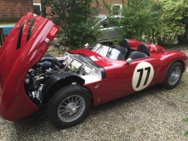

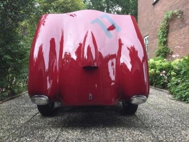

Hello Fabio,
Welcome to the forum. There's only a few Sammio 2cv builders out there, sofar maybe 2 sammio 2cv's are completed. Mine nearly is, but it was quite a struggle as many technical challenges needed to be overcome..
Anyway you can email me if you want to some help in the main stumble blocks (alternator relocation, steering lengthening frame etc..), . I hope you have a decent fabricated body, mine was pretty awful.. Also I have posted some updates earlier which might be helpful for you as well..Good luck with the built, here enclosed some latest pictures,
Best regards,
Marcel - The Netherlands
19 Oct 2015, 5:46am
Hello Marcel,
Thanks for the support offered. I will keep in mind and I am sure I will drop email when I am stuck !!! I like the look of your car especially the boot solution. For mine I have not decided yet which option to go for. I have to draw somethingand see which option I like more. Keep u posted. In the main time, yesterday I picked up my "new" wheels (coming from an Austin 8) so I can sell now the wire set I have (anyone interested????). Fabio
