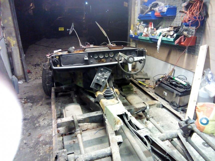

Christmas present to myself 3.1 gte race cam fitted re-board 17k on the clock with all the mots to back up the mileage .seems a shame to give it the chop but it will make a nice 32 ford pick up rod when its finished

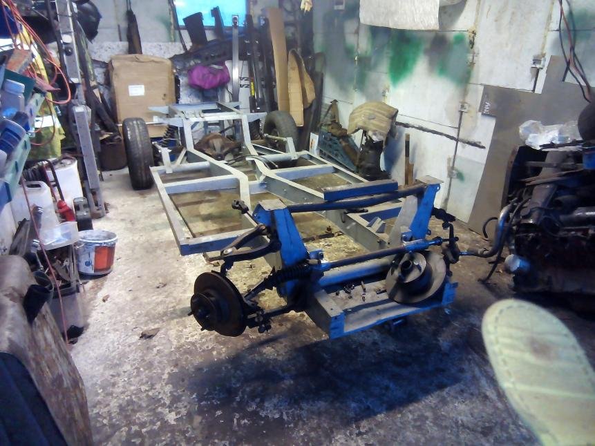

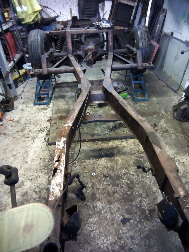

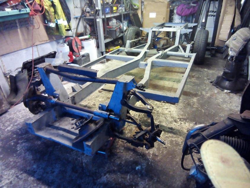

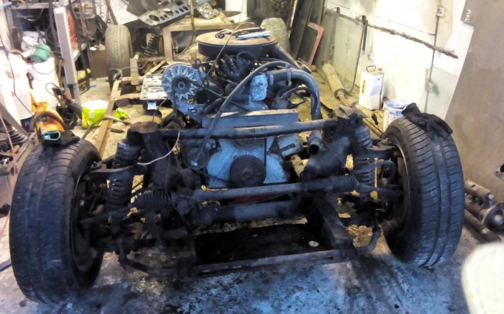

engine hoist on order if not a bit late the chases is now well striped jet washed and mostly degreased going to start welding tomoz and get it repainted then rebuild the brakes by that time my kit should not be far away
last week
this week
outriggers need replacing to suit the kit
think the exhaust had a slight blow
time for a big glass of wine
Err....hate to be a killjoy....but lopping off the outriggers and making new ones to taper to the car, means the chassis has been altered, which means....IVA....
Just sayin'....
Just sayin'....
ho bugger never thought of that heres me enjoying myself lol

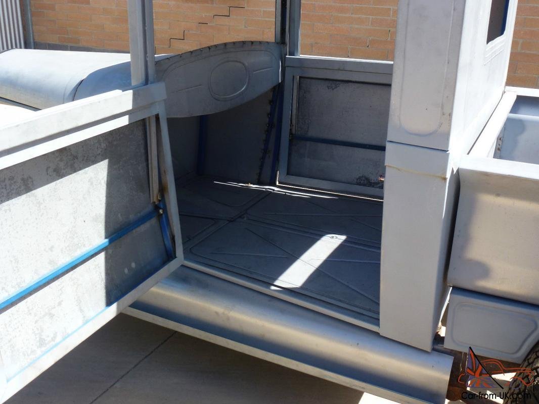

Could standard outriggers be hidden with running boards...maybe...?!
Sorry to put a damper on it, but hate to see you build it then have problems getting it legally on the road...
PS, hope you do build it, i love hot rods..

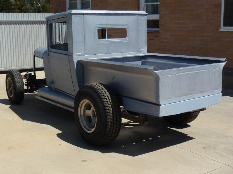

ye wish it was mine unfortunately its just to show how I plan to cover the outriggers. the kit I have got on order from chris is pretty much the same and will look the same. old school all the way no mud guards and fancy a dab of rust effect paint. doing a full rebuild on the chassis running gear so it will be all new ready to run shame about the budget lol

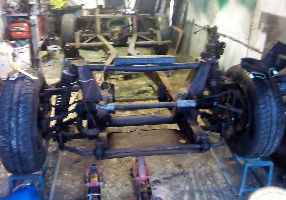

hoping most of my parts will be here this weekend to start the chassis suspension rebuild got just about everything but the shockers 500quid is the best I can find bummer. just spent 500 on the wheels been an expensive week ho well be worth it when its finished, and look mean
you ever had one of them days when everything you touch goes wrong well that was today. chassis fully repaired now all new brakes and poly bushed just waiting on the front disc and track rods.
