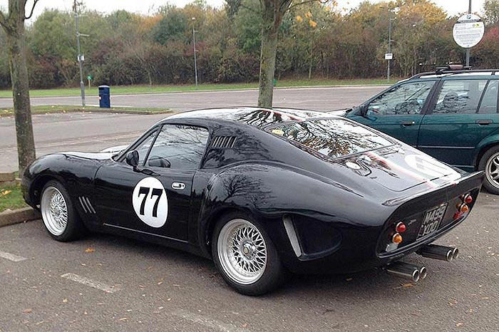

Colour, light and wheel choice are almost settled. I'm thinking rear lights from a Opel GT. Something like this with trim rings;
In regards to wheels, I absolutely love the bbs rs reps on this car, such as what Dave Lowes put on his. I actually need to ask him what sizes he bought!
