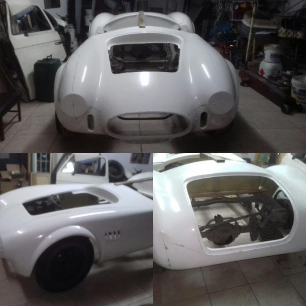

Hi everyone. Im new to this scene of cars especially fibre glass. Have an Ac Cobra body that wish to fit on a Tata Sierra chassis but dont know what steps i should make to make things right.
It has no floor and what i only know is that it needs a skeleton inside to keep body in place and fixed to chassis. Any help will do.

Wow paul. This is a very good reply. I want to make a rebody but eventually it will end up with an SVA test.
What i am thinking is to do a safe cockpit bolted to the chassis and bonding the bidy to it. Still have to discuss with my engineer regard what really has to be done.
