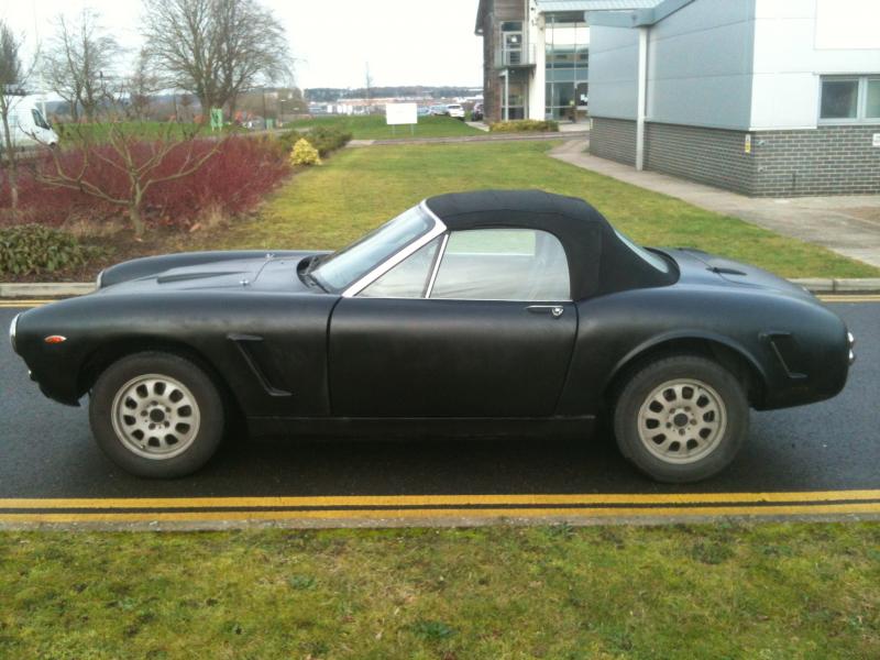

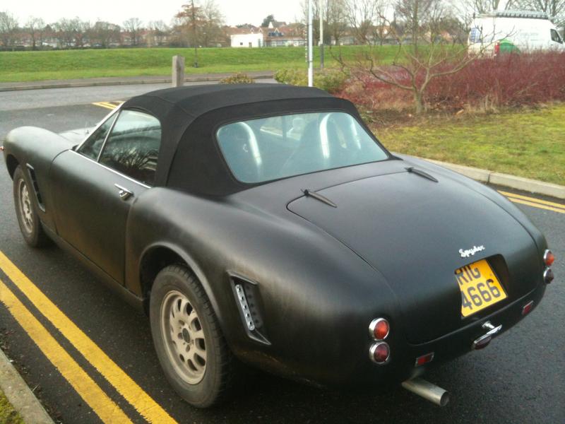

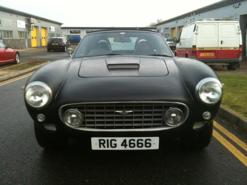

Recently I was able to buy a Tribute 250 direct from Chris ( and Dan ).
So, this isn't a build thread as the credit for that lays with them ......its more of an evolution.

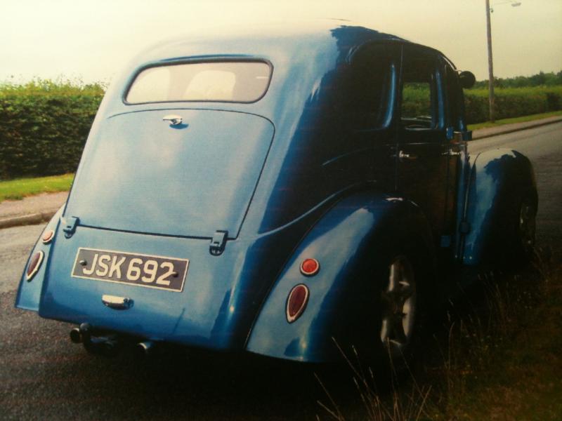

Anyway, I'm Graham, and I have been lucky enough to own a few "interesting" ( to me anyway) cars....
3 Jan 2017, 11:46am

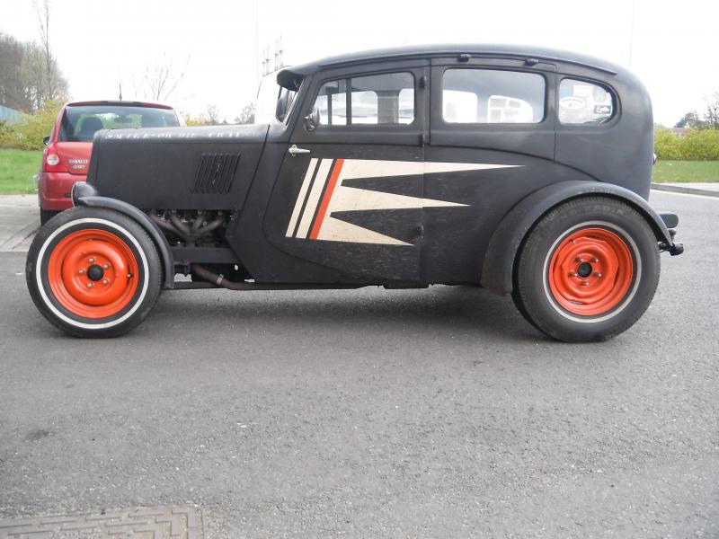

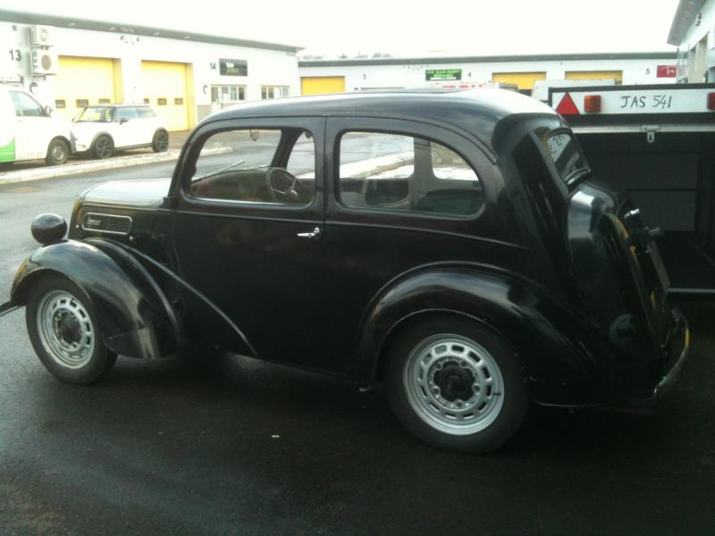

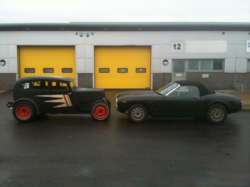

I still own this Morris 8 hot rod with Rover V8 power

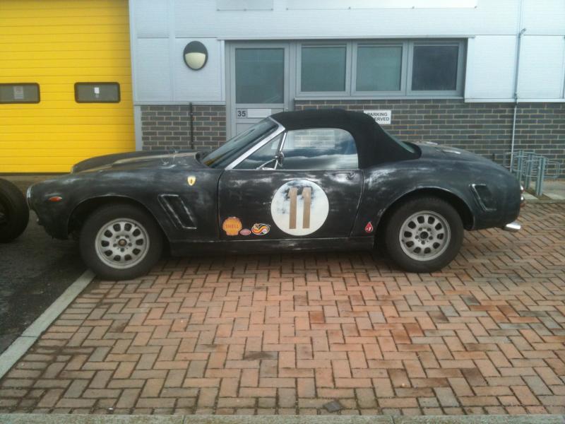

I live in Norwich and Bob is a good friend, so I'm 'blaming' him for letting me drive his 250 Coupe.
This is the informal inaugural meeting of the Norwich Tribute 250 owners club!

Hi Graham, glad to see you've made it onto here.
It's a great car and one you are adding your own handmade touches to. Hopefully you'll show more detail on some, such as the side vents and badge I saw on Sunday.

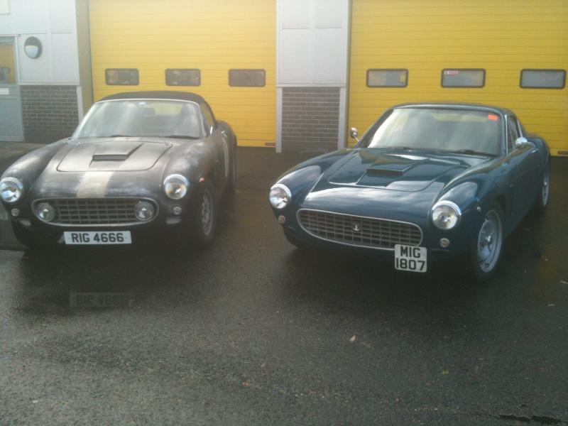

Especially the pics with the coupe and the convertible together.

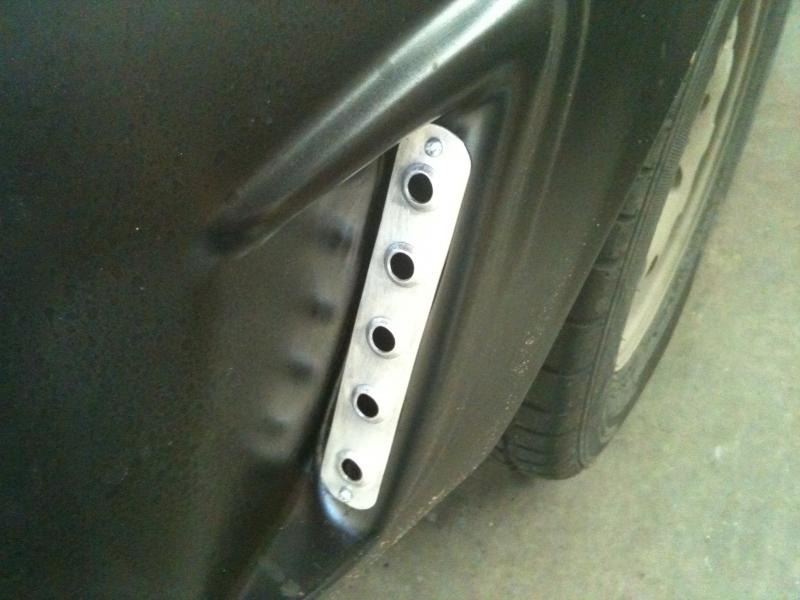

Rear vent detail, piece of alloy and a 3/8ths dimple die.

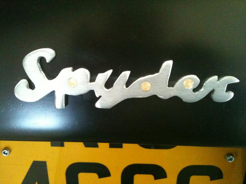

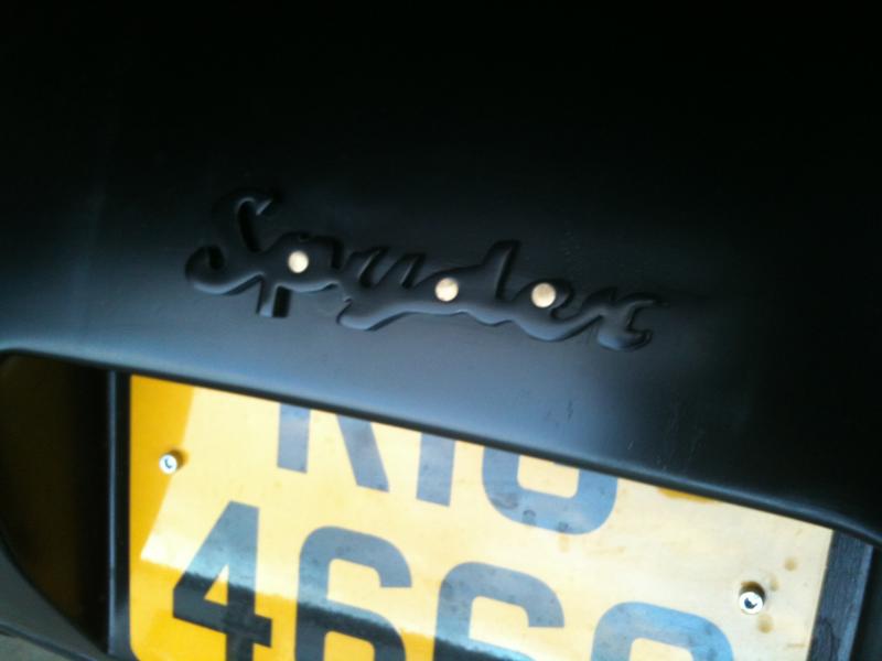

Spyder badges dont seem very easy to find!
So, a piece of alloy, jigsaw, cutting disc and chain drilling.....more filing / sanding needed but I like it.
5 Jan 2017, 2:42pm
Spyder badge is getting there................

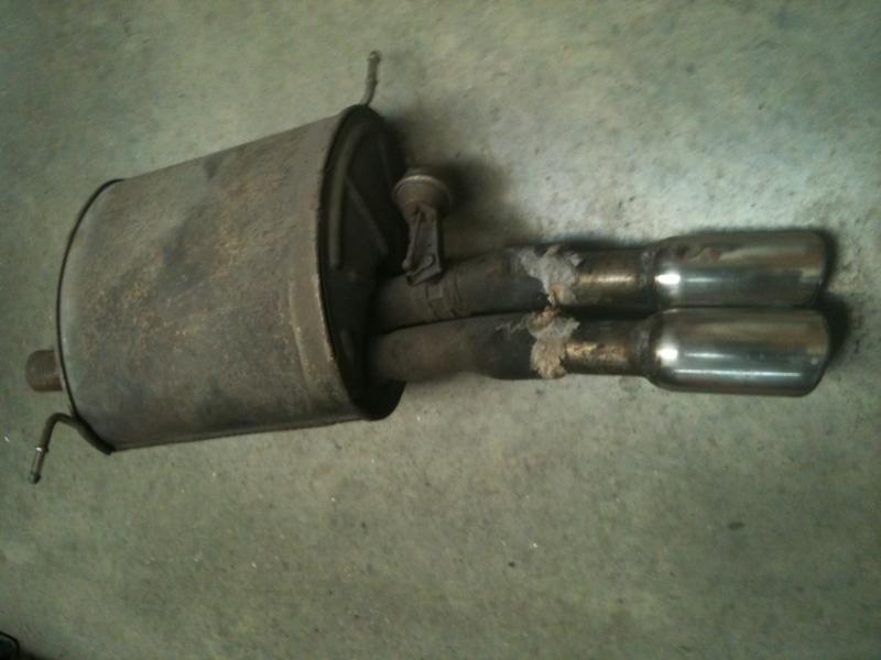

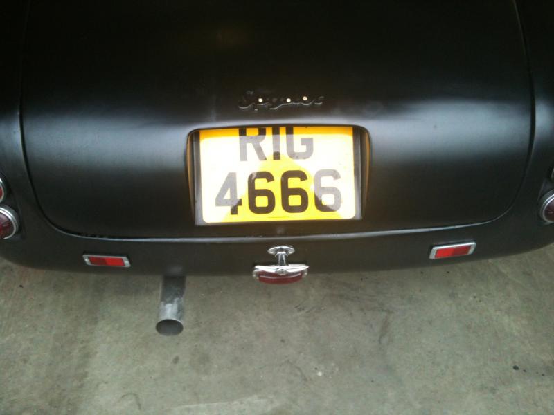

Well , that's over 13KG removed. Those 2.8 back boxes and extension pipes are bloomin heavy.
Flexi joint, length of 60mm pipe and a very small can later....
I now like the exhaust outlet angle rather more and I can now tell I haven't stalled the car on tick-over. Not too loud or droning on a run either. And c9KG weight saved. Result.

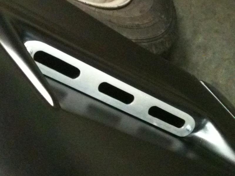

Front wing vent covers....

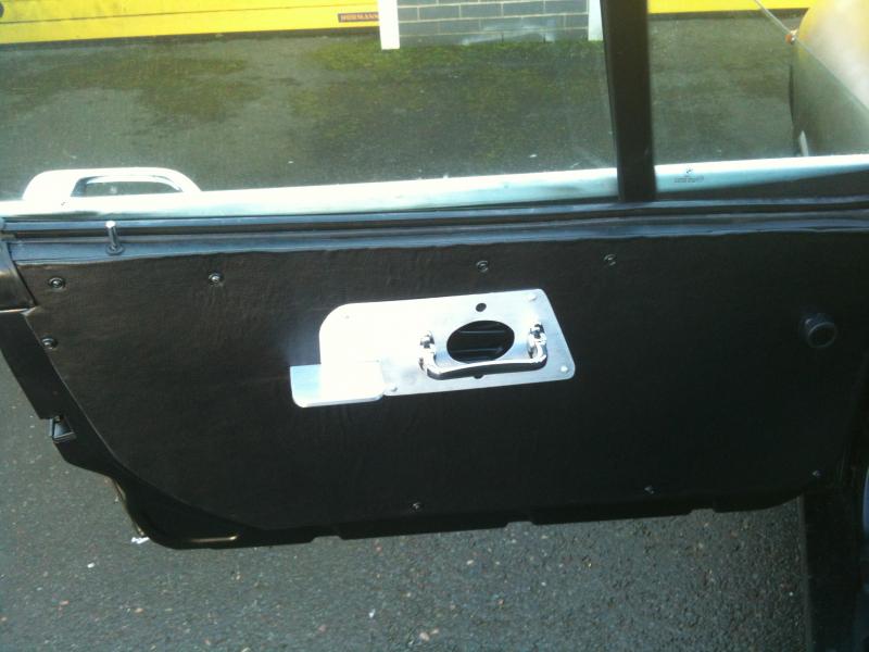

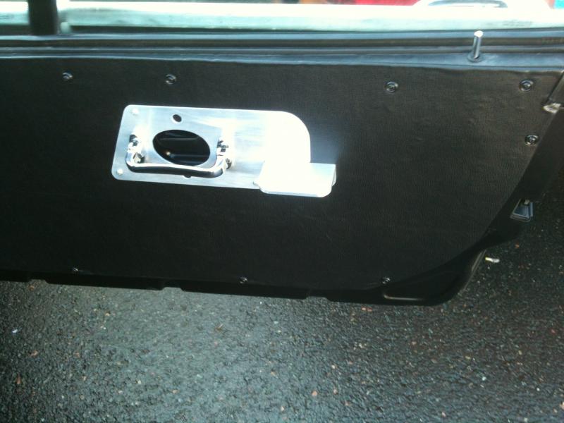

15 Feb 2017, 1:17pm
New door cards, door pulls and arm rest / trim fitted.

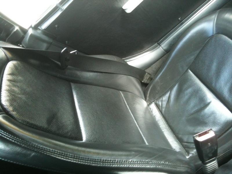

27 Mar 2017, 1:54pm

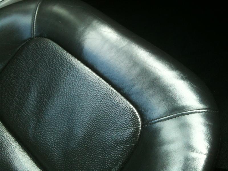

The BMW medium blue seats were not really working with the look I am aiming for, so I bought a leather re-dying kit on line from thescratchdoctor.
Seats out, leather surfaces cleaned with leather prep and alcohol from the kit. Bit of light sanding. 3 coats of black pigment with a sponge, then 2 of satin leather finish sponged on. Few days drying, then back in car.
200 miles done since.
I'm really pleased....they have come our far better than I had hoped for. Has retained some of the aging / crinkles / wear lines but everything including the stitching is now black.
